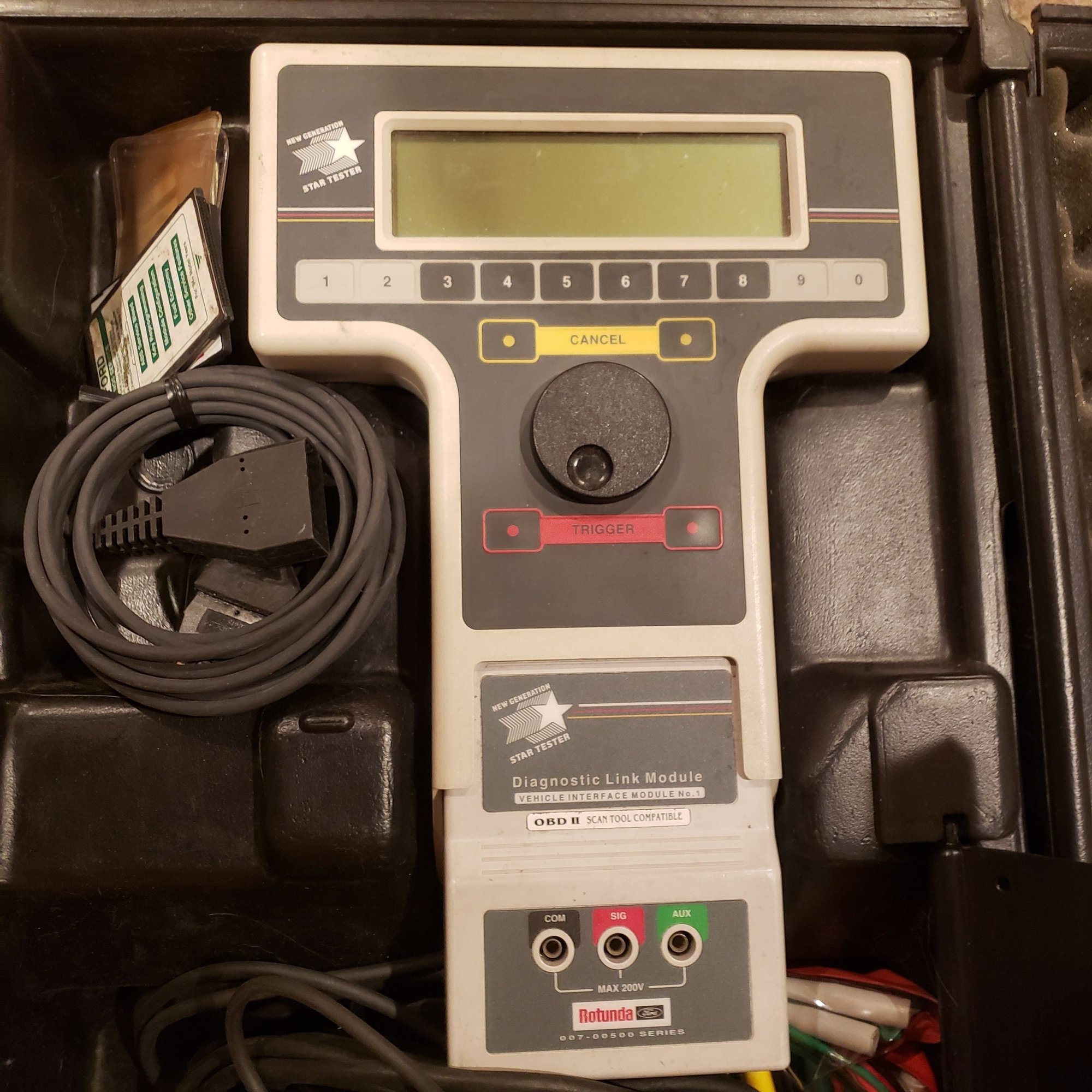

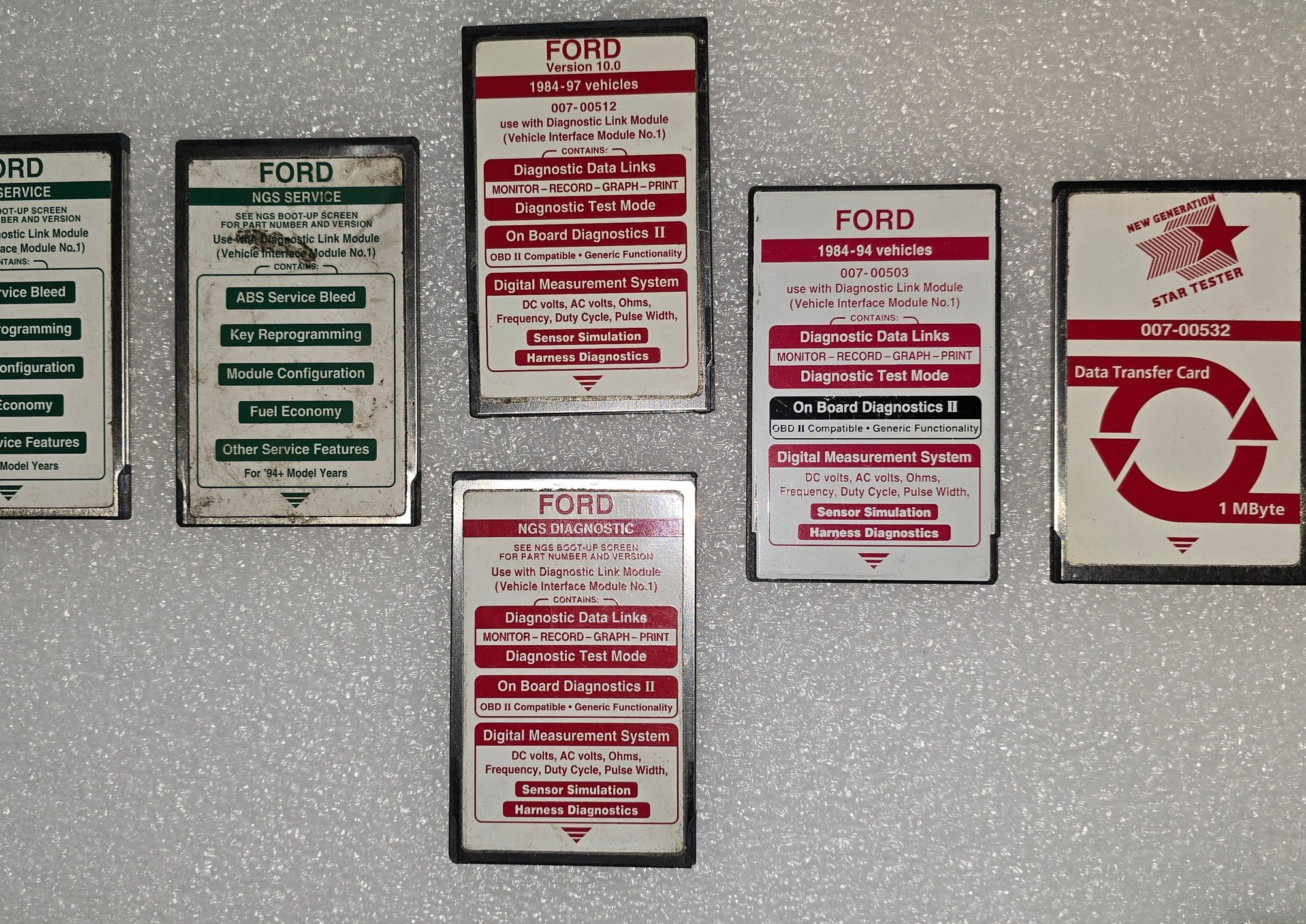

Sometimes a service bleed procedure for the ABS HCU is needed
Most of the time it's just the rears being out of adjustment
Good job is school
This is what you need to do a service bleed \
Some other expensive bi directional scan tools may do it too, like a Snap-On
