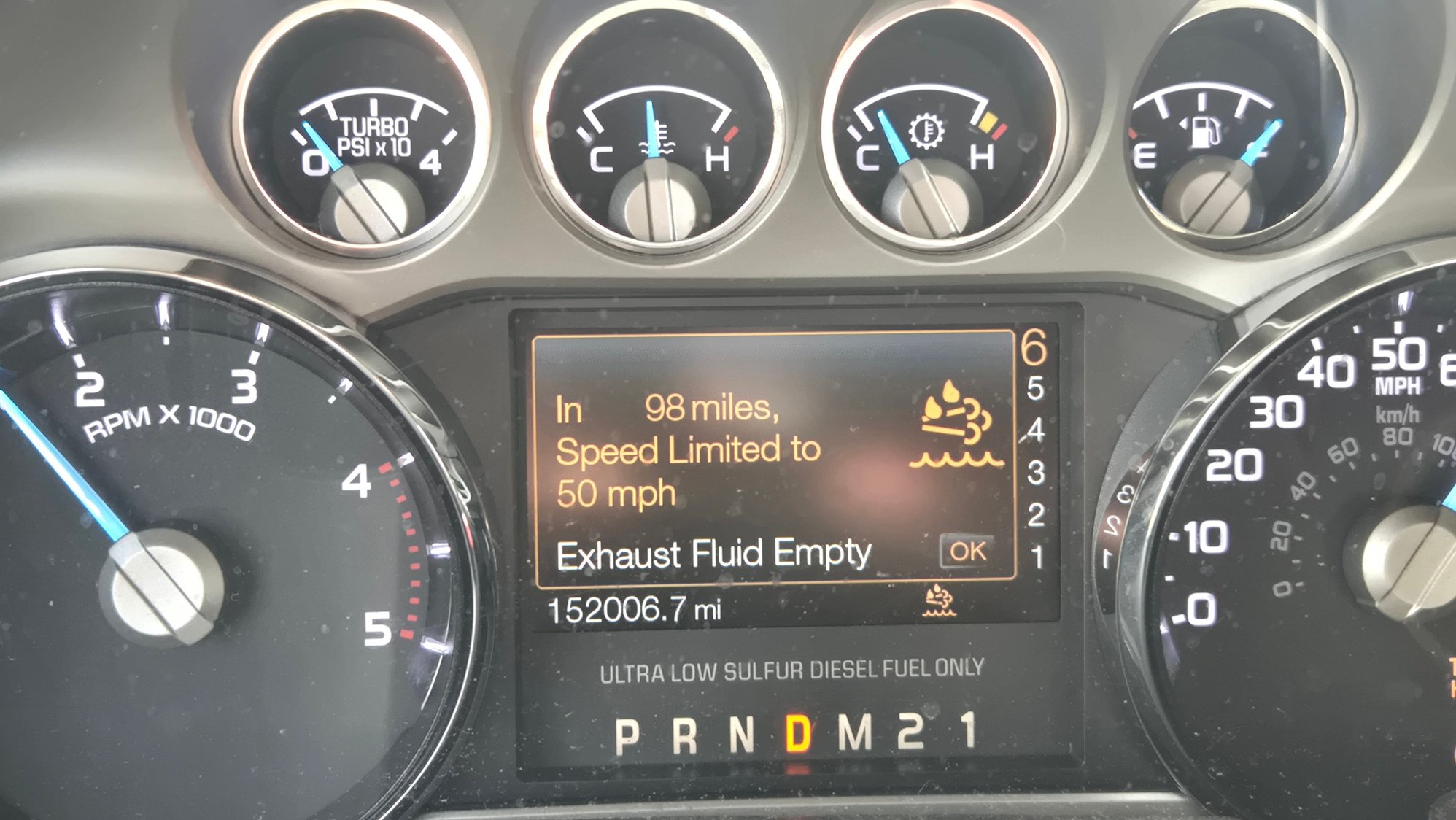

Recently had got the 500 mile warning myself and let it go for awhile. When got down to 99 miles, which obviously is an estimate by the PCM, this popped up.
Never saw this because I never let it get this low before. Then the message popped up for every 4 mile reduction.
Put in about 3 gallons, all I had left at home, started the truck, the warning and the DEF "chicklet" symbol was gone.
