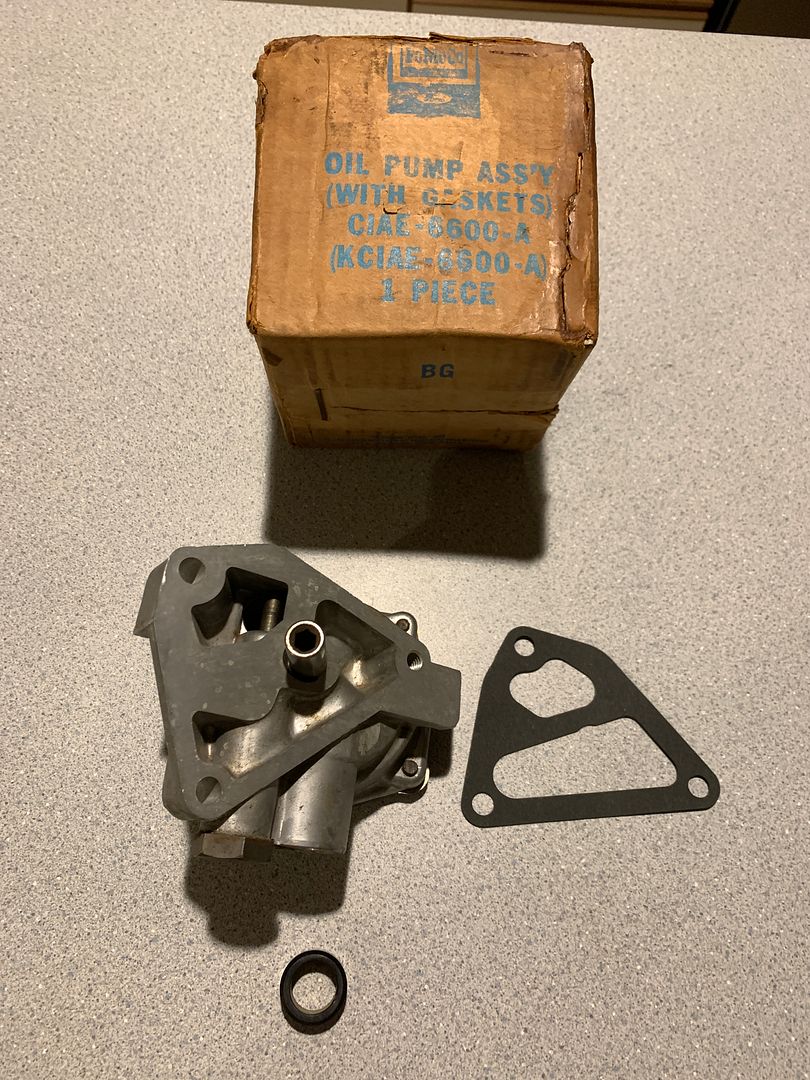

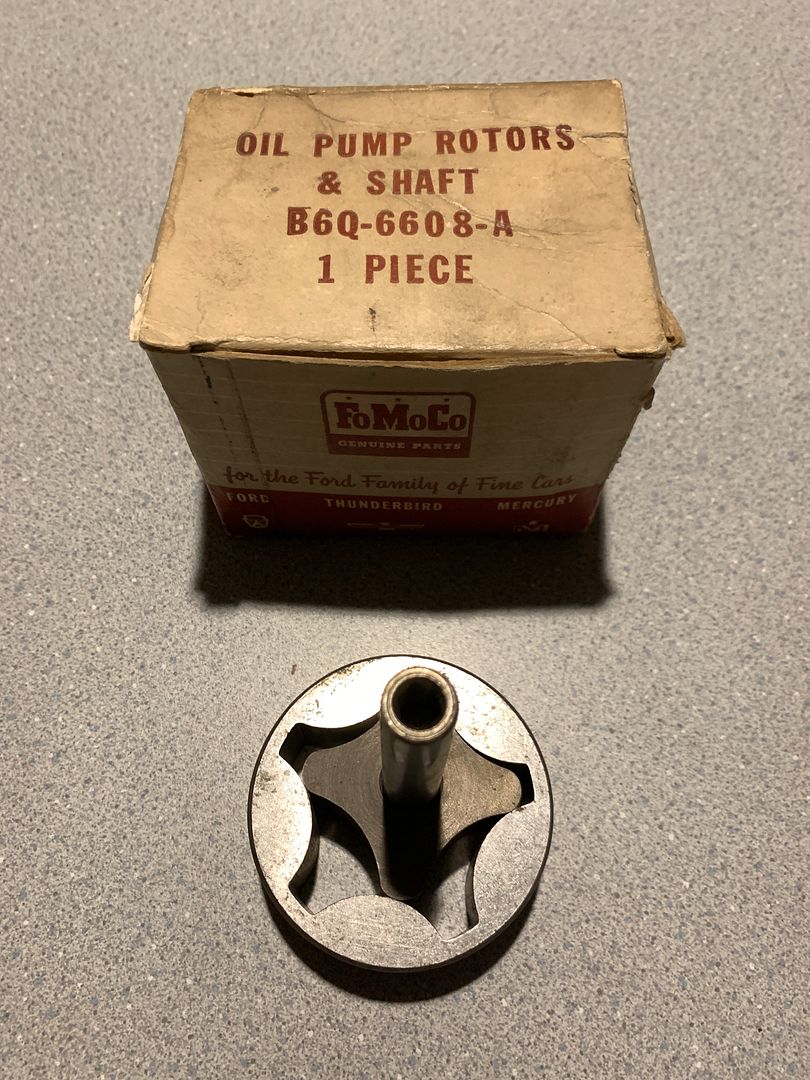

Old Apr 25, 2026 | 03:08 PM
  #38
TA455HO's Avatar
TA455HO
Lead Gopher
Joined: Aug 2012
Posts: 10,066
Likes: 1,622
From: Seattle
Like this.
B6Q-6608-A - ROTOR and SHAFT ASSY. - OIL PUMP DRIVE
C1AE-6600-A - PUMP ASSY. - ENGINE OIL
Old Apr 25, 2026 | 03:15 PM
  #39
skidoorulz's Avatar
skidoorulz
Joined: Jan 2014
Posts: 1,558
Likes: 295
From: Billings Montana
Originally Posted by TA455HO
Like this.
Leave it to you to have one or ten. The weird thing is when I googled that part number on the pump box which is the same as my pump has on it, it came up as a pump for a 352. Got the Melling pump kit today and it came with a new spring, cover oring, gasket for bypass nut, gasket to block and rubber for pickup tube. All for only 56 dollars. Going to install it tomorrow.
