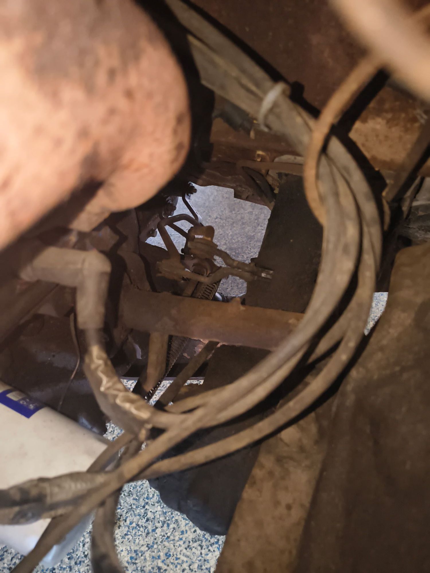

BigWin, Yes I need the passenger manifold with the crossover tube attachment. You have one I’ll buy it. Any damage? Can you post a pic?
I would like to get rid of the crossover and go with Ram Horns but can’t see a way around the trans linkage for the exhaust piping. Also, I read somewhere that the steering column is dead in the way. Suggestions, hints?
My F100 is 3-on-a-tree and linkage is on driver side of transmission. Looks like no way to get an exhaust pipe through, but it’s been done? Would love some pics. If so, I would not need the crossover manifold and would opt for Ram Horns.

Not the best pic, truck is at diff location and will provide better when I get to it. As you can see, linkage is hogging all the space.
My guess is that I would have to swap trans to a straight stick out the top, but would hate to do that.

I have ramhorns on my 64 F100. Mine has a 4 speed but the down pipe off the ramhorn drops down far enough it will not give you any issues with your linkage
