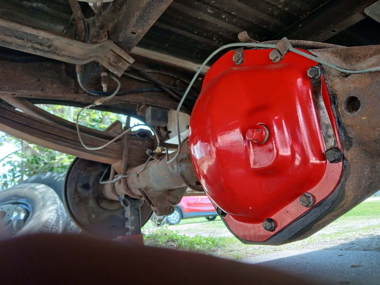

Here's a photo of my differential cover after I cleaned it up and painted it. I could have painted it black, but that lacks style. I believe in Benjamin Franklins advice to "Fart Proudly". In short, if you have to do it, do it right!
Note also, a previous mechanic replaced the rubber flex hose with a steel one hanging loose. This will be corrected before I put the truck in service.
