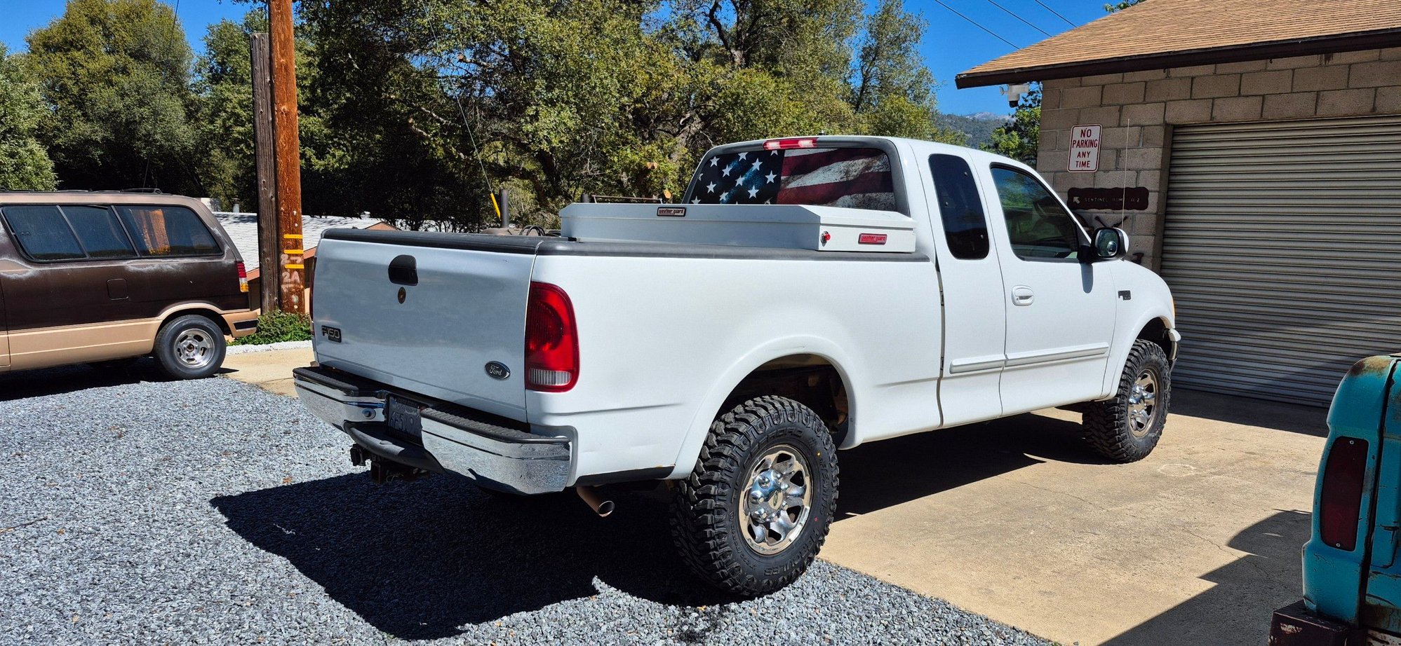

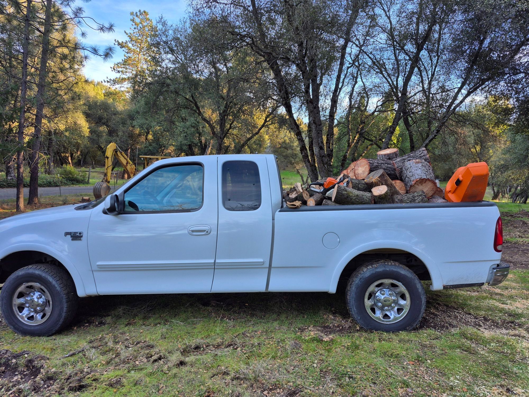

Pick the tread pattern you like and go for it, maybe look for a nice AT, I have the Toyo AT3's on 3 of my other rigs and love them for all around everything, on my 2000 Scab F150/4x/7700 had 245/75/16 stock size on it, I use mine for an extra wood-cutter/hauler/wheeler/run-around truck, I wanted a more aggressive tire so I went with the Hercules TIS Mud Terrains in 265/75/16, Love them! They change the whole look/disposition of the truck.
Yes, I would go more towards a 265/75/17 in your case, you don't have to go with factory spec'd sizes, and size you load it like I do, I'd go for a Load Range E tire/size.
Before with 245's, after with 265's
