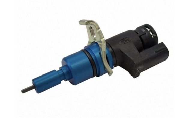

The o-ring is in the VSS sensor:
If it is not there you could try sourcing just that o-ring by trial and error. No idea if there is a spec. for it.
Perfect!! Thank you as always!! I did not see that in there when I looked, but may have missed it. I have an assortment box of o rings I’ll try out. Can’t be worse than it is currently. If I can’t get it to stop, I’ll just replace the VSS.

That is the cable O-ring shown in the photo (it's there to prevent dirt from getting into the VSS from the cable side)
There is a second one inside the VSS on the other side, keeping fluid from getting past the gear, that's the one you need to replace

This is why I don’t listen the majority of the time. The o-ring in my picture seals the sensor to the trans/ transfer case housing. The o-ring in rla’s picture seals the sensor to the cable.How do you replace the o-ring manic mentioned that is supposedly inside the sensor housing?

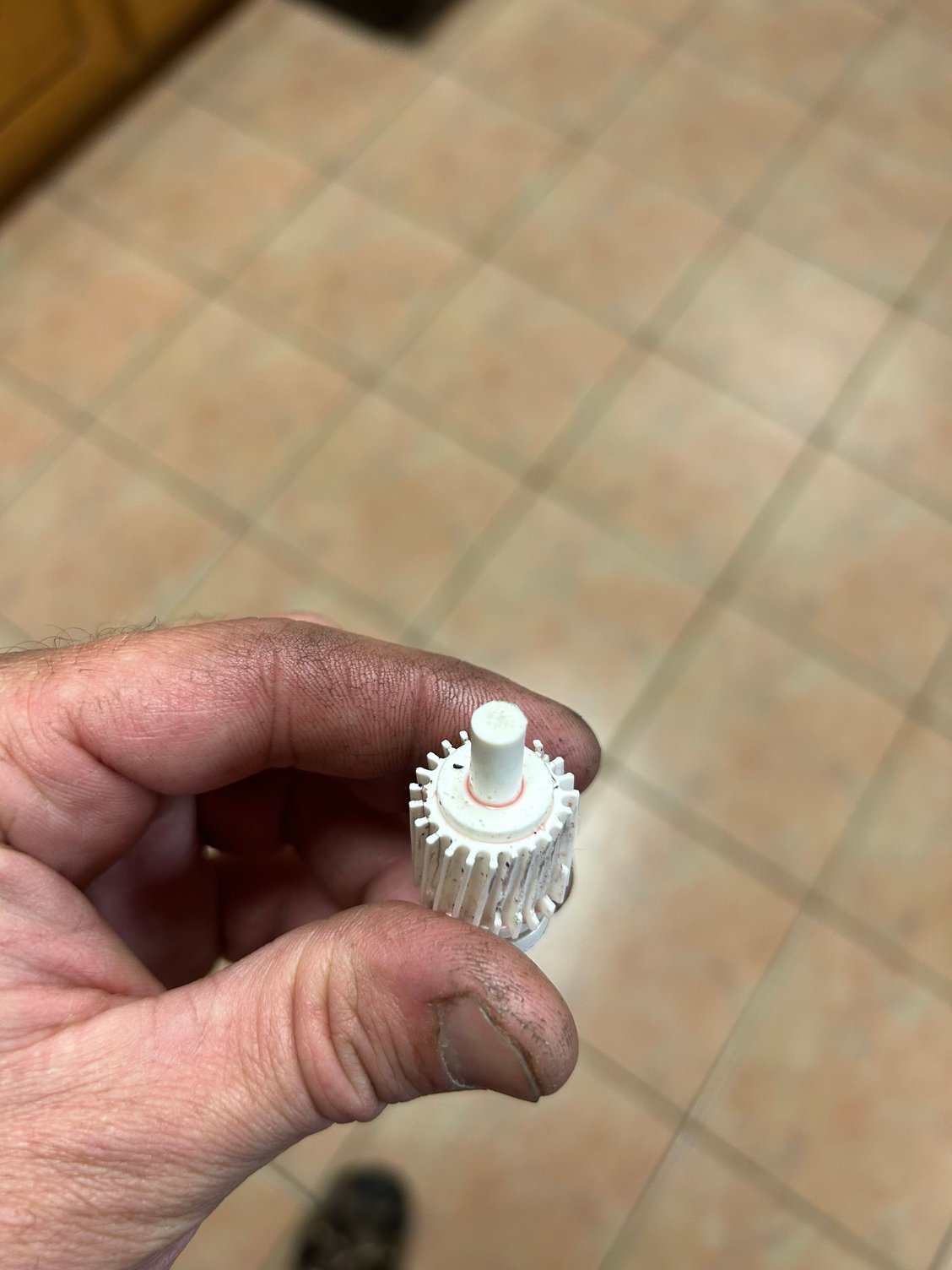

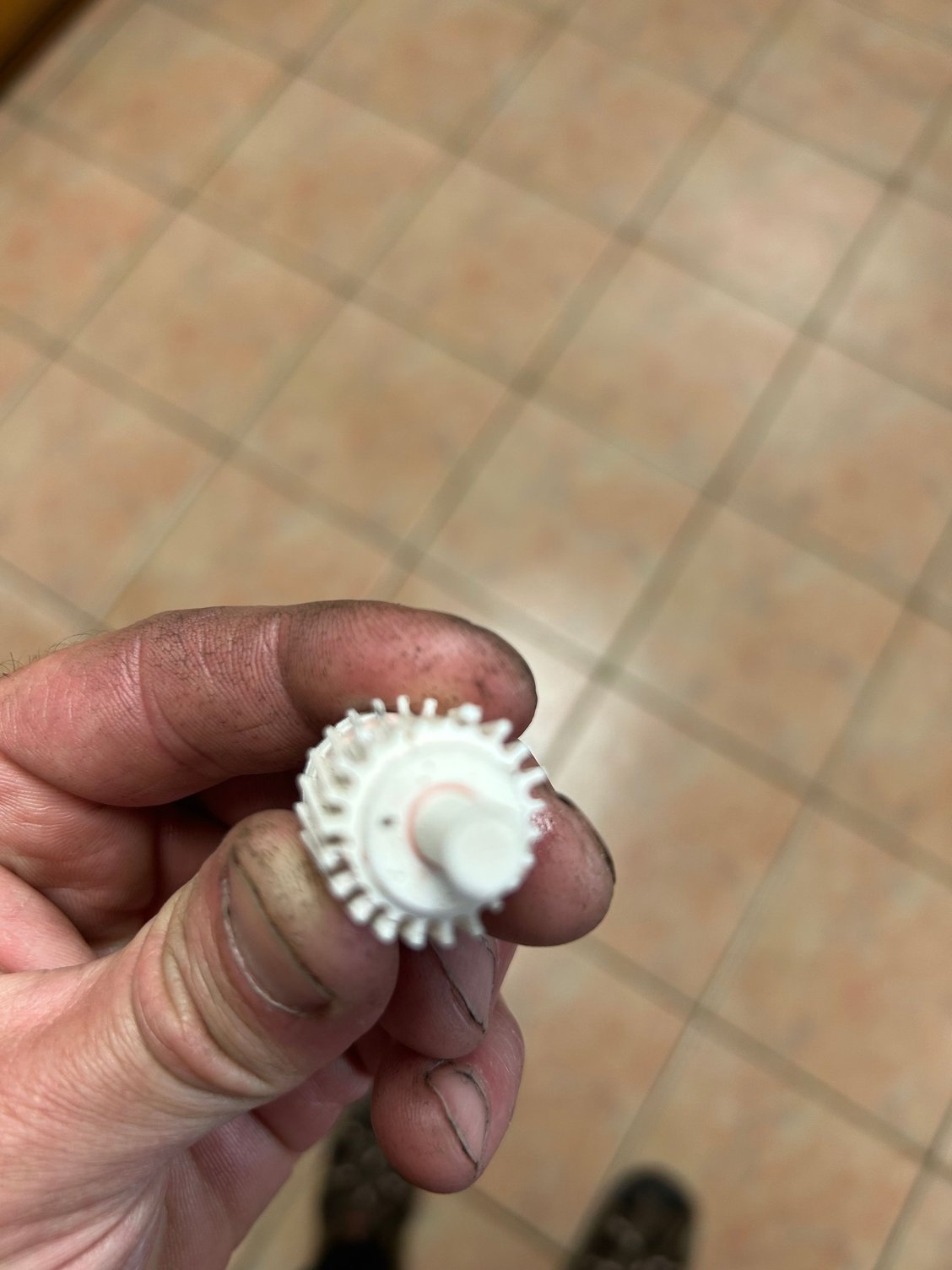

attached photos are of the driven gear that was on the VSS. Clearly shot to hell! The missing teeth are somewhere in the transmission.. being that there is no pan or filter, are those tiny pieces of plastic worth draining the trans, pulling the top cover and flushing it out or would the group agree that the tiny plastics would disintegrate and not cause harm? Who knows when they broke. I can tell you the gear is around 6 months old. The fluid has only 5k miles…

No. The tiny pieces of plastic are probably already ground up. If the gear looks like that after 6 months, is it the wrong gear for the drive gear?
