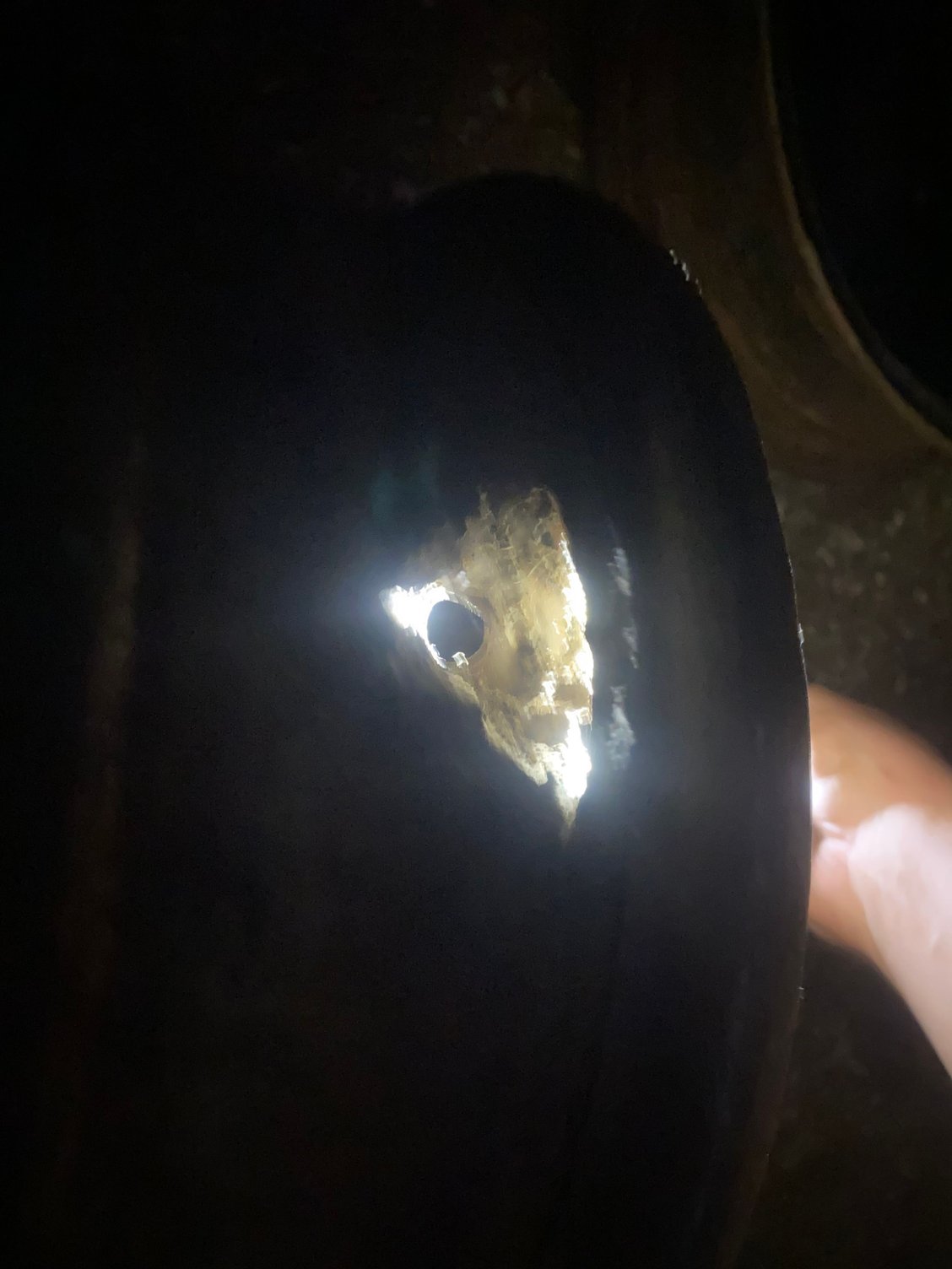

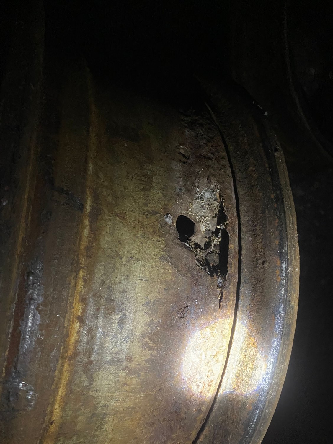

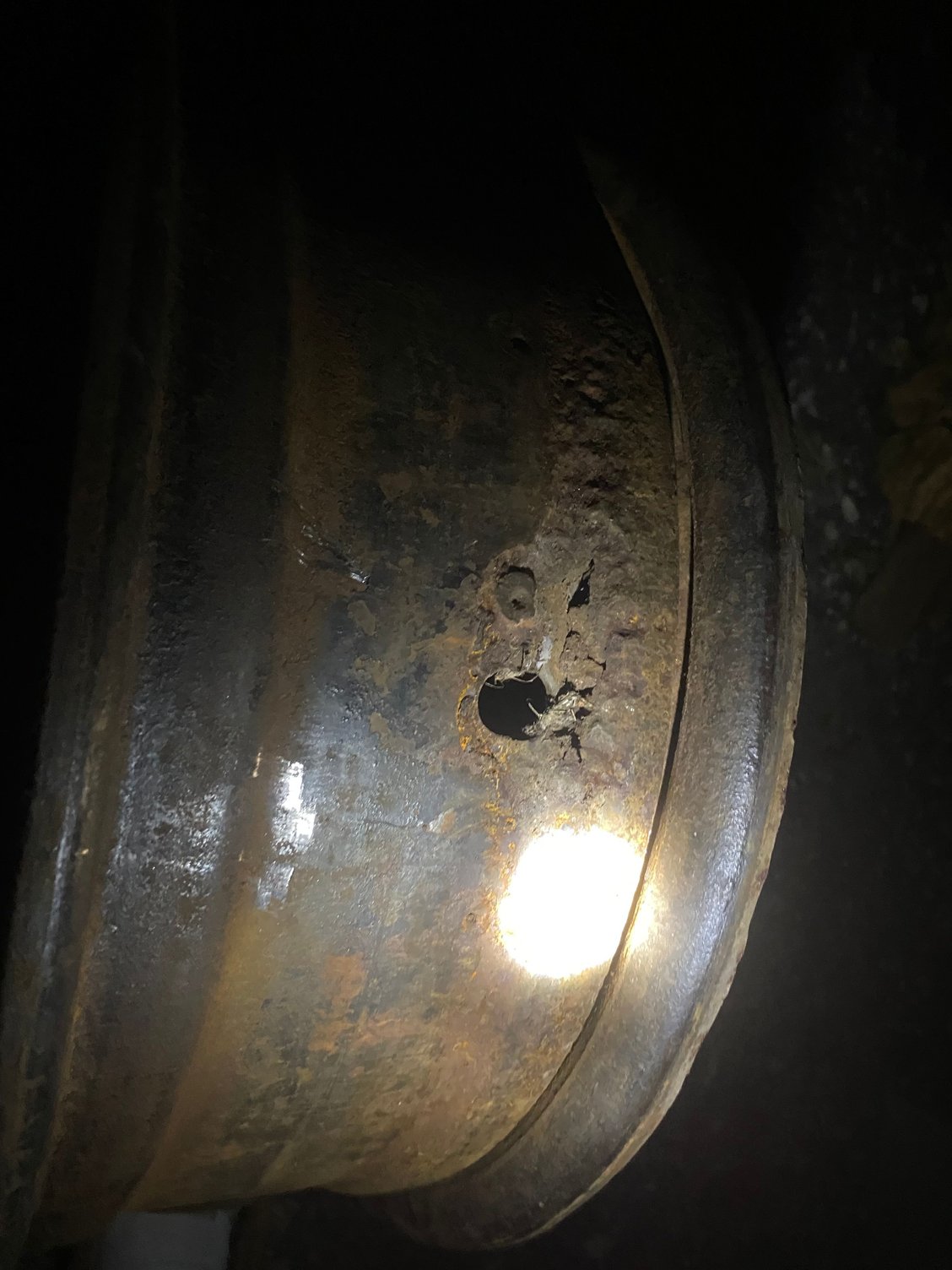

Well, I removed two more wheels to break them down and get them ready for paint and found the worst. RUST! Both of the rims I took off have holes rusted straight through, both around the valve stem. I’m assuming this probably can’t be fixed? Even if it was fixable, would balancing be an issue? Also, when I mount the other two wheels that are in good shape should I balance them? They weren’t balanced before and I doubt my truck will make it much past 55 with the 5:28 rear gears in it.
Pics of the carnage:

YIKES! Well thats a shame. Are they inne wheels? I think I would be off to a junk yard for a whole new set of non splits

They can be fixed, but probably not worth it.
They can be fixed, but probably not worth it. If you have to pay someone to do the work, it will be more than the cost of a new wheel most likely.
If you’re a good welder, you can fix it. I’ve done two 9N Ford tractor wheels that were rusted out worse than that (palm of your hand sizes holes at the stem). Of course, a tractor is much slower than a truck…
This rust is common on tube type wheels. Since it’s a lock ring wheel, it runs a flap to protect the tube. The flap will actually accommodate a pretty good bit of rust pitting, and the valve stem hole can be rusted oversized and still run ok.
So, yes they can be fixed. Is it worth the cost if you can’t do it yourself? Up to you.
https://youtu.be/to_VnGl8e_A?si=wNVw8MmtUbGp3mzL
this is a decent repair video.
