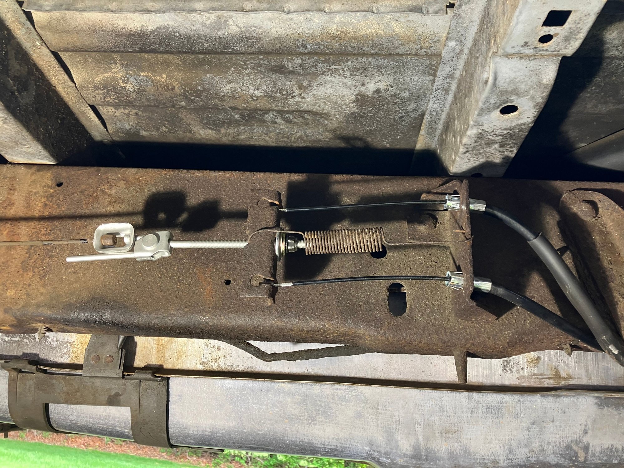

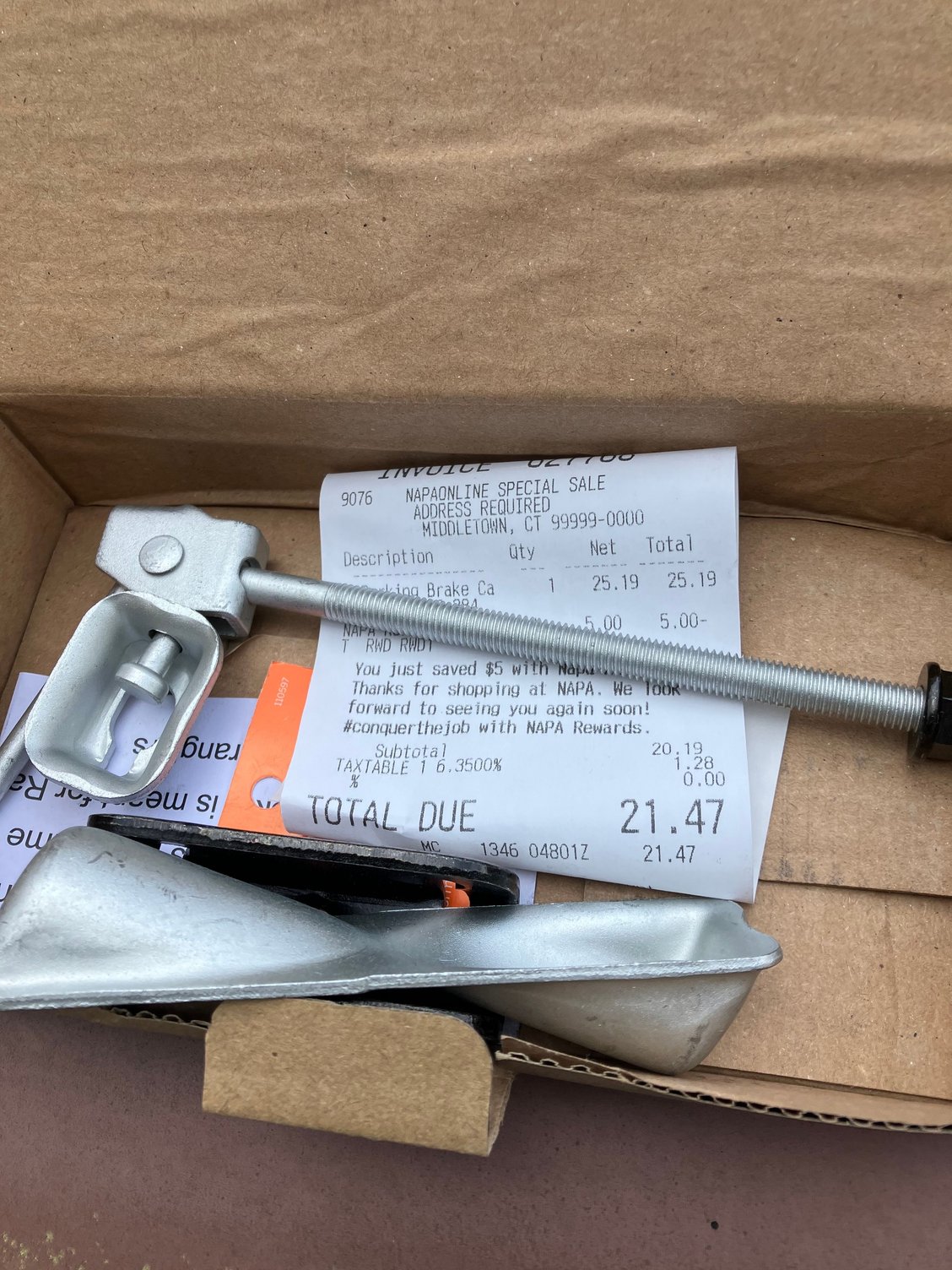

Last Fall I finally got around to replacing the rusty/frozen parking brake rear cables on my 86 F150 302EFI. Easy job with parts from NAPA.
Keep it OEM style and stay happy.
Is there something wrong with your rear brakes that is causing you to want to make a expensive change ?

I'll say, after not using the parking brake for like 30 years, I was surprise to find the front long cable was fine. Only the rear 2 were frozen.
ill have to check mine
