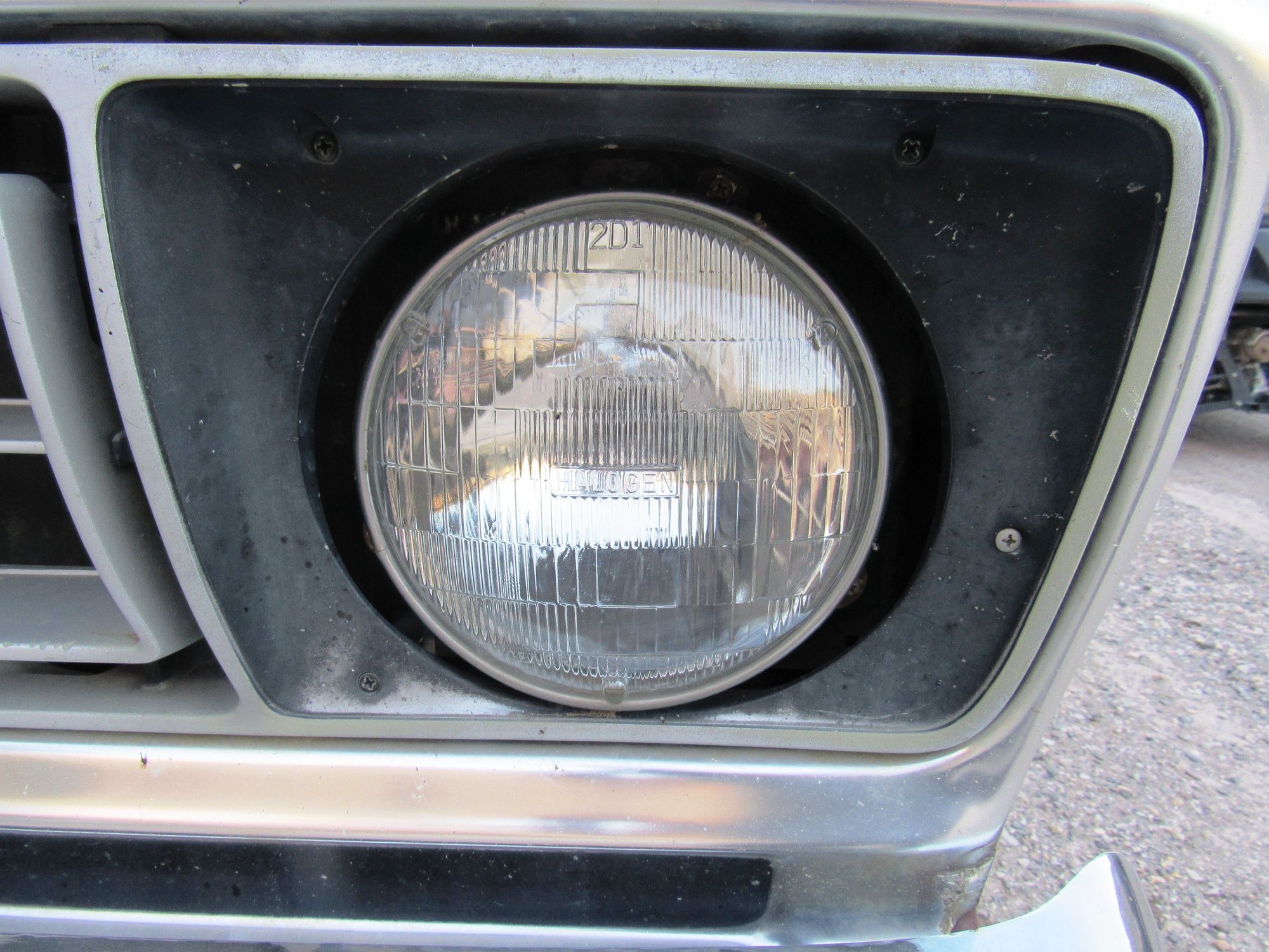

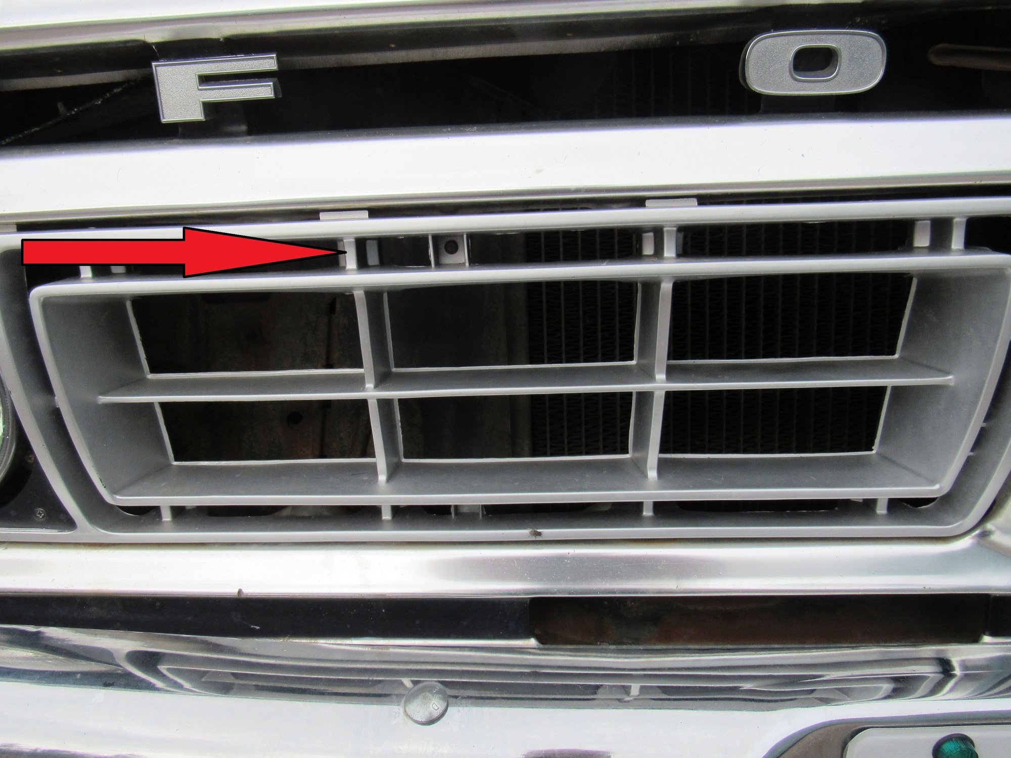

The passenger side was replaced from Dennis Carpenter.
I would like to paint the black around the headlight on the driver's side.

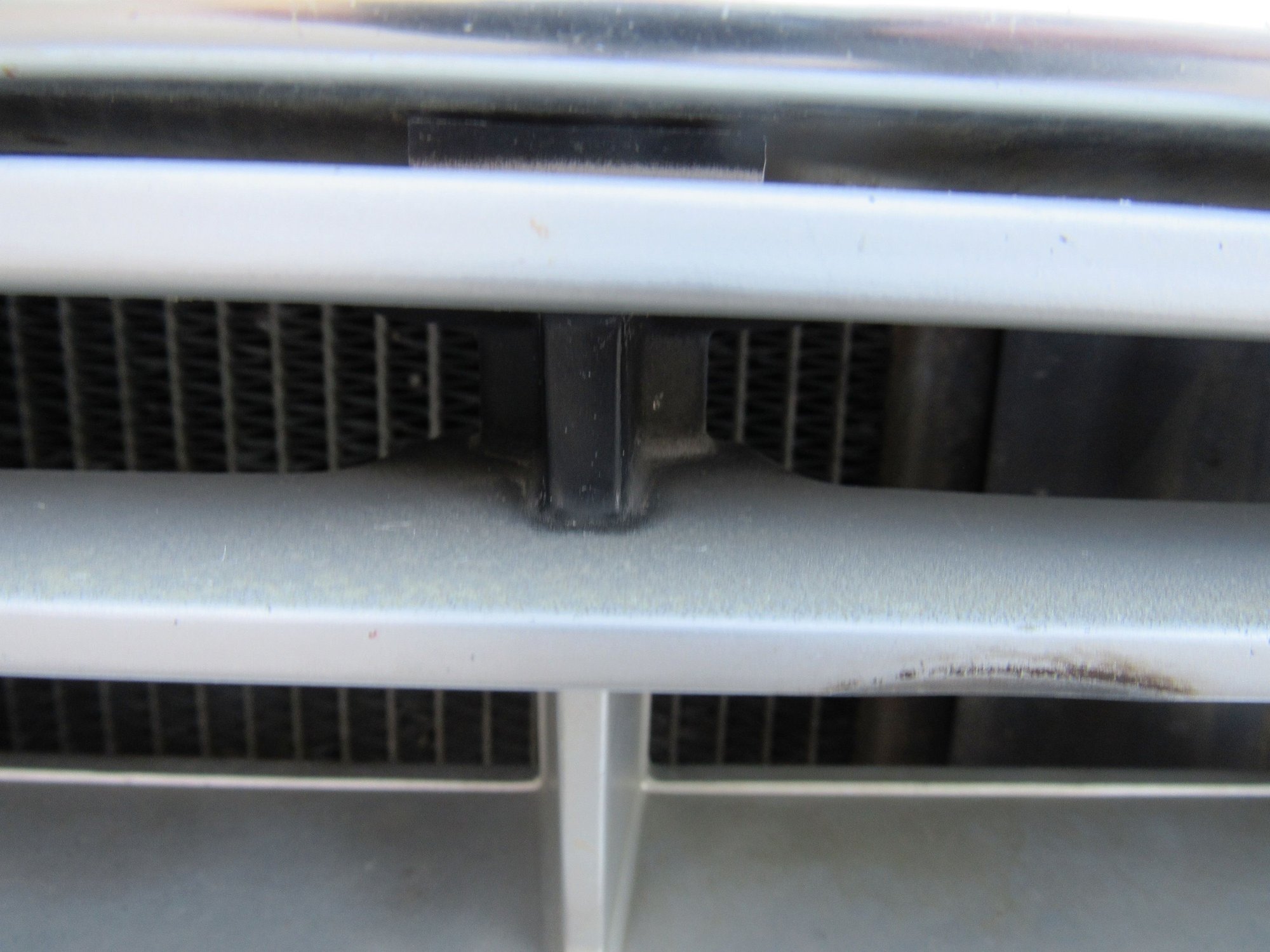

And I'd like to paint these black to match the original grilles.
Flat black???

I used SEM Trim Black. the standard satin not the gloss.

Krylon Fusion in Matte Black is another great option. I'd take both off and into the shop to clean and tape and paint, and the Fusion dries fast. Nothing wrong with the SEM, but I can go buy the Fusion off the rack today, I have had to order the SEM.

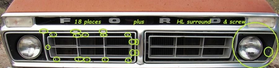

Looks like eighteen places on the pass side plus the driver side head light surround ..... and that one screw head .....because if you miss a spot, it'll jump out at you every time you walk by it. Of course, your eye will next be drawn to the Matte Aluminum color, the freshness on the right one next to the wear on the left one. I think the difference would be OK, but not sure how picky you are. If you did one good chance it wouldn't match the newer one and then you'll be wishing you did both.
Times like this, I ask myself sometimes "How will it look to that guy coming the other way, both of us running 45 or 55 ..... or 80 mph"?
I know .... it's that old "Rat Hole" again.
It'll be easy in a warm shop working at a table.

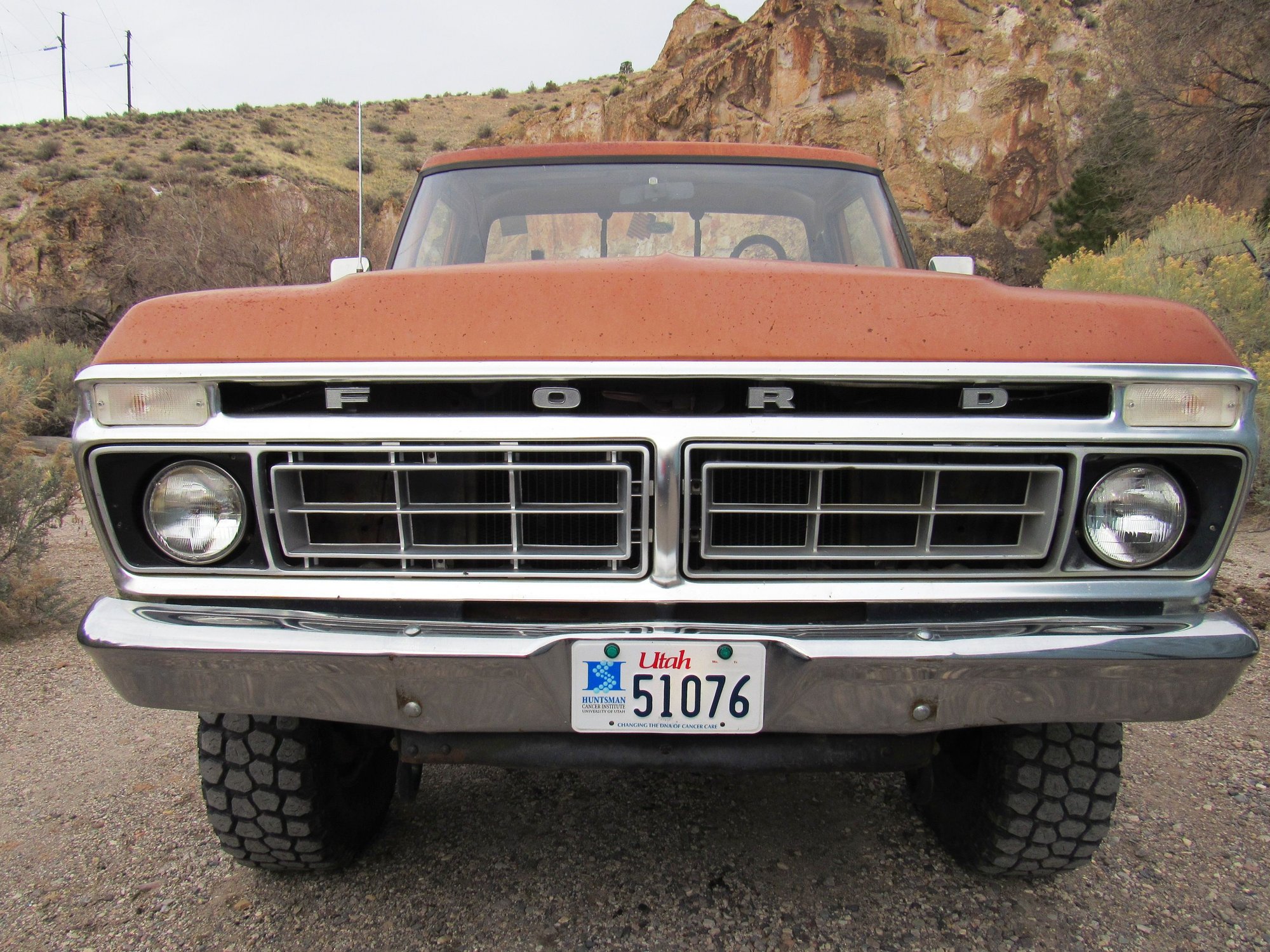

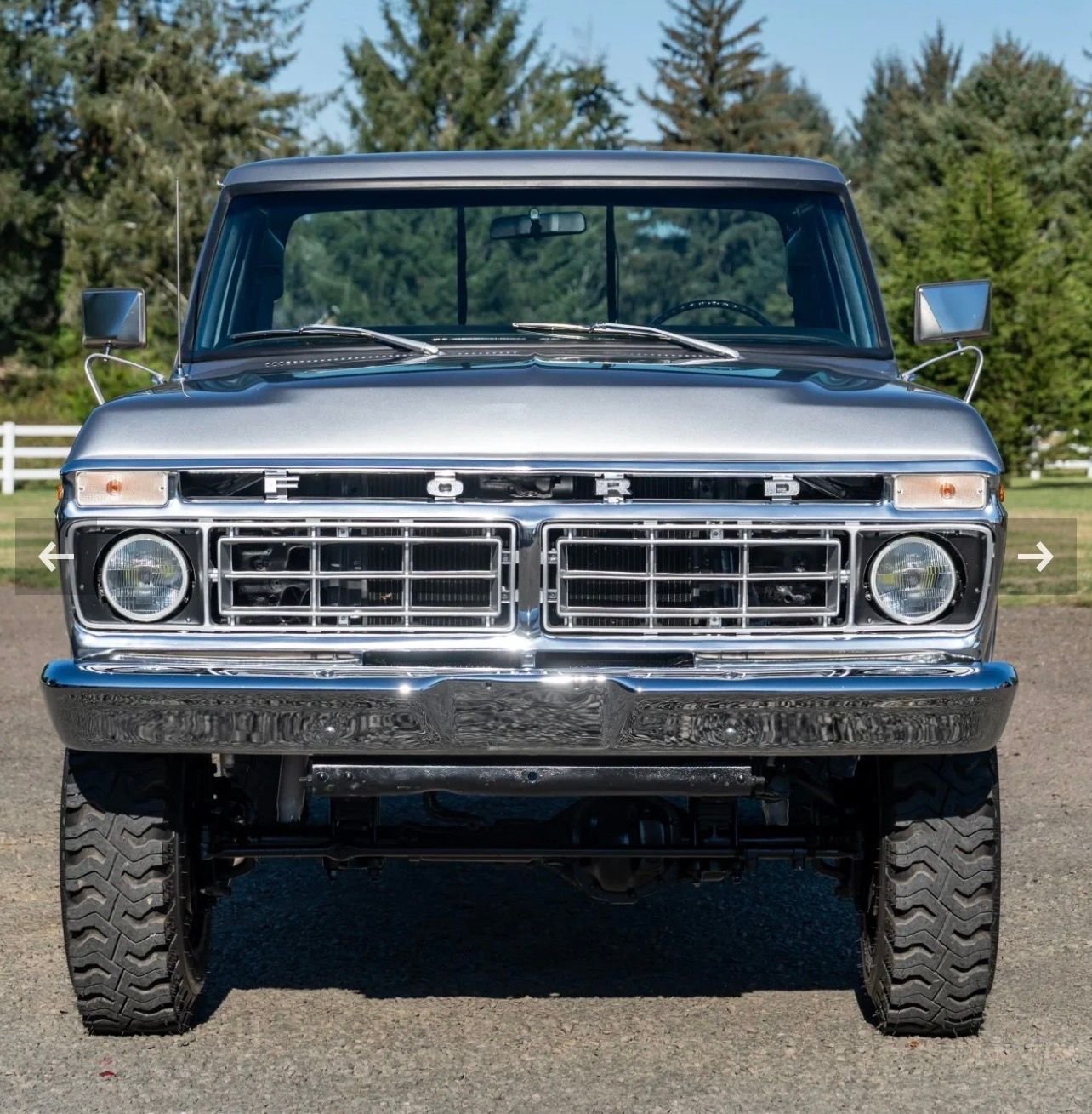

This is how I feel when people don’t paint parts of the grille surround on high dollar restorations. The posts behind the FORD letters should be black, as well as the bottom horizontal parts right behind the bumper.
Example below

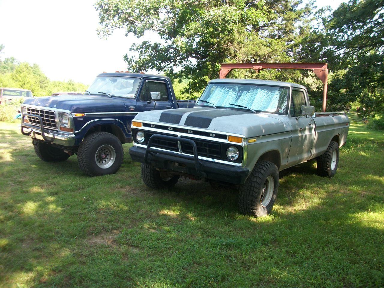

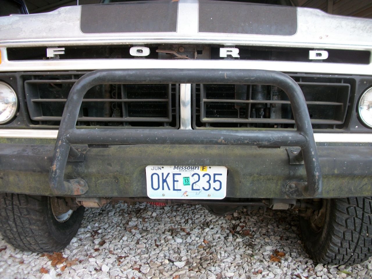

A person sure does have alot of choices on spray paint now days. That Fusion that is for plastic is nice and available. A long time ago, I grabbed a spare set of inserts from the local JY (again a long time ago) and just spray painted them to flow with the bumper color.
I bought the 1979 bumper with the push bar for 20 bucks, again a long time ago. The PO welded the push bar to the bumper, so I got as a package deal and mounted it on my 77 as is. So yes not the proper bumper for a 77, and the grill insert paint is faded like the bumper, hood strips. And maybe the bumper is a little grungy, but I am good with it.

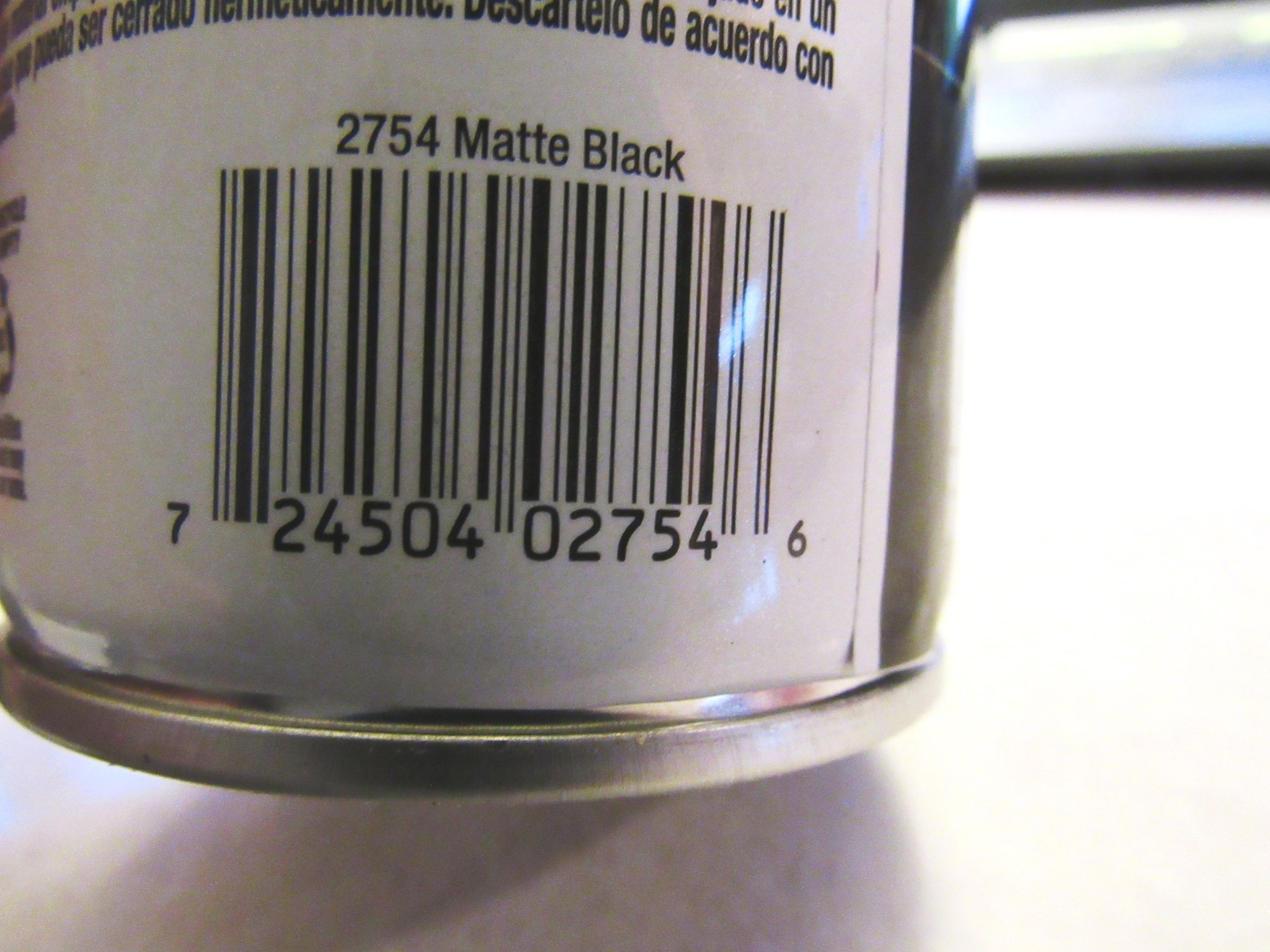

This is what I ended up buying yesterday. Walmart had it on the shelf.
If I had a really nice truck I would have ordered the SEM instead.
I have used Fusion semi gloss white on exterior trim on RVs that have started to and have turned yellow over the years. They yellow because they don't have titanium dioxide in the plastic and they looked great after painting them.

I would do a test spray first. if it's actually matte black I wouldn't use it. not only will it look odd but bugs and everything else will leave lasting marks. I had a '69 Mach 1 with the matte black hood and it was a nightmare.
Semi-gloss would be best.

Thank you again, its back to the store again.

Yes .... do a test spray of both the matte and the semi gloss, they both look great and hold up well. The matte ain't so rough like those hoods often were. Either one will match if you're doing both sides.
