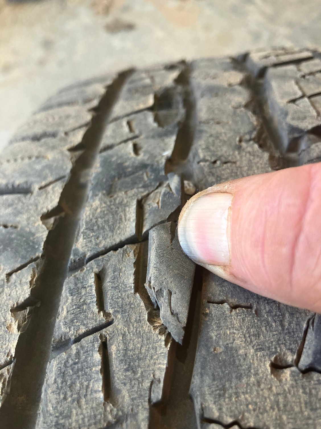

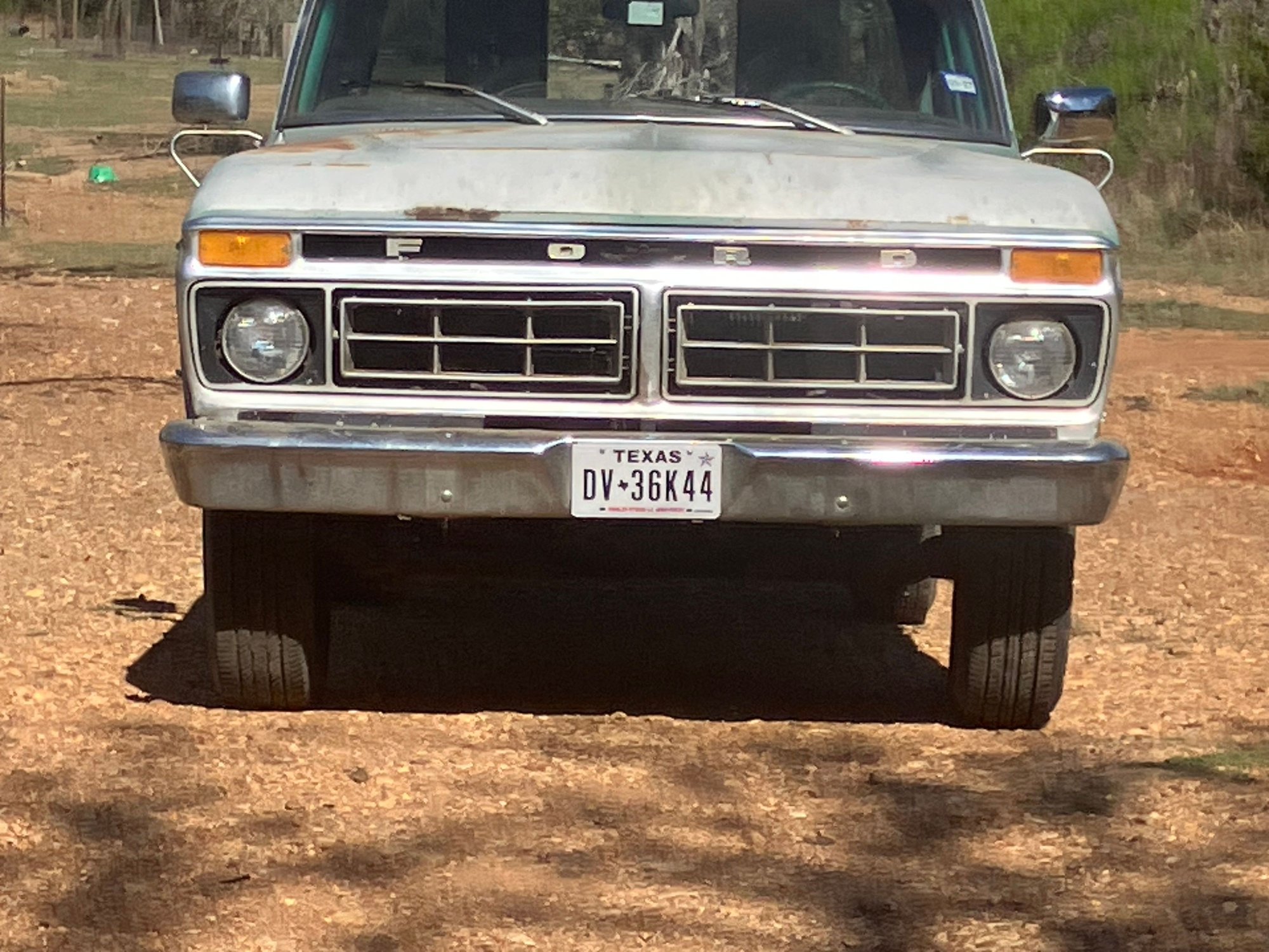

So here's some pictures of what I've got going on. This tire was on the driver's side front.
As you can see the wear is pretty pronounced. I saw that chunks of rubber were coming off
and put on the spare until I can get this figured out. To answer the question; No haven't changed the shocks yet.
Waiting on them to show up (RockAuto).
And while I agree, cupping usually means shocks. This doesn't look like that to me.

Try the old school method for checking your toe-in/out, from the picture (which can be deceiving) your truck looks to have a bit of toe-in, which would correlate to your tire wear, add in bad shocks... for some reason, my 97 F350 4x I had started wearing the fronts like that, just out of the blue, adjusted the toe the old school way, then got it to a shop to dbl check my work, it was spot on.
