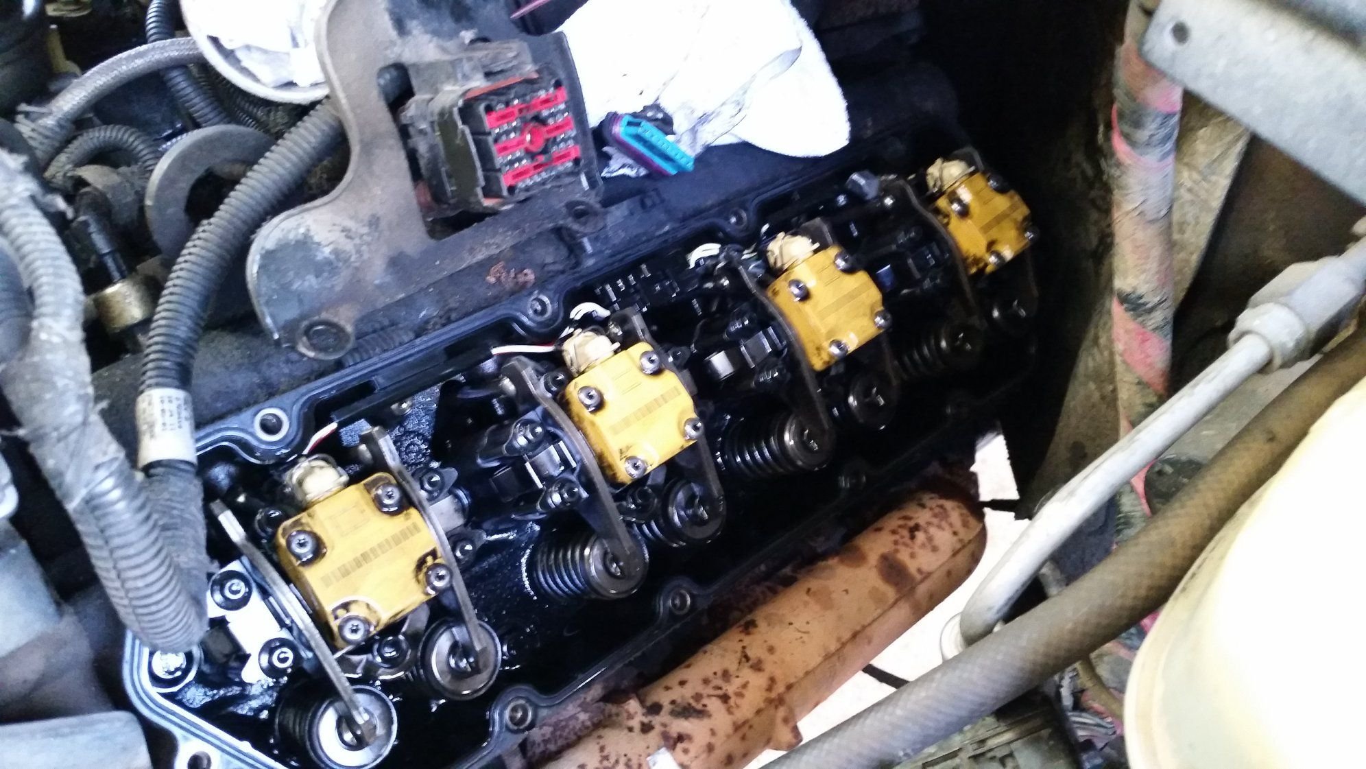

404k miles, still on original injectors?
Unknown if these are original. Here's a pic of them when I swapped in Motorcraft glow plugs and plug harness about 8 years ago. I've put about 50k on the truck since then.
