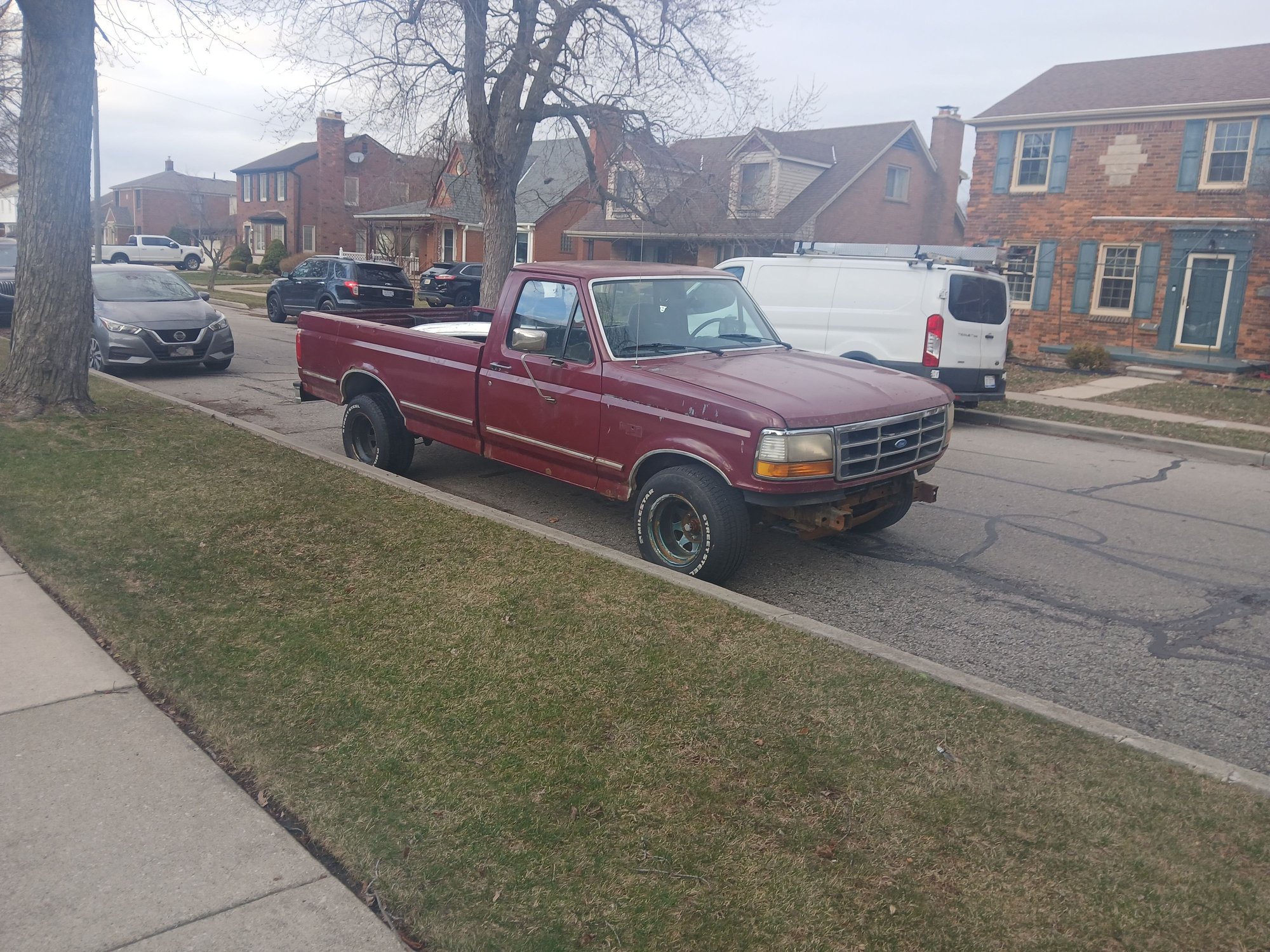

Bought a project vehicle f150 not running, it's a 2wd 4.9l XLT 5 speed 1992. i got it running a long time ago, was daily driving actually for a few months, then it needed more parts so sat for a month. it's now "road ready" again except it has a serious battery draw, once you shut it off, you got 10 minutes to start it back up again. The battery is merely months old. truck did not have this problem when i got it its actually been a very reliable vehicle as far project cars go
i am an auto technician student in college so i kind of know what I'm looking for and i know how to test parastitic draw at the fuses. I have tested the alternator and it appears to function perfectly, 14.5 volts. Before I do the current draw test today, i was just wondering if theres any really common issues with these trucks that cause a big draw like that that someone already knows about. also, where can i find all the ground locations without paying an arm and a leg? i can't get on my magic service data at school until thursday
