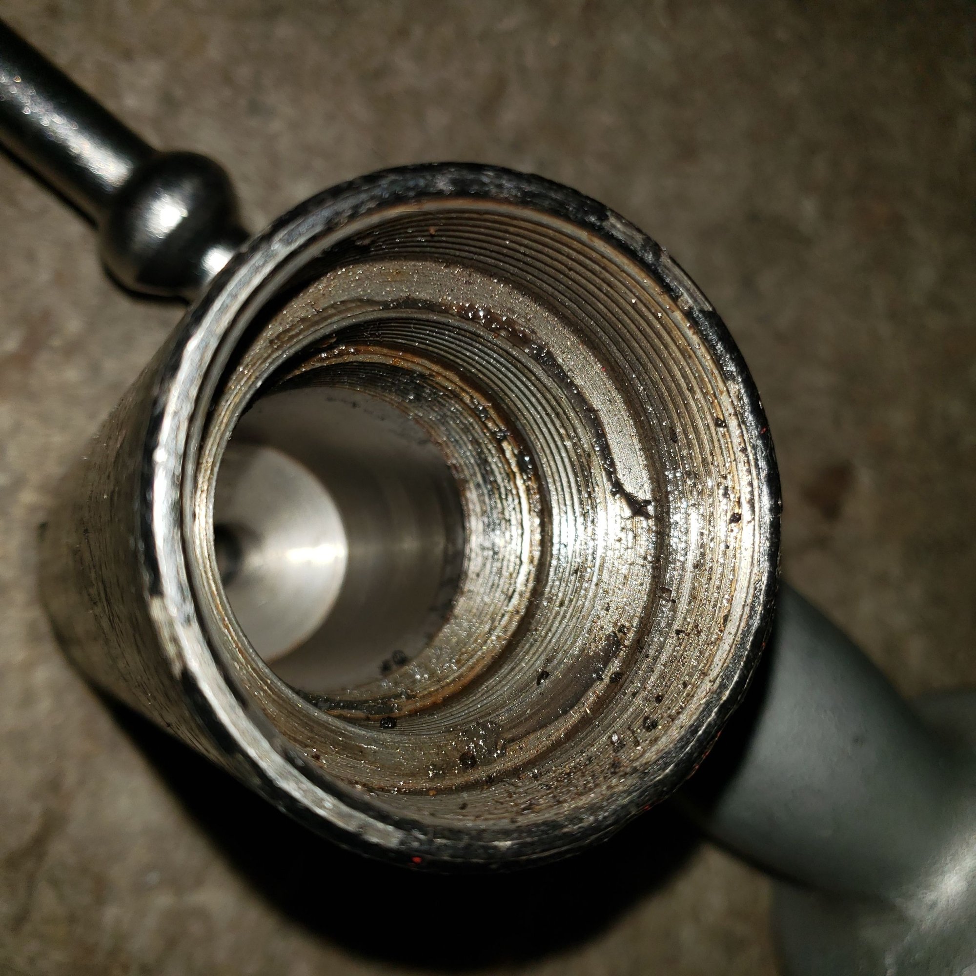

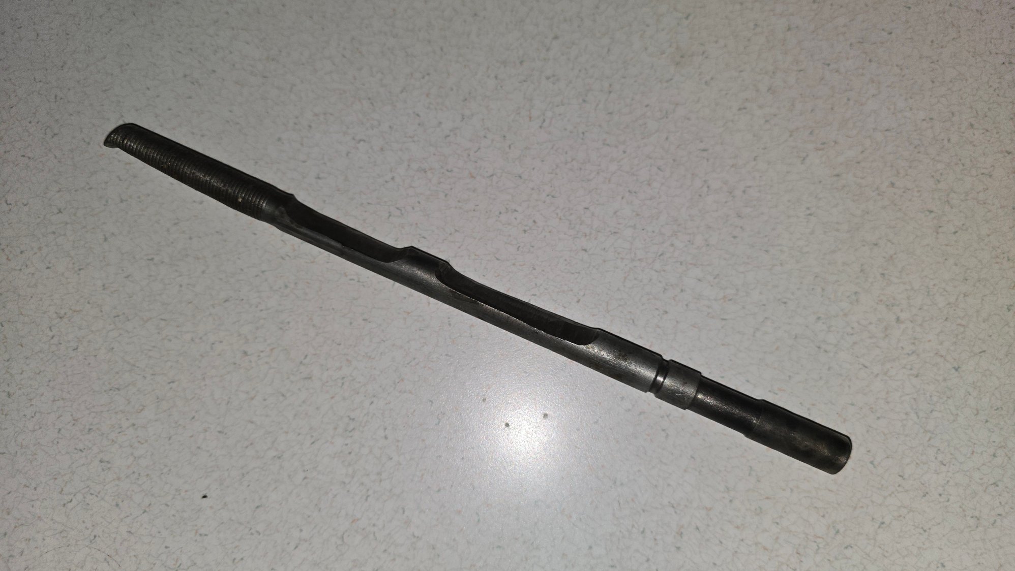

Dry / dead / gone to dust spindle bearings will not cause a failure
Yours are probably frozen up or turned to dust by now if not packed regularly
Just replace them and be all good again
I made a few special tools to remove them easier
This one is made from an inner tie rod end from a Taurus or Explorer, but any metal will work, even rebar
The short cutout is for explorers and rangers and the longer one for F150-250-350
Using one of these, I can get a spindle bearing out in 10 seconds
Time is money
Fun stuff
4x4 hub pack paid 2.0 hours
Replacing spindle bearings were .7 each
