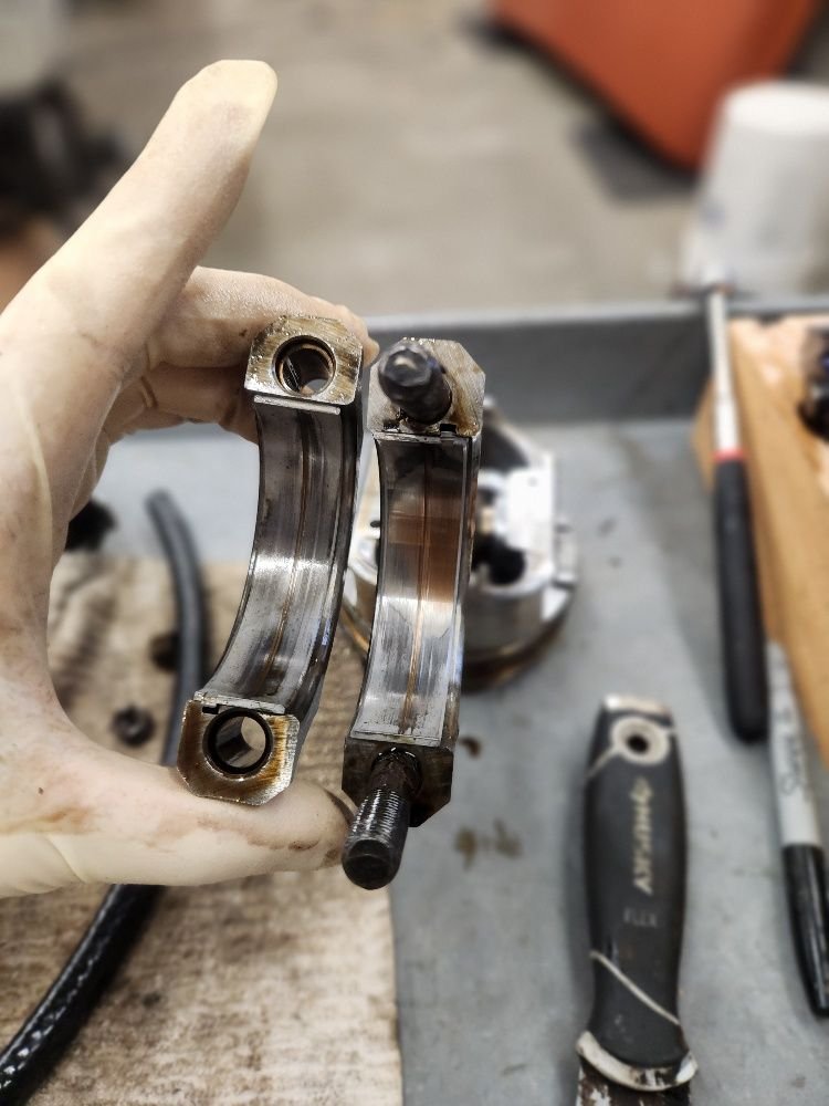

The 400 is at a new shop. the first shop decked it .020" and because of piston choices during Covid it is bored .040.
Whoever chamfered the crank did not debur or polish?? resulting in it eating my rod bearings. I have some journals with a significant groove.
Anyway,, if a hone can clean up my .040 without boring i will buy new pistons. I do not know how much my crank has been turned. First shop gave me no paperwork. One of those deals where you just happy to get it back..
I did pick up 2 M blocks with week.. If i need a crank and pistons, I will build a 521 and sell my trickflow heads and cam package.
