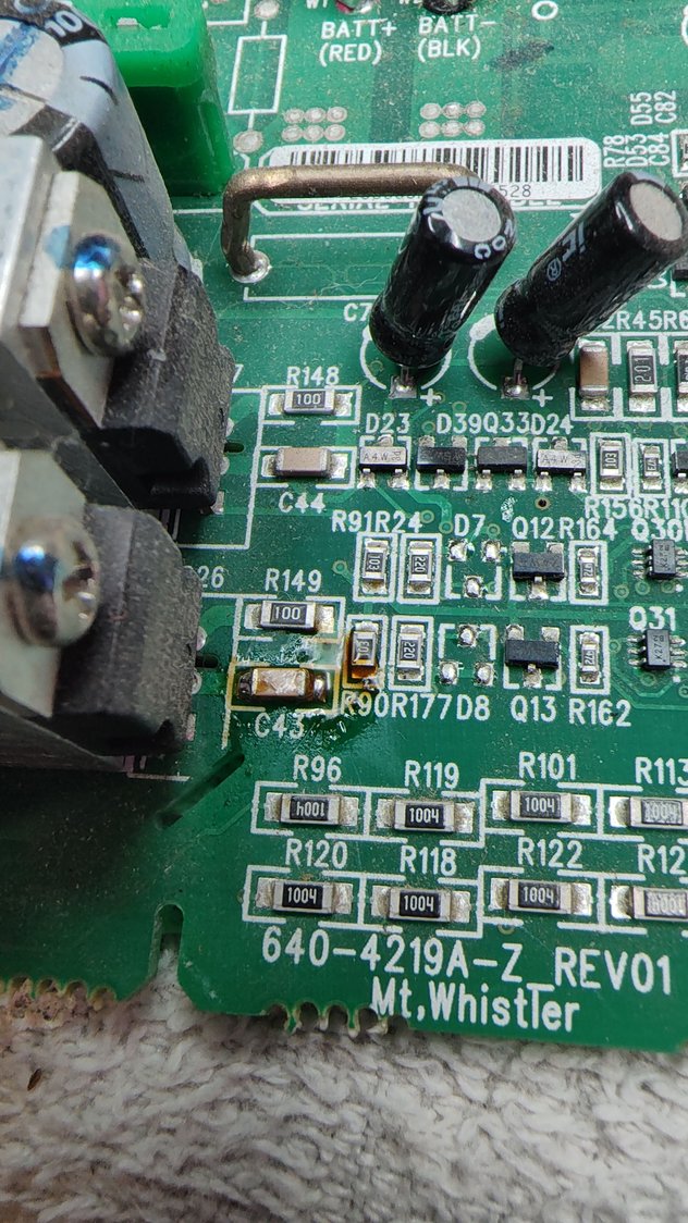

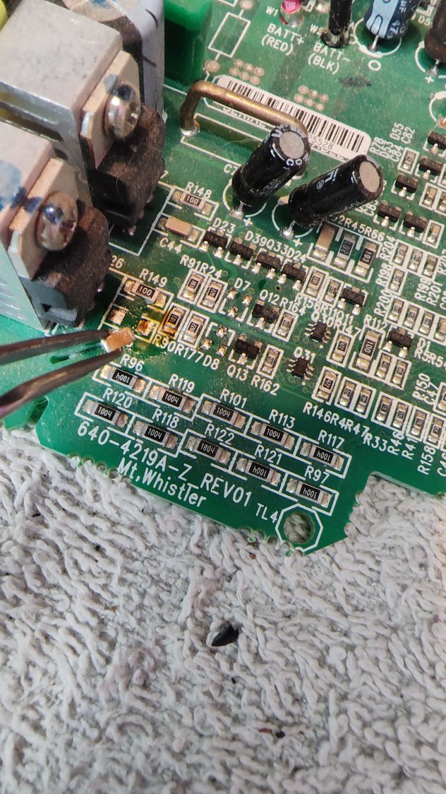

Just because I was curious...I desoldered and soldered and tiny capacitor on a random circuit board I had in the bone pile (I save PCBs for parts). It was relatively easy. I have a standard Weller soldering station and a magnifying glass attached to the bench. I used desoldering tape and flux. The cap was 1.9 nF.
So, physically it is not too bad. But the capacitor value can't be determined if it is damaged. Many of these tiny caps are used for high frequency noise filtering and won't kill a circuit if they fail open. But anything is possible.
Here are after and before photos.
AFTER
BEFORE
