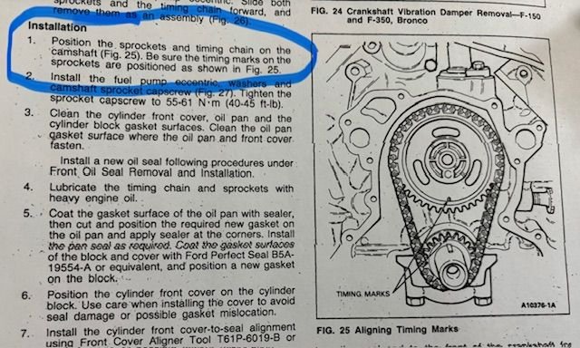

I am about to do my timing chain soon. I replaced the original chain probably 15 years ago or more. I think I goofed when I put the new one on. The lower sprocket dot was on top like should be, but the top sprocket dot was on top also. I don't think internet had many videos like they do now.
Anyways, when I go to do new chain and sprockets, can I just find TDC and verify with balancer and rotor. Then put new chain and line the dots on sprockets the correct way this time. I know the bottom has the keyway, top sprocket doesn't, correct? I'll re-check timing after all bolted up.

Your keyway goes straight up, and your dot goes straight down for your 351

Definitely had the keyway straight up, but also the top sprocket dot up to. Been running fine a good 15 years easily lol. I know there has to be major slack by now.
No but there were paper shop manuals.
I was in the Air Force working on the F-16s back in the day. Everything, I mean everything, you had that manual out and to the correct page.
Yep. Tech manual always on the work bench especially during reassembly for torque specs. According to my Ford shop manual you skipped over step one
Oops. I’m with manic in that I’m surprised it ran.
