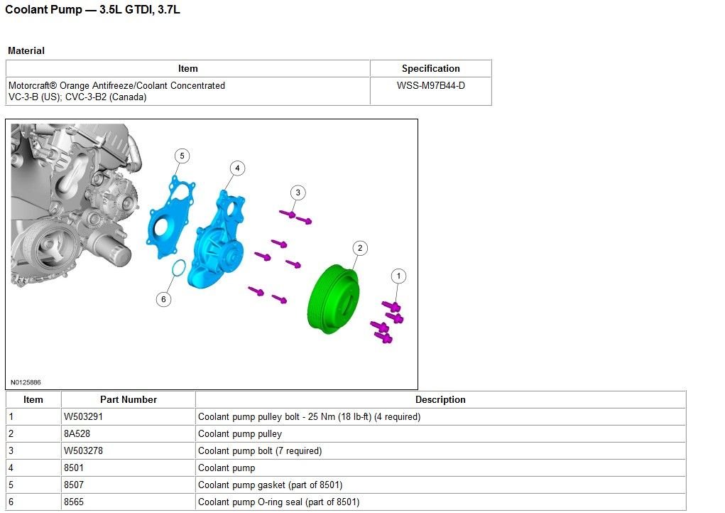

Originally Posted by B+ squad
You're thinking of the idler gear. The water pump is on the outside. The idler gear is not the water pump, that's where it would be for the Taurus SHO.
For some odd reason people think just because it's a certain engine (3.5) in this case, must be the same no matter what you stuff one into when it couldn't be further from the truth.
@tiredmec They internalized the water pump on the front wheel drives due to space constraints. That pulley you refer to as a water pump is just an idler. Pump on the truck engine is as shown below.
This pic shows the timing gear that you mistakenly thought was a pump, it's just a gear. #13
