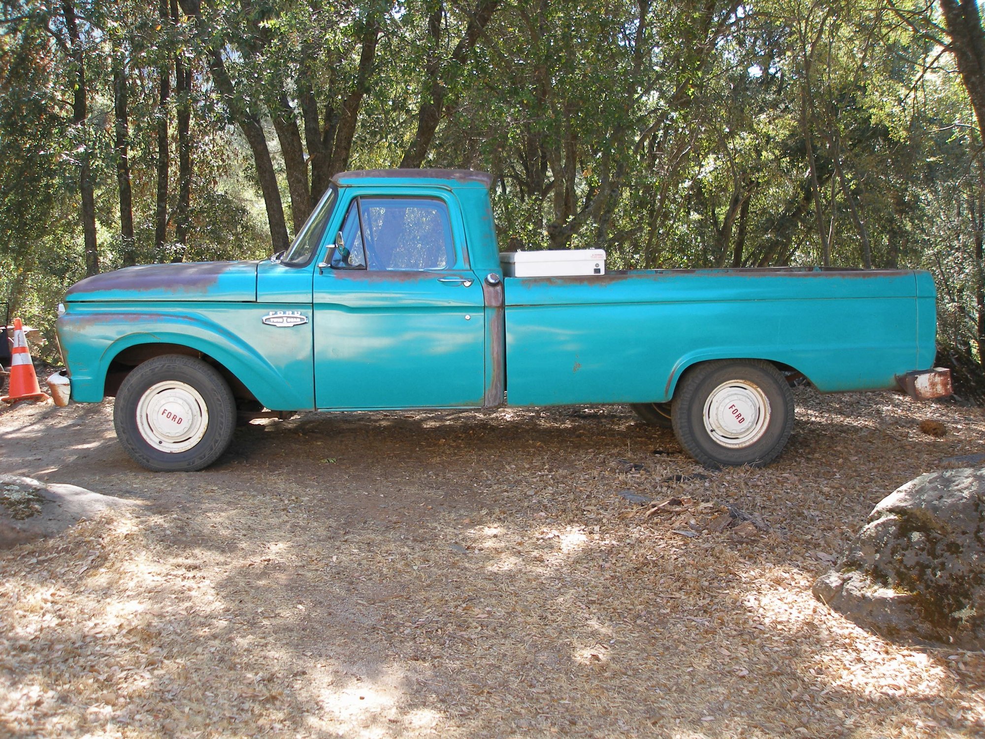

I enjoy my 66 F100 "Shrek" without the radio, as he was ordered with the radio delete option, if the off chance I want music or to listen to something, I have my Shokz to use

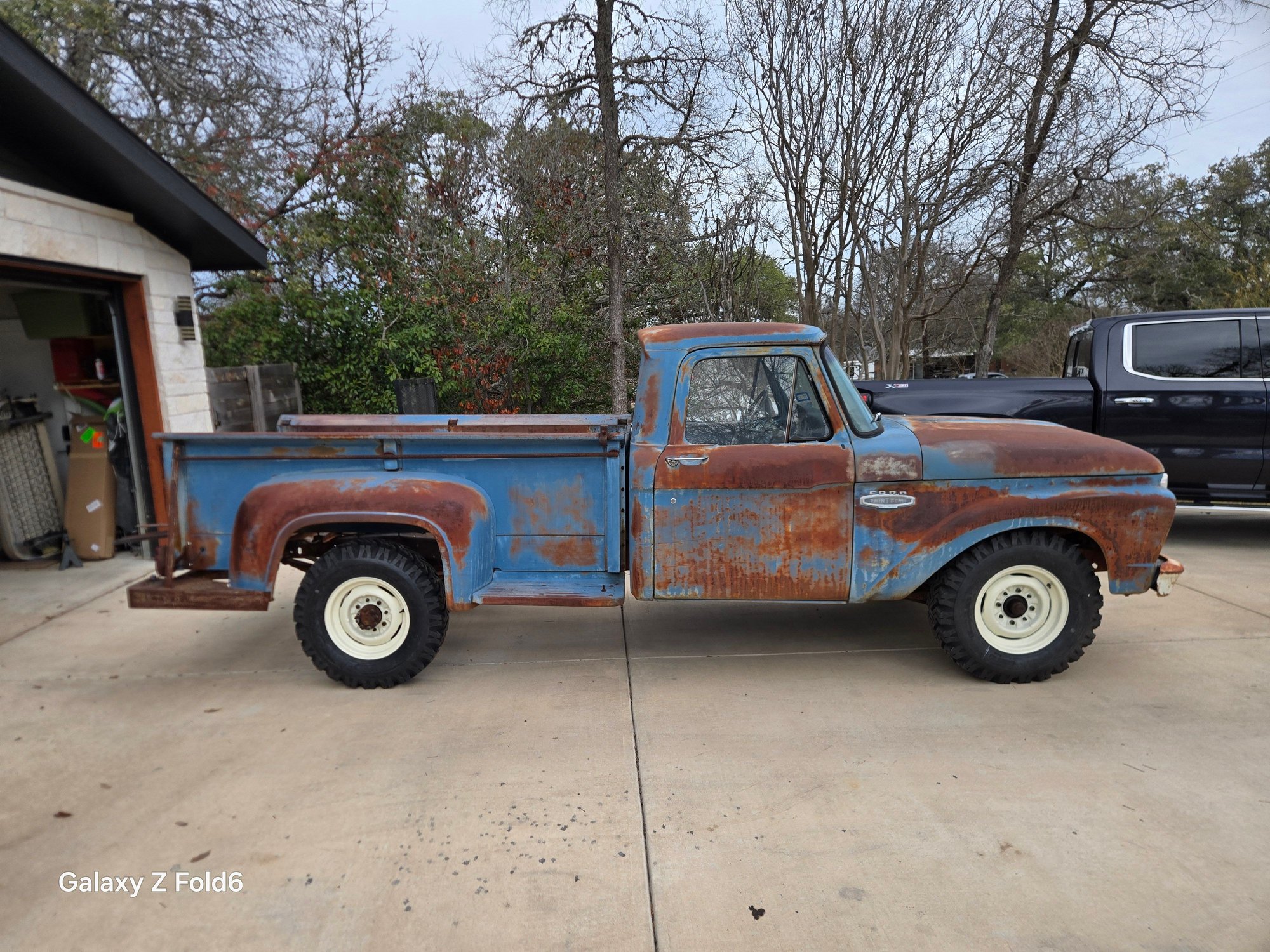

I think dash pad is the only upgrade this one has....

Loving the tire/wheel combo!! And the patina! I'm a huge fan of natural patina
Shrek my 66 F100 and Bullseye 66 F250

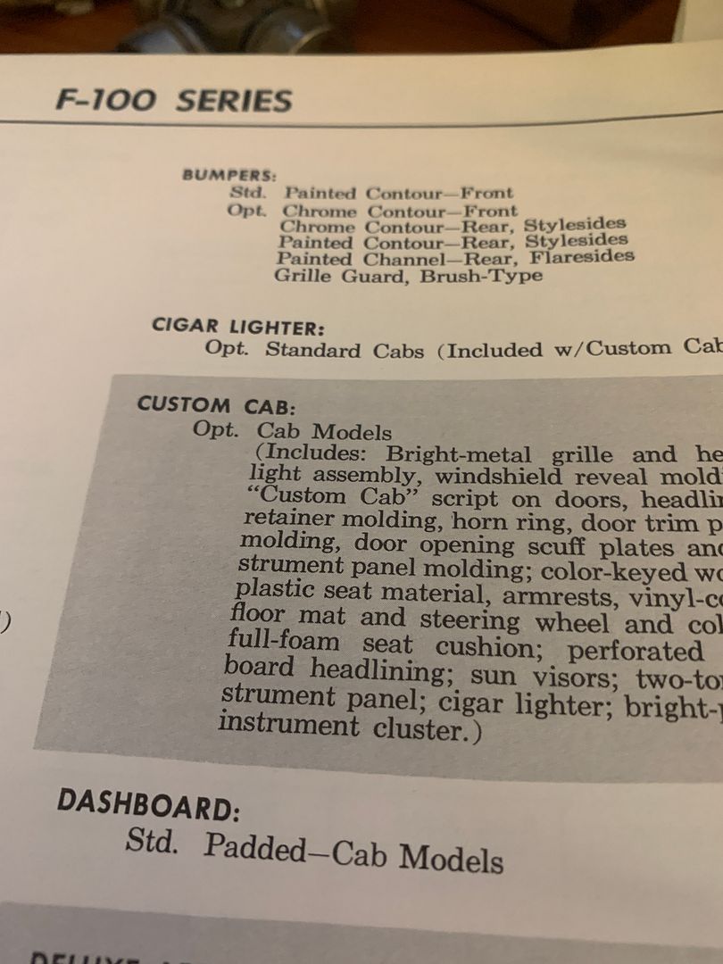

1966 was first year for the dash pad being standard equipment so not an upgrade for that item. You had to special order if you didn't want one. Yours looks to be in decent shape. Here's the page for F250 2WD. Lower left corner.

As you can see from the page above the cigar lighter was optional for Standard Cab and standard equipment (included) on the Custom Cab for 1966. No dash pad probably the only reason for the special order among those choices. There was a Delete Option for the heater that would have saved a few more bucks.

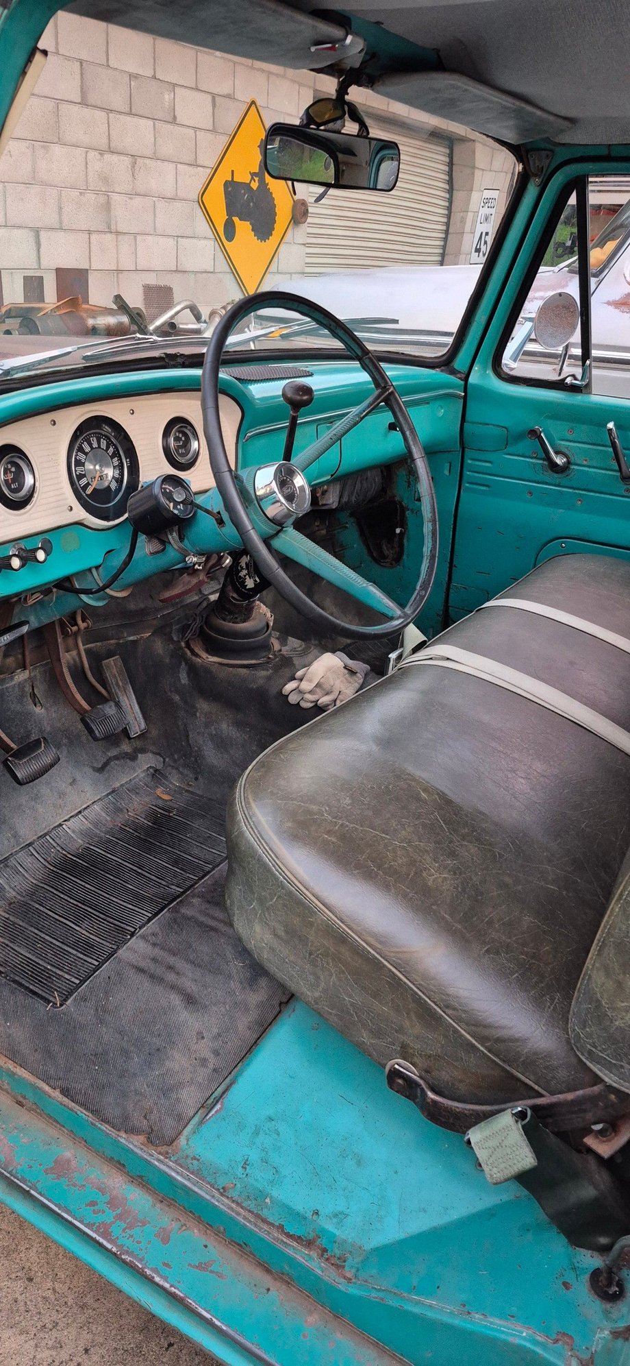

Absolutely, I'll get good pictures of them tomorrow, and I was wrong, I forgot I took the cracked dash pad off it was so bad, so it did come with one, it has the 6-digit DSO # so it was special in one way or another
Ok, so had to walk up to my shop to get beer and bring it down to the bike garage fridge (I only have 1 motorcycle in it now but still call it the bike garage) so I took a pic of Shreks data tag, and some more info, he was from SD, bought it from the OG owners son, he lived a hard life, was towed behind a road grader when he was building roads in South Dakota, had some crude brackets bolted on the front bumper bolts and I've cleaned sooo much asphalt/tar from him over the years. He also has some nice barb wire pinstriping on the front (ask me how I know what that looks like... lol) I finally pulled the original 240 out in late 2021 and rplc'd it in late '21 with a 300 since it was smoking so bad going down the mtn.
