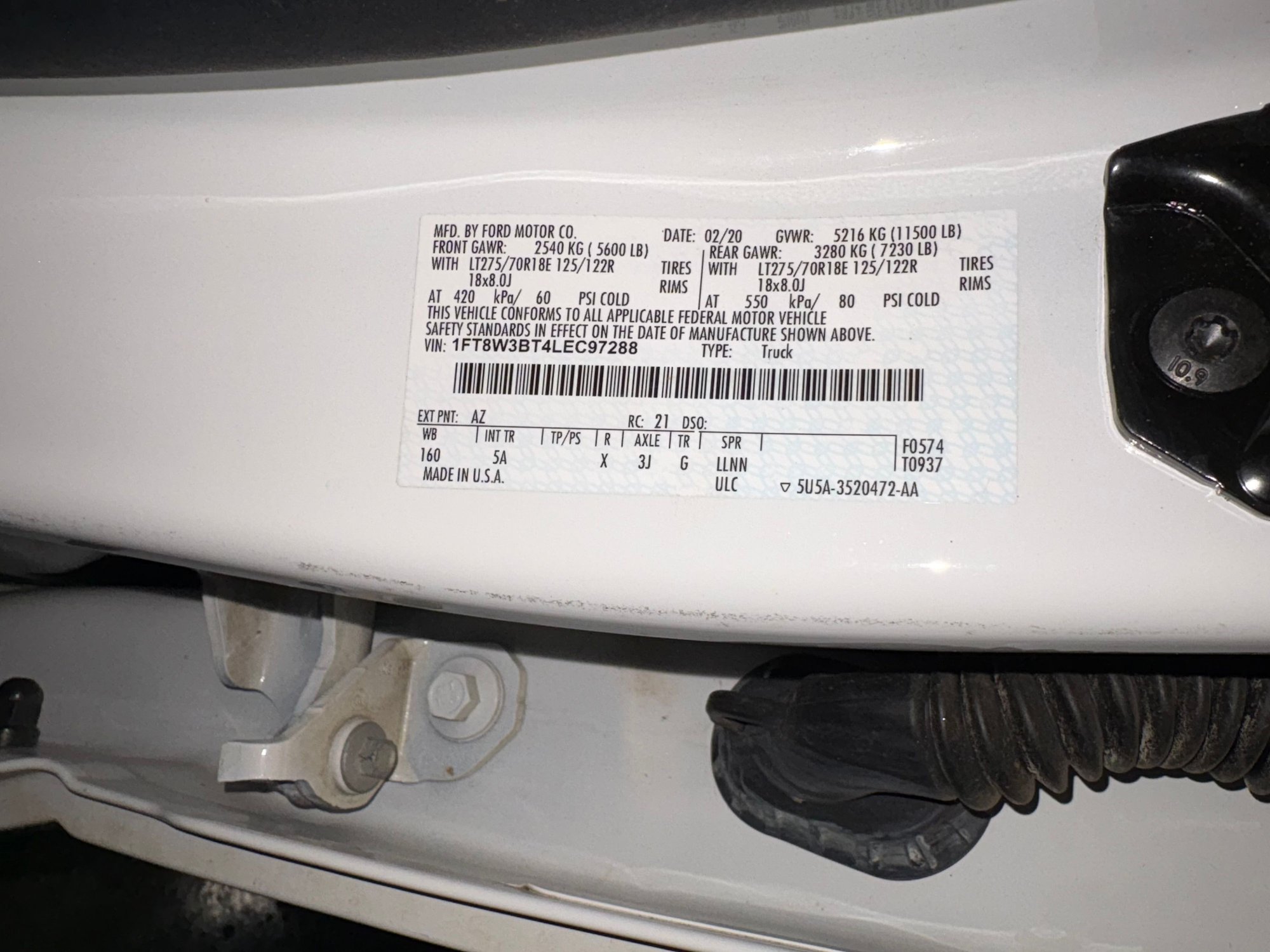

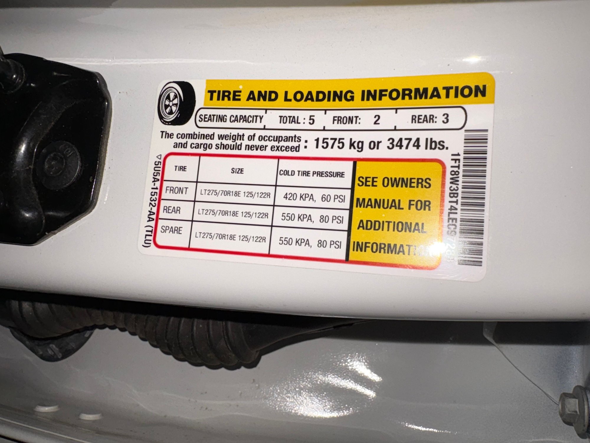

Can anyone explain this. Going by the average weight of 6500, my 2020 F350 SRW has a GWVR of 11500 lbs but only 3474 of payload capacity.

Average weight doesn't mean that is your trucks weight. And usually those weights that Ford uses are based on the lowest trim level in the smallest configuration so that they sound the biggest. Go with a crew cab and 4X4 and that adds quite a bit of weight, go diesel (which is sounds like you are?) and that's another big hunk of weight. It isn't hard for all those options to add up. And if those stickers that are on your truck are right, then your truck rolled out of the factory a little over 8k lbs. But here's the kicker, chances are, your payload is even less than that because as soon as you add anything else to your truck, that number keeps dropping. Bigger tires, tonneau cover, tools, etc... The best thing to do is to fill it up and roll it over the scales, then subtract that weight from 11500.
Where does this "average weight of 6500" come from?
My 2021 F350 long bed, crew cab, 6.2l 4x4 is 7600 on the scale. That's with the 48gal tank full, my fat butt (210lbs) in the driver seat, a Line-X bed liner and an aluminum cross-bed tool box that is about 75lbs including contents.
So I am 1100 lbs heavier than you, and I have a gas engine. My truck has an 11,300 GVWR spec, so I have 3,700lbs of available payload.
As mentioned above, every option and accessory reduces actual payload. The advertised "available payload" numbers are usually based on a regular cab XL long bed with a gas engine. But actual payload on the door jamb sticker is calculated for each truck as it leaves the factory. In your case, your truck would have weighed 8,026 lbs (11,500 is the maximum it CAN weigh - when you subtract what it DID weigh, that 3400 lbs is what you were left with). Even factory options like sunroof, leather, sliding rear window, tailgate step - those all add weight to the truck, and since the GVWR doesn't get bigger, the payload has to get smaller. Then you get it home and add all of your aftermarket favorites - winch & big bumper, bed topper, tool boxes, big wheels and tires - those all come off of payload pound for pound.

A F350 CC definitely weighs way more than 6500.
Take that 11,500 GVWR and subtract what it shows for cargo capacity, you'll be much closer to the weight of your truck.

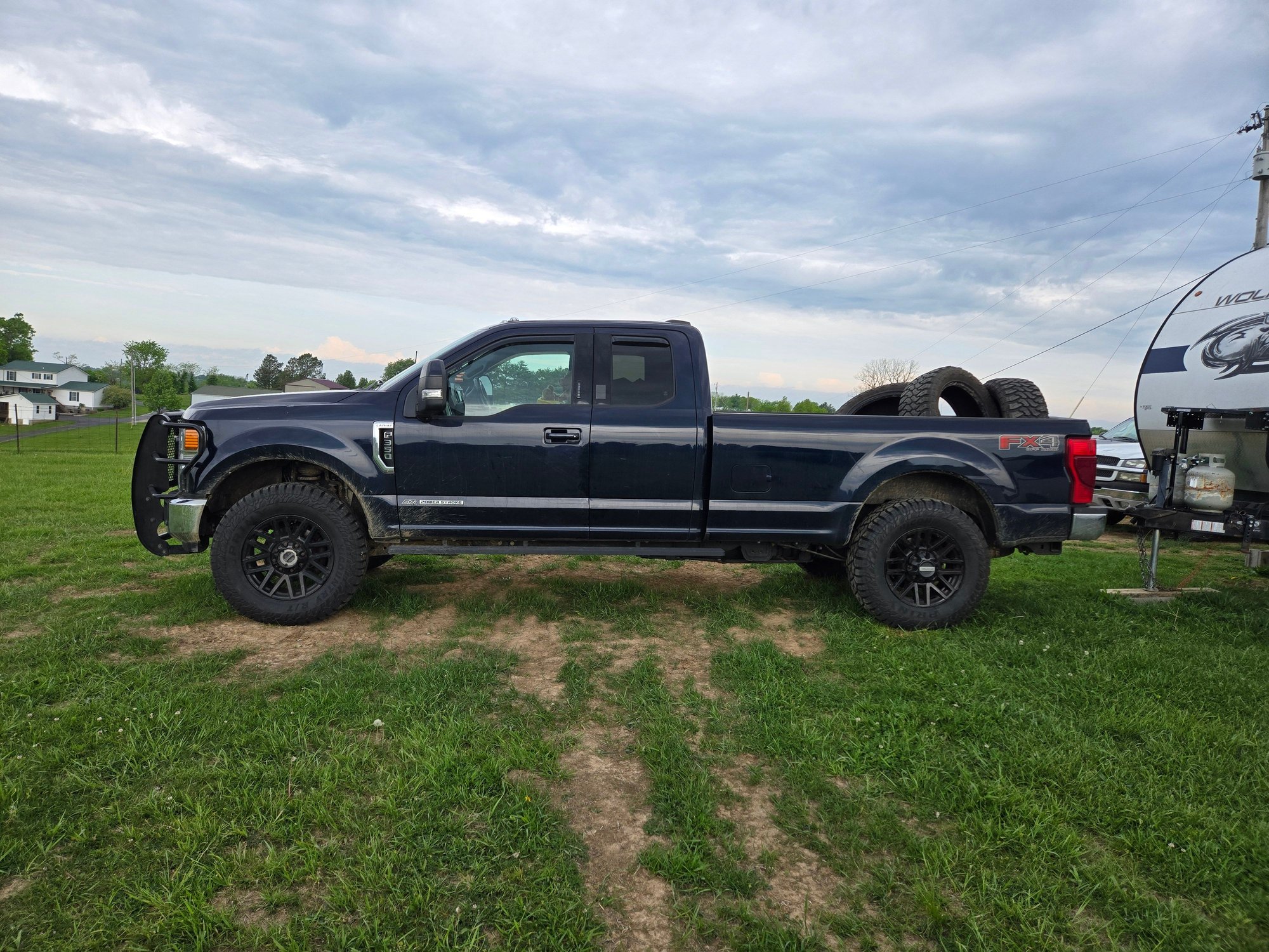

2022 SCLB Lariat 6.7 snowplow camper pkg 11,400lb GVWR. Scale weight with operator & full fuel 9,060lbs. Oversized tires, front hitch & grille guard.

Originally Posted by BC2019F250
My 2019 SuperCab Lariat weighs 7800 at the scale.
Truck, me (a petite 275 pounds), toolbox and some extra tools in my truck
Rolling across the scale at work, I am between 8000-8150 depending what I have in the truck.

The math would indicate a curb weight of 8026 lbs. That's no occupants, as it rolls off the assembly line and with a full tank. Did it scale close to that?
The sticker math on my CCSB 6.7l equals 7761 lbs. When I scaled it, it had a Bakflip folding bed cover, aftermarket (heavy) AGM batteries, about 10 lbs of personal belongings, and me, approx 190 at the time. It weighed 7960. So after subtracting the weight of the myself add ons, the sticker calc was actually pretty close.
