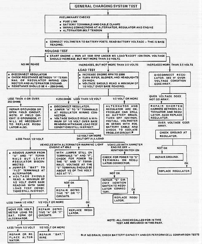

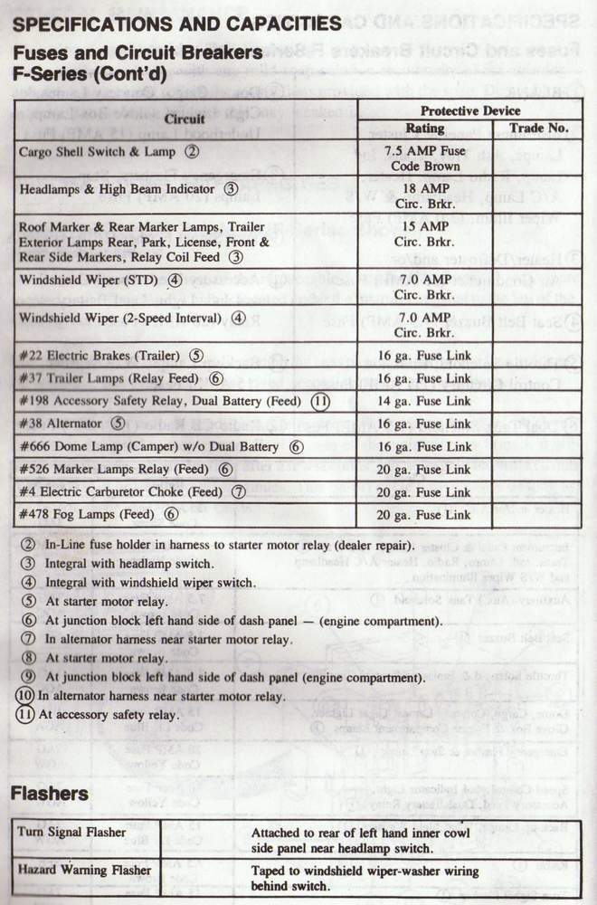

Check the battery for voltage. Check the wiring harness near the battery and voltage regulator for damage (fusible links). Headlight switch or wiring to it may be done.

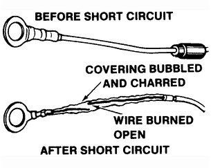

Did you by chance hook up the battery connection backwards for a sec, and blow your fusable link? Find that wire and see if it is "streachy".

If it has power in, the fuse link is good

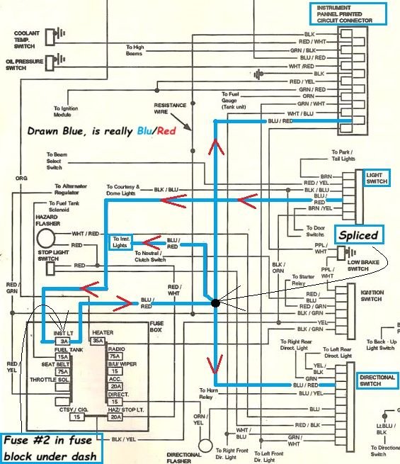

since you mentioned fuse 2, I assume you are talking cluster illumination and not headlights/taillights? If so, have you rotated the headlight **** to adjust the brightness?

Just off the wall here, but that fuse #2 is a 3 amp fuse that only gets power in when the headlight switch is on. Most of the fuses get power directly from a buss bar .... but not #2 which is dedicated just for instrument illumination and is only used to protect the head light switch from shorts, it serves no other purpose and unless and until the head lights or just park lights are turned on, it will have no power through it.
If you're just testing fuse #2 for volts, it will not have any unless the lights are on. If testing just across the fuse for continuity, if it has none, then it's blown ....
Originally Posted by Edhetling89
Yes I have turned the **** and pulled it got power to and from the switch but no lights work
And if fuse #2 is blown .... there you are .... but maybe you knew that already.
