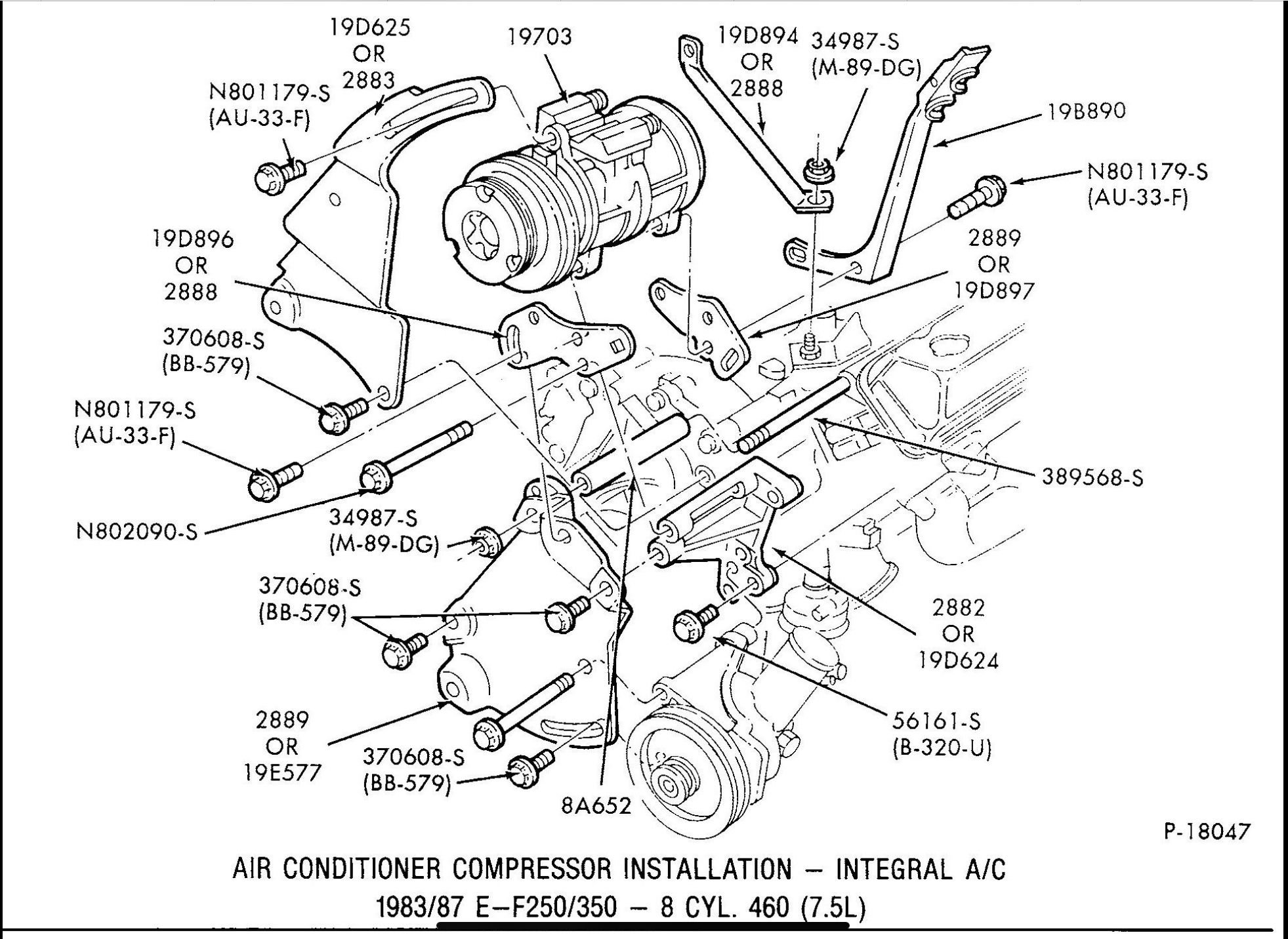

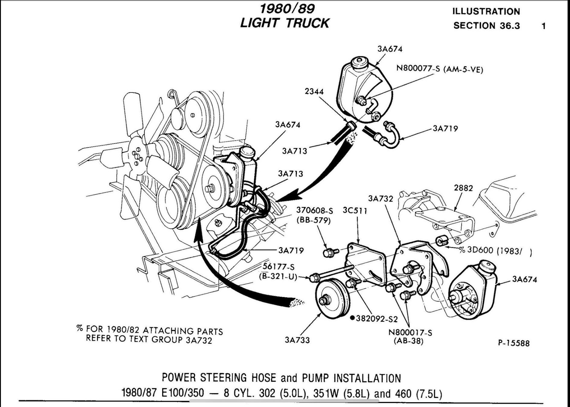

I'm trying to get the pieces to swap my 84 f150 with the 351 to a Saginaw pump. I know i need to look for brackets from the E-series but all the ones at local yards have been picked apart pretty good so i was hoping someone would have photos of the necessary bracket pieces and how they go together, i did grab a pump and the little bracket section that encases it

Here’s a 460 diagram

OK just wanted to point out that a 302 bracket may not would on a 351.
It is the same bracket on serpentine belt trucks. I don’t know about V belt systems but I don’t think it would be different.
