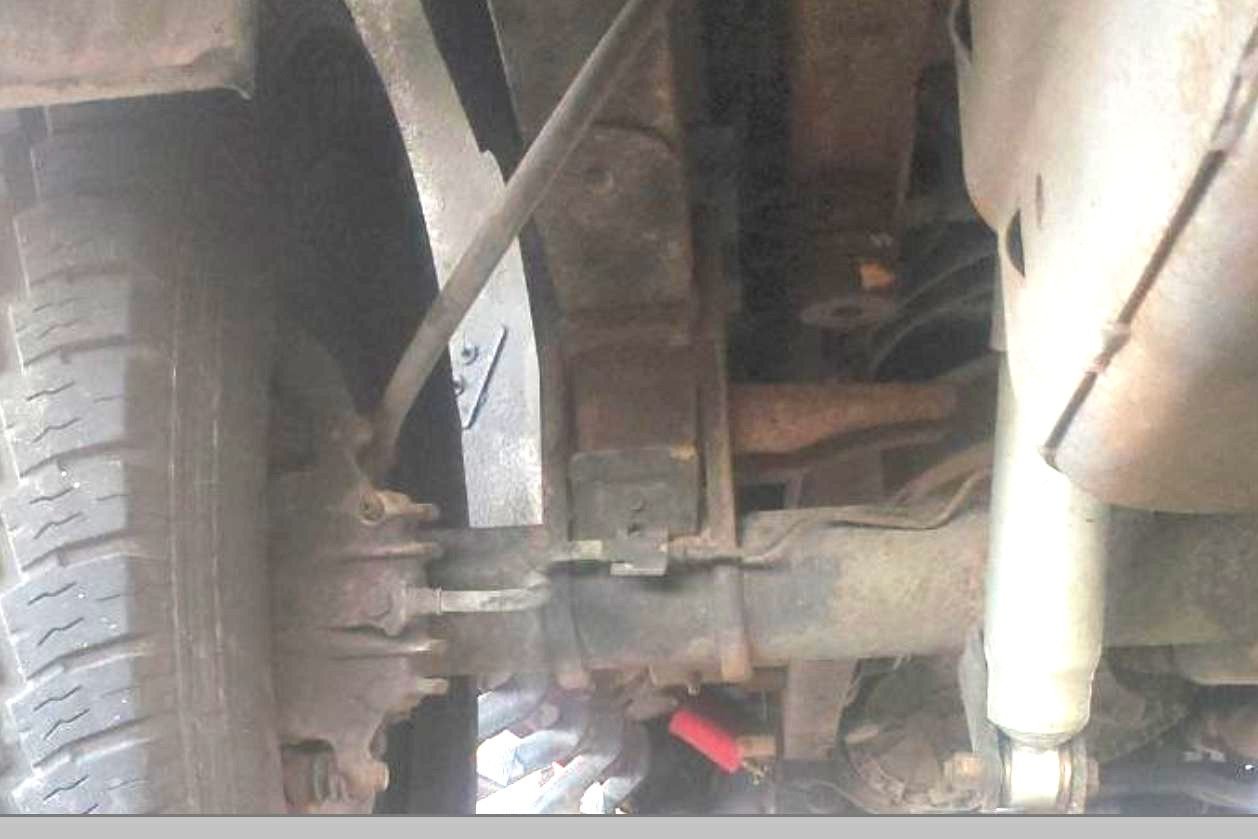

get longer shackles and add a block under the axle.
mine looks like this.
Longer rear shackles would actually lower the rear of the rig, they go above the rear springs mount to the spring, so a longer shackle would move the rear of the rear spring upward lowering the rear of the vehicle. A taller block would lift the rear whatever amount over the stock block height the new block is. John’s suspension pictured looks to be completely stock, not exactly sure what he was intending to explain with that picture as it should be exactly the same as the OP’s suspension in question.
