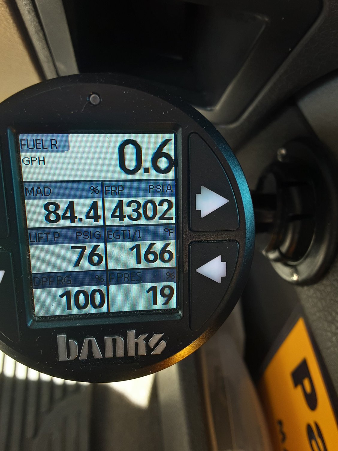

Here's the PID I am taking about... 2nd row on right. Lift P PSIG
I am curious to see where yours is at.

Got it

Oh I wish I had your Lift Pump pressure option on my rig. I'll do a mechanical fuel pressure gauge one day.

Originally Posted by smr camper
Got it
Okay, so prior to my S&S gen 2 DPK install, I was seeing middle 80s or so when the fuel filter set was new. I let my truck tell me when to change my oil, usually at at least 7k miles but usually under 7.5K miles, and change my FD4615 fuel filter set out at the 3rd oil change at those intervals. The factory manual says every 3rd oil change or by 22.5k miles...
By the end of the fuel filters life (prior to changing the filters out at those miles), I would see the fuel pressure drop to the high 70s. With a new set of filters, I'd expect you to see pressure in the 80s like I was.
Now with the install of the S&S DPK, pressure went up for some reason, it's up in the high 80s (I see 90 at times) and does not come out of the 80s but does drop down as the miles click up... which makes sense as the primary filter loads up with particles.
I think you may have a weak DFCM primary pump but maybe have it checked out professionally before replacing it and to rule it out if not...
