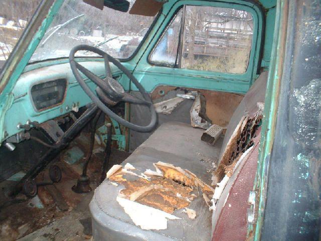

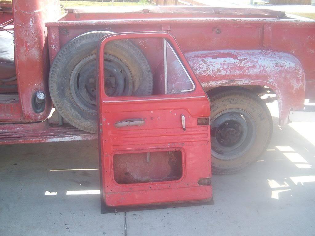

I have a quandary. My 55 F-350 is a 100% legit Custom Cab F-350 1 Ton Express. Everything Custom Cab except no Duo-Tone seat upholstery and no Fresh-Aire Heater. It has the appropriate exterior trim and dual locks. Appropriate interior trim panels. It has absolutely no evidence that there was ever the bright trim strip on the dash, but the strips were on the doors. I have looked in an original FoMoCo parts and accessories catalog and a new reprint version. Absolutely no listings whatsoever for the trim pieces. Was it even actually a thing? Or, was it like the 56 stainless drip rail moulding? Something that only exists because a hot rodder back in the day made it and it became a thing? I’ve seen some Custom Cabs with it, and others without.
No dash trim, but yes on the doors.
No dash, and no holes that were ever filled in.
Door trim.
Door trim.

OK, here is a truck that doesn't clear things up.
Years ago I found this 54 F600 Deluxe Cab. It had the 55 dash trim. Did an owner add it? Or was this a late 54 model and they started putting the dash/door trim in place? I can not read the build code date, can anyone? It does look like it was built at the Chester PA plant.
Here is nother oddity. It has the Custom Cab emblems on both doors which was not used in 1954 models.
