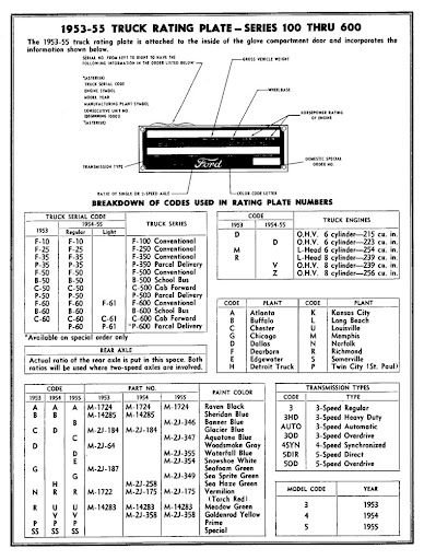

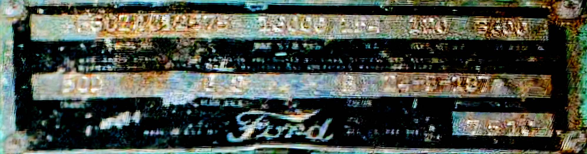

F6DZ4G12575
F6=F-6
D=223, Z=256
4=1954
G=Chicago or C=Chester
12575=serial component
16000 gross weight
154 wheel base
120 horsepower
3600 RPM
50D=5 speed overdrive transmission
I can't make any sense of the obliterated rear axle code
B=Sheridan Blue
14-B-187 production code which would be the 14th of February.

I think it’s “F60” which should be how they started out in 53. I’m also confused by the HP rating of what appears to be a 256 equipped truck. The 256 was a little more horsepower than the 239. The 239 should have been 130 for 54 and 132 for 55, and the 256 should have been around 140.

Wow, Brian, you cleaned that data plate up real good. Thanks!
But there is one minor error. On 53-56 trucks they used 2 digits for the truck series. For example an F100 would be
F10 and F250 would be F25. So the engine code is Z for a 256, which was the optional larger engine.
Ah yes!!
