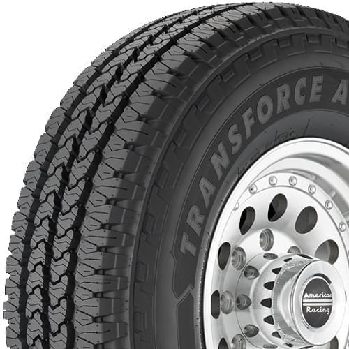

For rock hard sidewalls and tread, in a cheap towing tire with thin sidewalls, the Firestone Transforce AT is king. Generally in budget tires, adding some width greatly increases the tires lifting strength, giving a firmer sidewall feel. The skinny Transforce AT seems to buck this, a bit. Popular with evil van thing motorhome crowds.
These should be silent. I dont consider them an AT, even though, they worked well on my 2008 F250. I consider them a rock hard tow tire with excellent snow stability (not drive).
