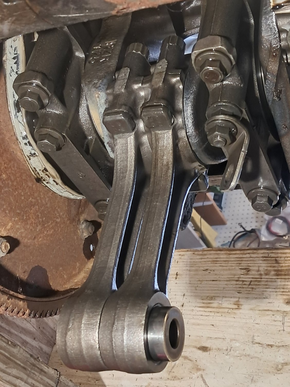

Bent Rod check
Was trying to check for bent rods without any specialized tools or measuring equipment and came up with this.
I'm thinking if the wrist pin slides through both rods they are both pretty straight

what if they are both bent the same amount?
I would do that for all and see if they all match up to the left one
LOL. Way too much work. Besides that, if they're all bent the same way, it doesn't matter.

Imo the bigger issue is have them crack checked. I broke one up by the small end that killed my original engine and there was actually a second one cracked waiting to kill it also

Good info, Thanks.
I'm getting the small end rebushed and sized and get the guy the magnaflux them
