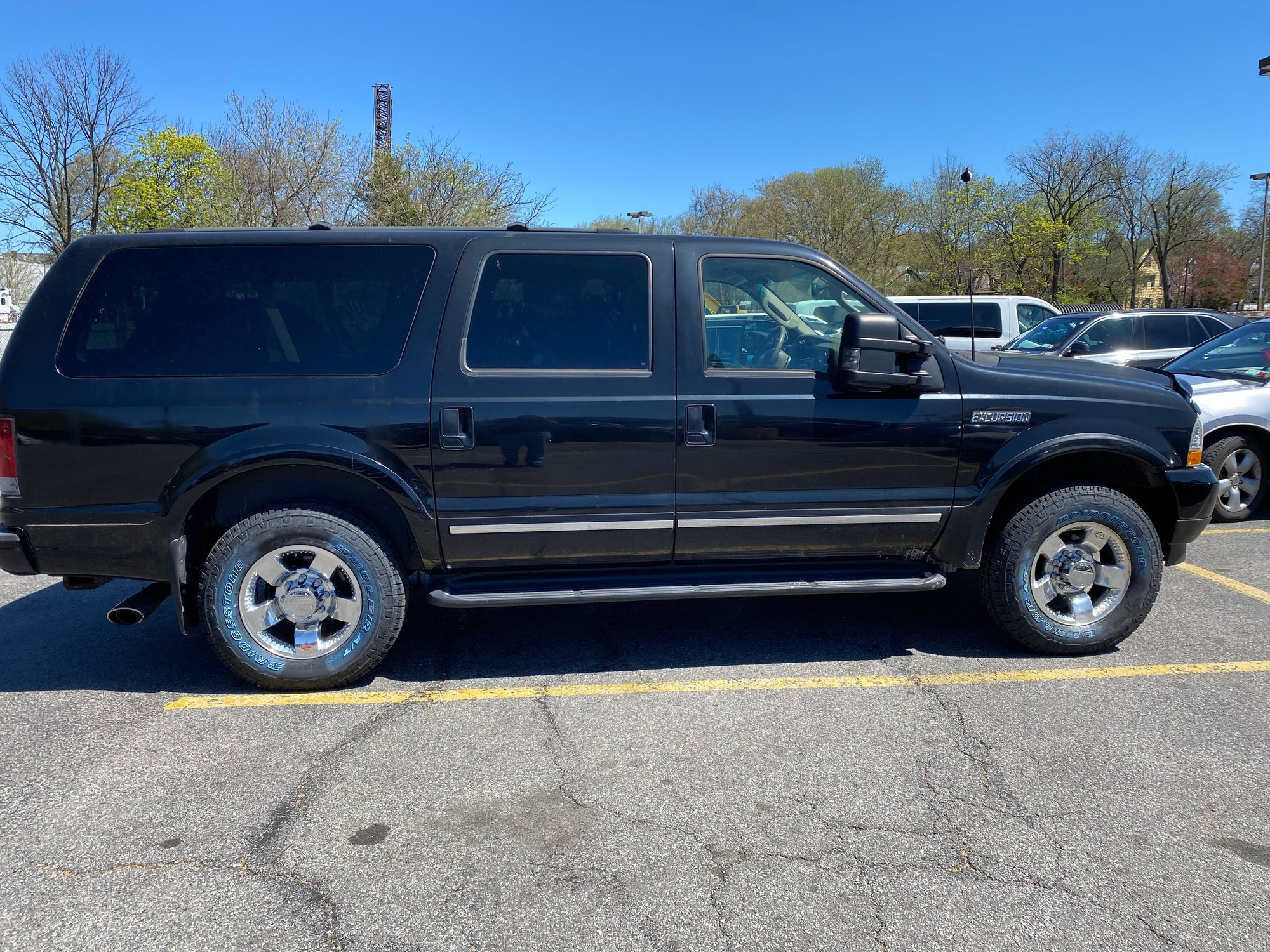

I suggest 285 as seen in my Signature,
but the stock 265 size will Tow better, and let the engine achieve the best RPMs,
I have a Hydra Tuner also, so the turbo can wind up.
here is a side pix for clearance.
these are el cheapo Americus AT tires, would NOT balance, and howled like a banshee, took them off, and installed Michelin street tires.
got rid of those steps, nearly broke my hip twice, installed AMP Research electric hide-away steps.

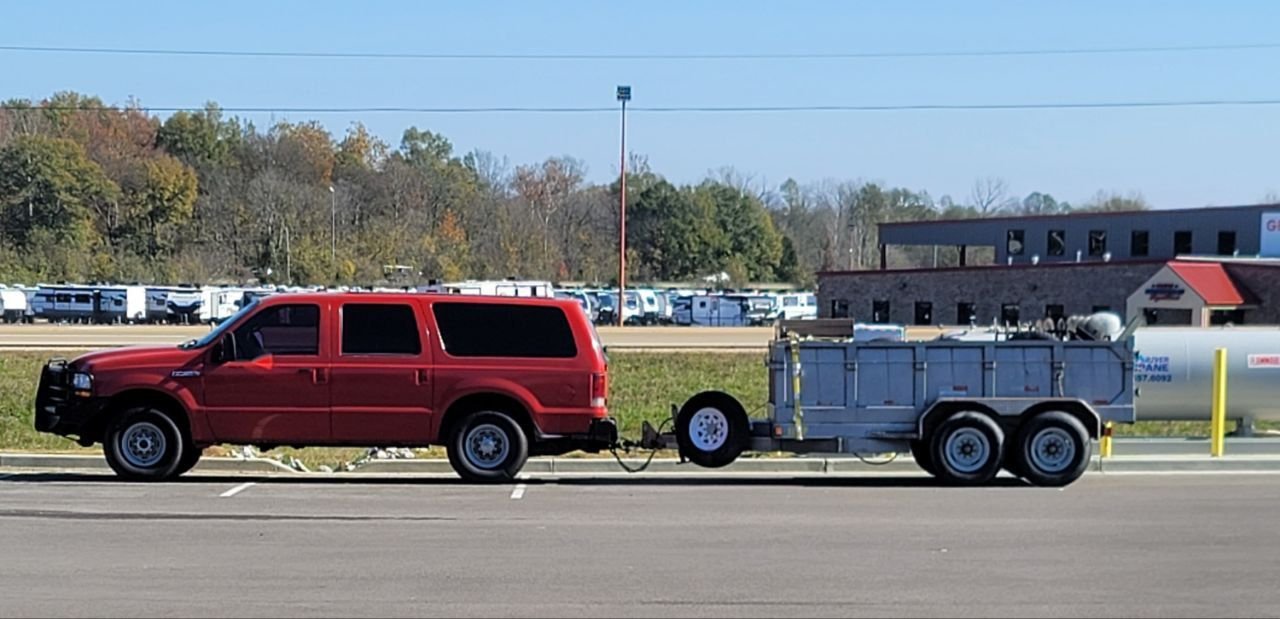

Do you know which gear ratio it has? 3.73 was the standard equipment with 4.30 being the “towing” option for the V-10.
Do your plans for it include any towing? If so what kind of weight and what kind of trailer, open low profile flatbed trailer is much different from a full height enclosed or travel trailer. With the 3.73s you should be good with the slightly larger 285s, which do fill out the wheel wells and look better unless planning to tow fairly heavy. With my old V-10 EX I ran 35”s with 4.88 gears for an effective 4.39 ratio and it did pretty darned good towing our old 12/13K lb TT for over 80K miles, the 6.8 can be a decent towing platform if it’s geared for it.

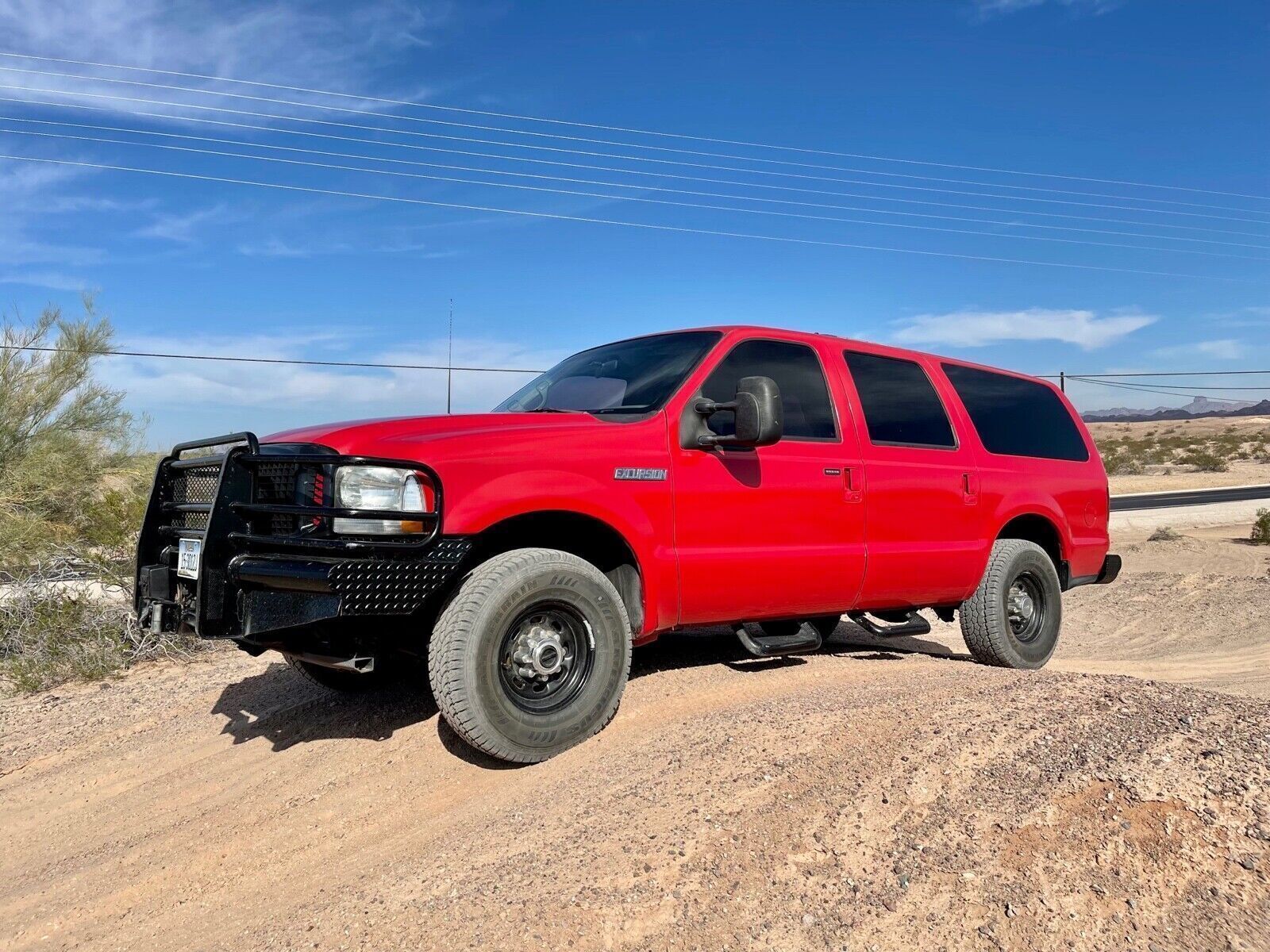

I ran those 35”s on a 4” lift using OEM ‘04 Lariat 18” wheels, which have the correct geometry to properly fit our leaf sprung trucks. I did use a cable tie to pull the plastic front wheelwell liners back at the bottom rear about 3/4” on each side to avoid tire contact there, otherwise they fit perfectly with just a bit of tire to spring rub at full steering lock.
