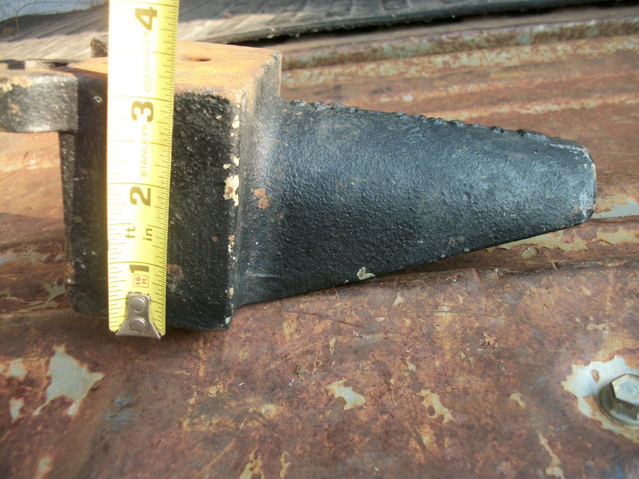

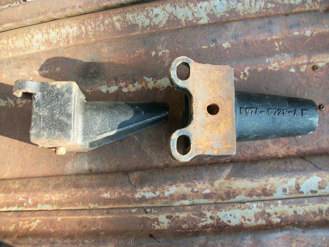

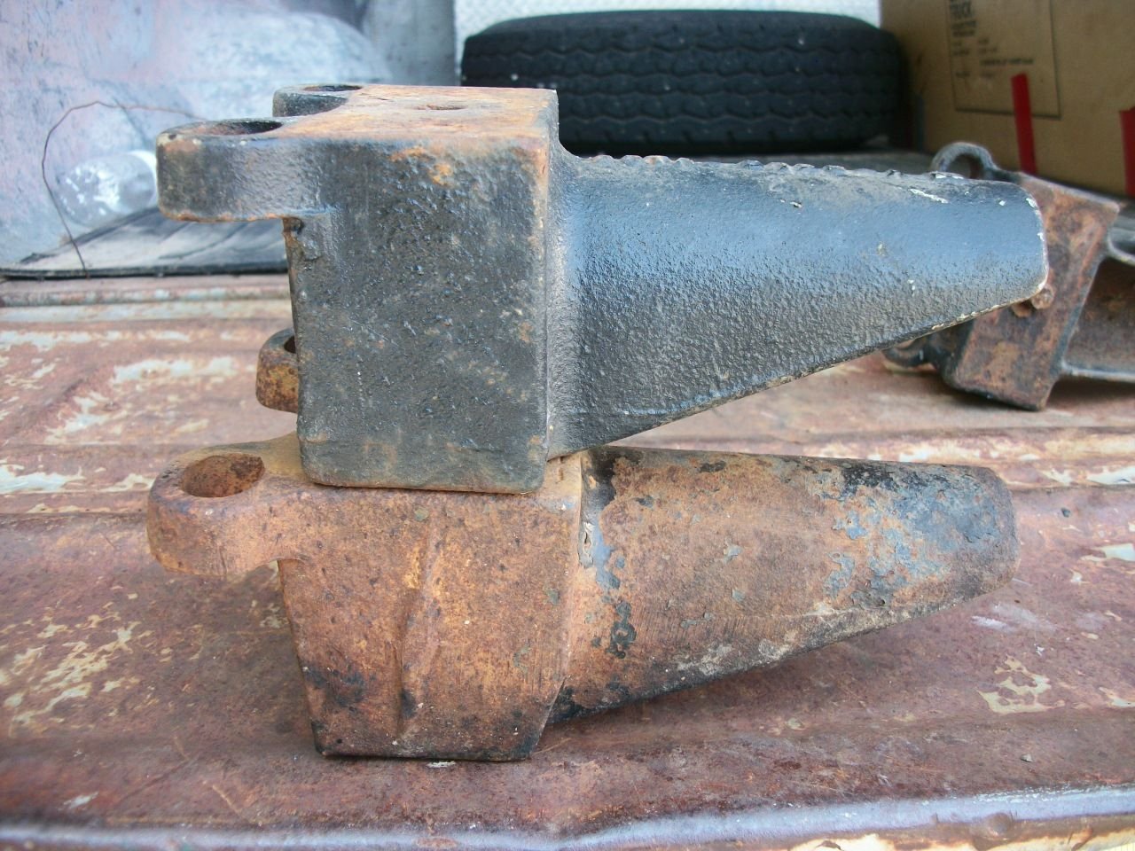

X2 I vote Jeffs, to help with pinion angle. But OEM blocks did not come with any angle to them...so....?
So it seems that at one time I had a set of shorter ones also. No idea what year truck they came off of. But the longer or shorter ones do not have any angle.
This is OEM set up block with a 6" lift springs and a pinion angle shim that came on the leaf.
