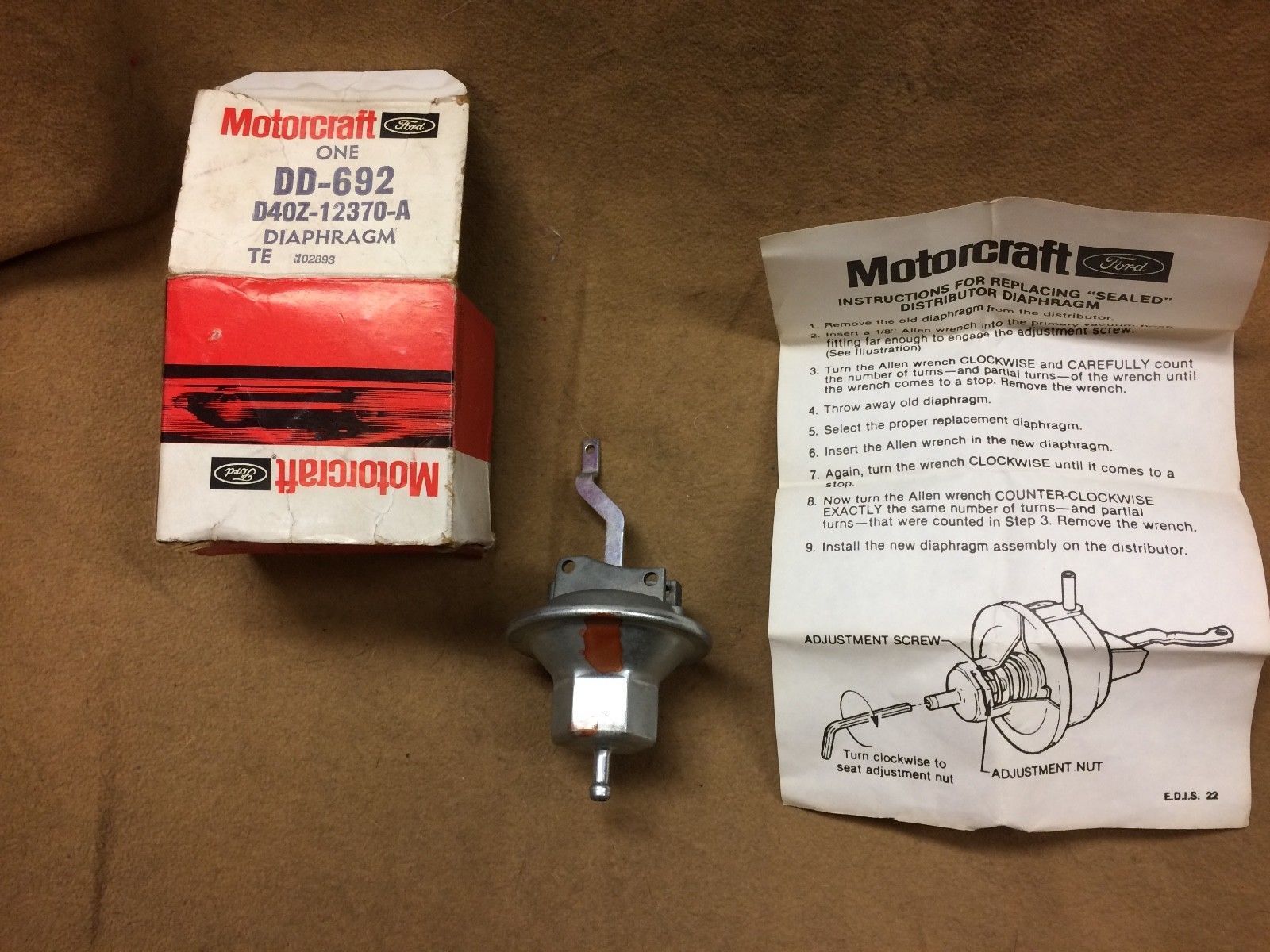

Originally Posted by KULTULZ
Wish I could read the first 2 lines on the paper to know what it says.
Again that adjustment only adds or removes tension on the spring and that will change at what HG (vacuum) the advance will start to move and add advance timing not limit it.
Just numbers: Less sprig it can start at 5 HG more spring it may not start till say 12 HG
You can test this with a hand vacuum pump with a gauge and watch the arm when it moves.
Dave ----

- THE ALLEN WRENCH SIZE ON FORD WAS 1/8in PER INST SHEET -
This period VAC ADV was a one-fit-all as the diaphragms were calibrated to each engine emissions calibration and FORD released this service replacement style to fit most all applications (as was also done with EGR VALVES of the period). There are also aftermarket diaphrams (HP) to control vacuum advance but one would assume the DIST mechanical curve is pre-EGR.
First (IMO), you need to check manifold vacuum with a gauge to see if the engine is running lean due to a possible vacuum leak. A dial-back timing light would also help.
2nd, we need to know how the engine was de-smogged and exactly what was removed.
Seeing as how the DIST was calibrated for EGR and a lean fuel trim, the DIST should be setup on a DIST MACHINE as to pre-1973 curve(s). Even IMCO (1968/ ) can throw the engine off if de-smogged). While I am thinking about it, EGR engines used a timing set to retard DIST IGN timing (initial). You might want to install a pre-1973 timing set. The fuel trim may also be too lean.
The correct setting for the vacuum advance would be done with a manometer at the same time as re curved or it can be adjusted in the field.

For some reason I thought the 1/8 wrench was too big but it has been a bit since I messed with the distributor.

Oh boy. This discussion is getting over my head. I wish I could talk on you guys level. Thx for the posts! I just checked a 1/8" allen wrench and it does seem to fit into an adjusting screw. At first I was using 3/32" and that was the problem. Now I'll start by turning clockwise to tighten the springs which might remedy the Pinging. Am I on the right track? Thanks again

- SEE IF THIS HELPS -
To access the adjustment mechanism on an adjustable canister, you typically insert a small hex wrench or Allen key directly into the vacuum hose inlet port of the canister itself. This tool engages an internal screw that preloads the spring diaphragm. Turning this screw clockwise increases the internal spring tension, which requires a higher manifold vacuum level (more inHg) to begin and complete the advance movement. Conversely, turning the screw counter-clockwise decreases the spring tension, causing the advance to deploy sooner at a lower vacuum level.
SOURCE - https://engineerfix.com/how-to-adjus...e-distributor/
Now you have to adjust it while road testing as the vacuum source has to be under load. You drive it and if it pings, stop and back it off. Reverse turn direction for quicker cut-in.
Get back if any problem(s).
