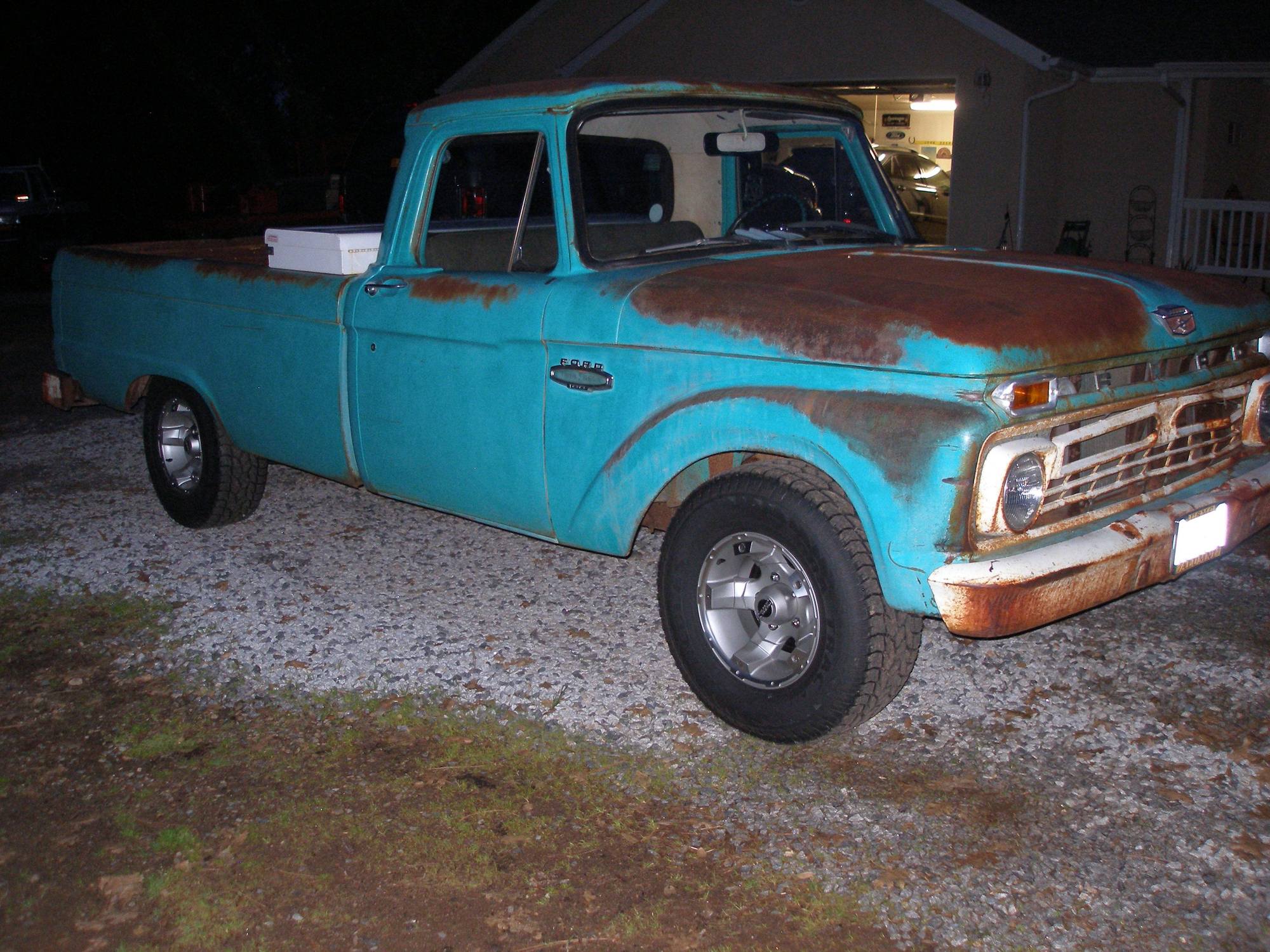

Holy jeebers... if I put half of that in Shrek he should be worth $25k...?!!
ignore the rubber fuel line and filter, was removed after running a while to make sure tank wasn't still running crud into filter
