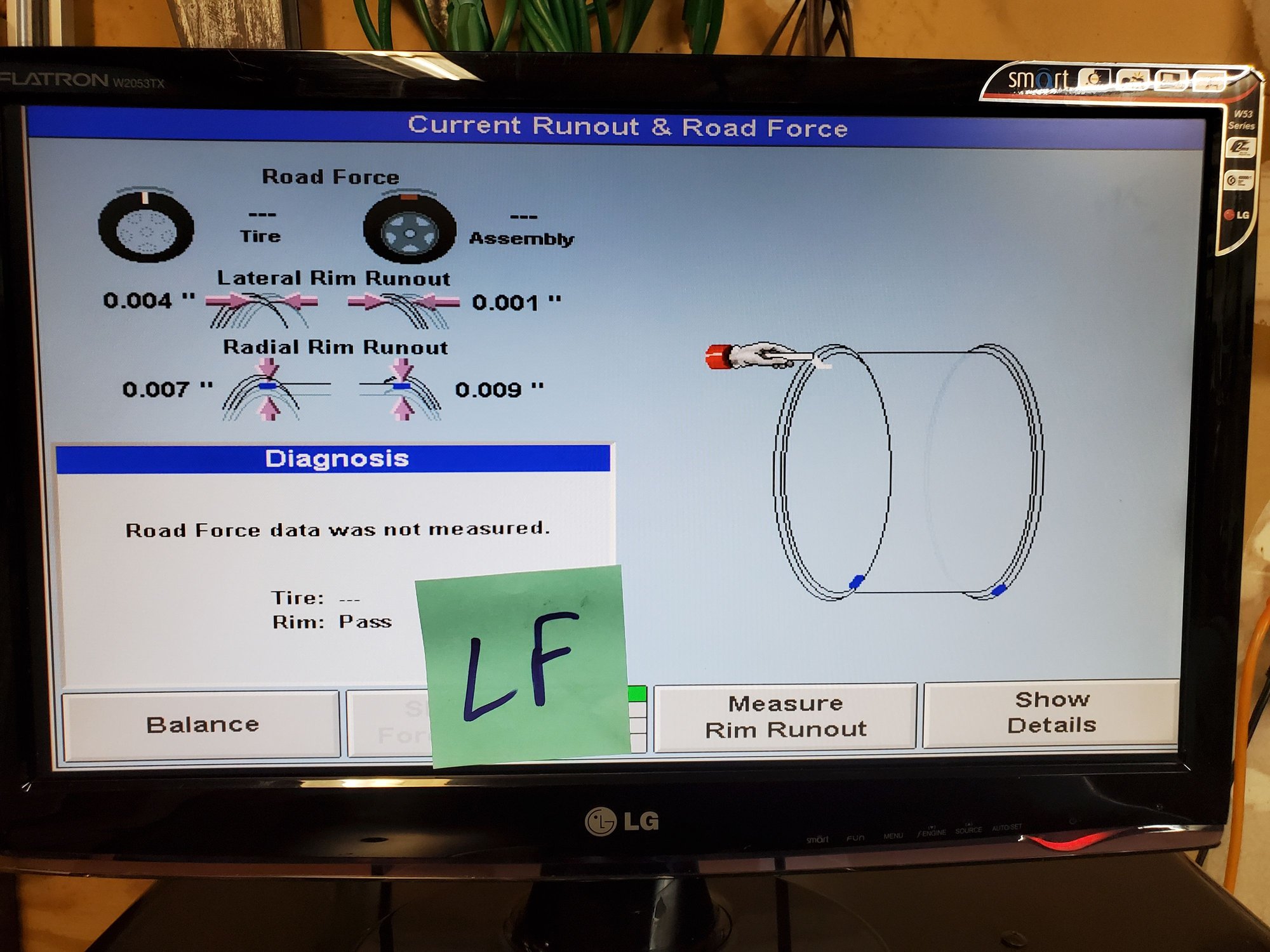

What was the runout on actual bead mounting surface?
Here is a couple of my factory 18" base XLT rims
