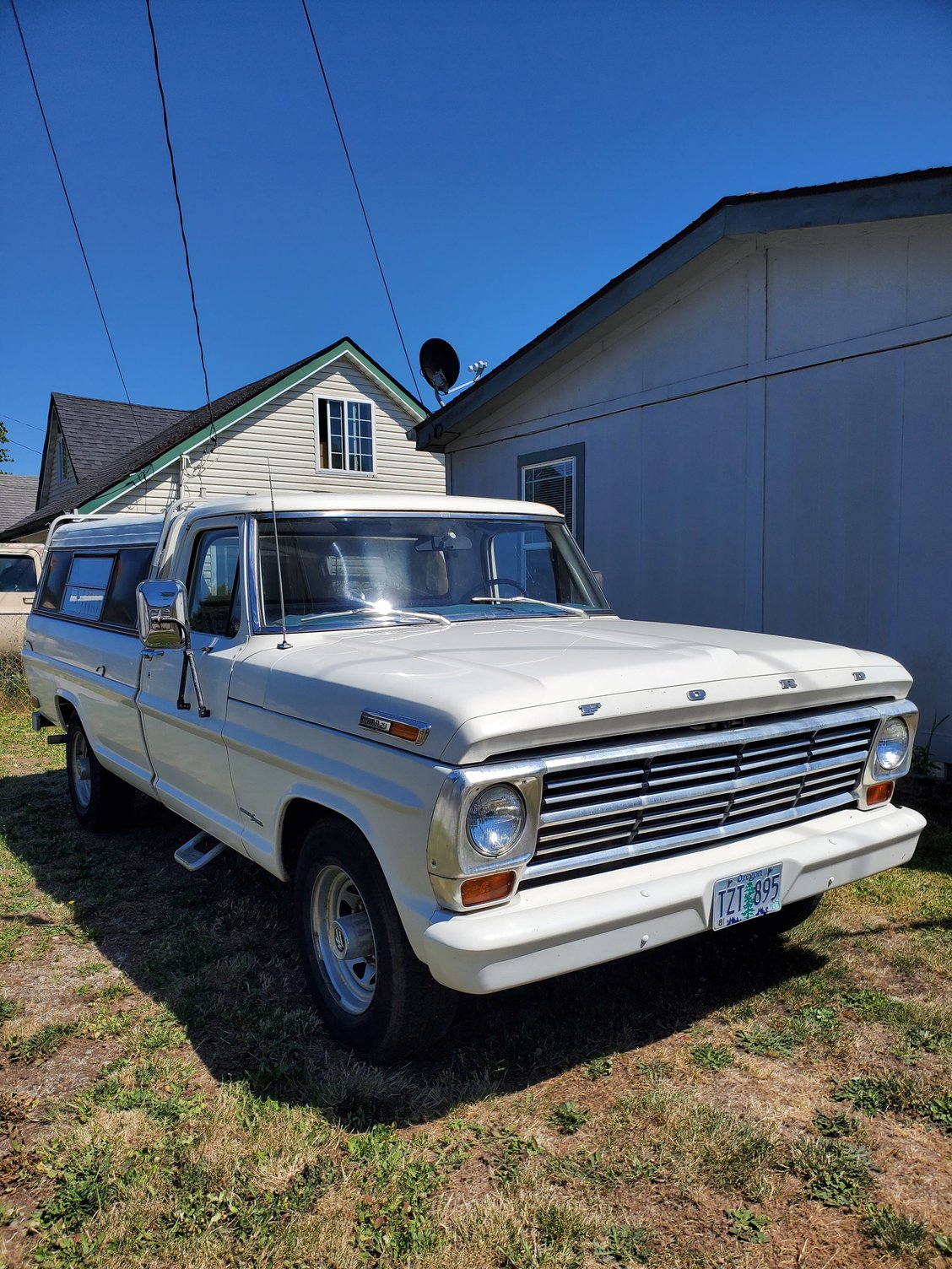

I have a 1968 f250 2wd with a 300 6cyl, automatic c4/c5? long story short version. lol i bought truck from previous owner who owned since 1982. I traded it off to my stepdad and recently got it back.
So, truck had a slight vibration in the motor at certain rpm. Drivable wasn't that bad but you can feel. fast forward my stepdad pulled a empty car trailer with it about 600+ miles and pulled some steep hills near Shasta California. well transmission failed and got rebuilt. and now vibration is worse to the point it well noticeable. I guess my question is? can a new converter require or should be balanced? engine does not knock just a big vibration. I don't want to keep running it if it might end engines life?? could be harmonic dampener Failing?
