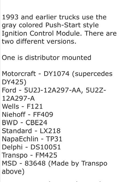

Originally Posted by Fixitagain1990
ICM I used is Motorcraft DY1284, and the fan I referred to is the radiator fan
An old ICM thread shows these as the correct ICM
Is the 1284 correct for your truck?

1284 is the only one part stores list. It’s the Same one I use. Only difference is OP has an AOD and I have manual.
DY1074 has been discontinued and is superseded by DY1284 according to multiple sources.

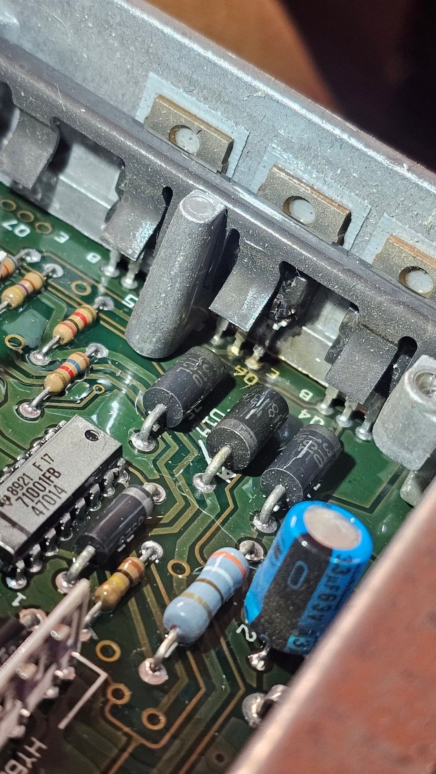

Found either the issue or a further symptom. This lil guy blew up. In all transparency, no idea what this component is, updating here and will look around google after. Small text stamp is 98914 and large text stamp is 5101FG. Circuit board is stamped 06.

It’s a transistor. Wonder why it blew.. if you know how to rebuild that stuff, you can buy them and replace. If you do it yourself, replace the capacitors on the board no matter what!

I've got capacitors on the way, still trying to find an equivalent transistor.. I'll keep you updated!

Replaced the Mofset and caps, reinstalled, and so far so good! No CEL, idles fine. I'm waiting for decent weather before a test drive, just in case the blown mofset was just a symptom of another root issue. Made sure to get spares just in case. As an afterthought, not sure why I held the mofset in place with epoxy instead of tape when soldering. Mofset specs are the closest match I could find, we'll see if it lasts. Part#IRF730PBF-ND

Was it not glued to the heat sink originally? Hopefully it lasts!
