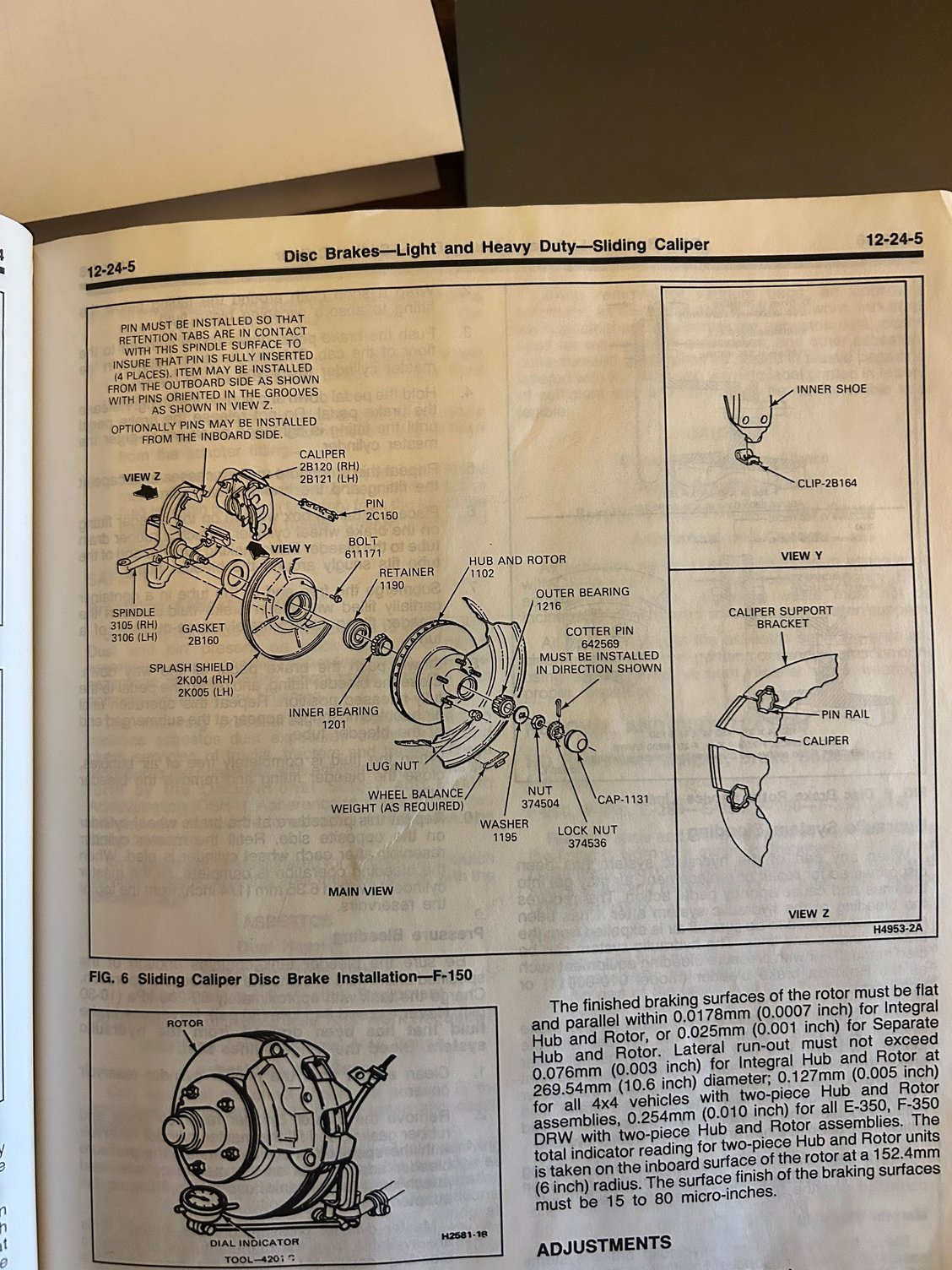

Thanks for sharing those photos with me. My truck has the later 1986 style with those two pins, however there is no spring of either type on my caliper. My calipers match the photo below which I got from my copy of a factory service manual. I have also attached a better photo of the caliper so that y'all can see. I am also contemplating swapping the rotors side for side and seeing if the noise follows to nail down if that is the issue.

From the photo I can’t tell if pin 2C15 is installed as shown in view Z of the shop manual you posted.

Sorry for the confusion, after rereading Franklins post and looking at the diagrams - I now realize that it’s just the 2 pins that locate it. After looking at the other diagram, I though I was missing the spring 2B164, but it appears my calipers are a completely different design than those pictured.
Although It’s not completely visible in the attached photo - both pins are there. I am planning on getting the rotor resurfaced tomorrow or Sunday so I can let yall know if it was a warped rotor causing that sound

The diagram shows the old style and the new style, all in the same diagram. The main diagram shows the two pin style that you have. The small picture in the middle with the leaf spring is labeled "Before 1986".
When you take yours apart, see how tight the pins are. The pins are two pieces of metal with rubber molded to the two pieces. This rubber can get old and not take up the space between the caliper and the caliper bracket like it should, letting the caliper clunk in the bracket. You can buy new pins in the store.
