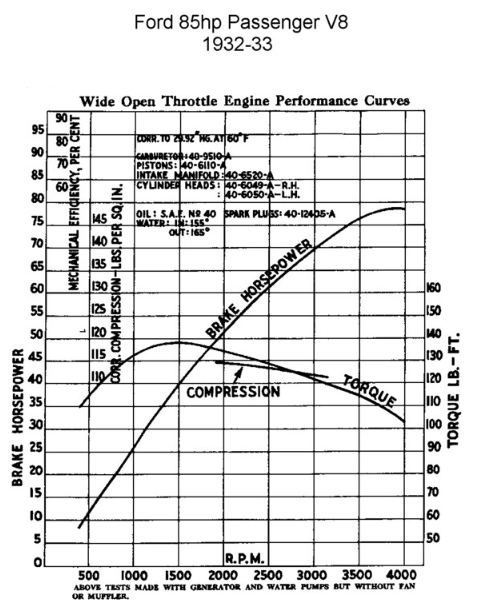

Well said! I have several of the common "bibles", including Ron Halloran's, but they are almost all written from a specific perspective (racing, or a defined range of years). Many of those with in-depth knowledge don't put it down on paper or on the 'net, except when a particular issue comes up.
Art, I'll throw these out for you, you may have already seen them tho.

No, I have not seen them. Thanks for sending them I will enjoy going over them.
