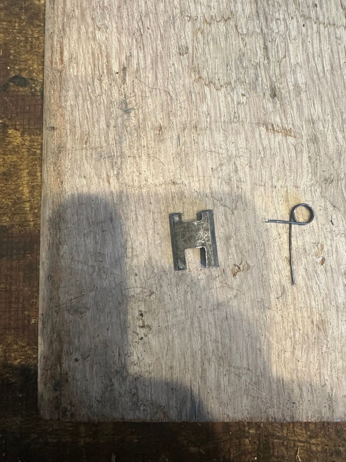

Good day I need to reassemble my parking brake pm my ‘59 F100 and I would like some help with these 2 parts. Thanks in advance

Thanks for this. I need the assembly on the handle for theses two parts which I cannot find in a exploded view

On the tube just below where it bolts to the dash is where the pawl(H shaped piece)fits. The spring puts tension on the pawl to engage the handle as you pull it out. I had to fumble through that a few months back.

Thank you for your note. I am at a loss as how the spring sits with the pawl, is it placeed on one of the four "teeth" to hold it in place or does it just float.
Lastly, if you have a pic of the assembly that would be great, thank you

The spring goes on the top side of the pawl to hold it down so it will w=engage the teeth on the rod. I'll see if I can get a pic soon.

Many thanks for the photo, I see the long end of the spring which rides on the top of the assembly and figured out how to orient it so there was downward pressure on the "cog" Parking brake back in service!
