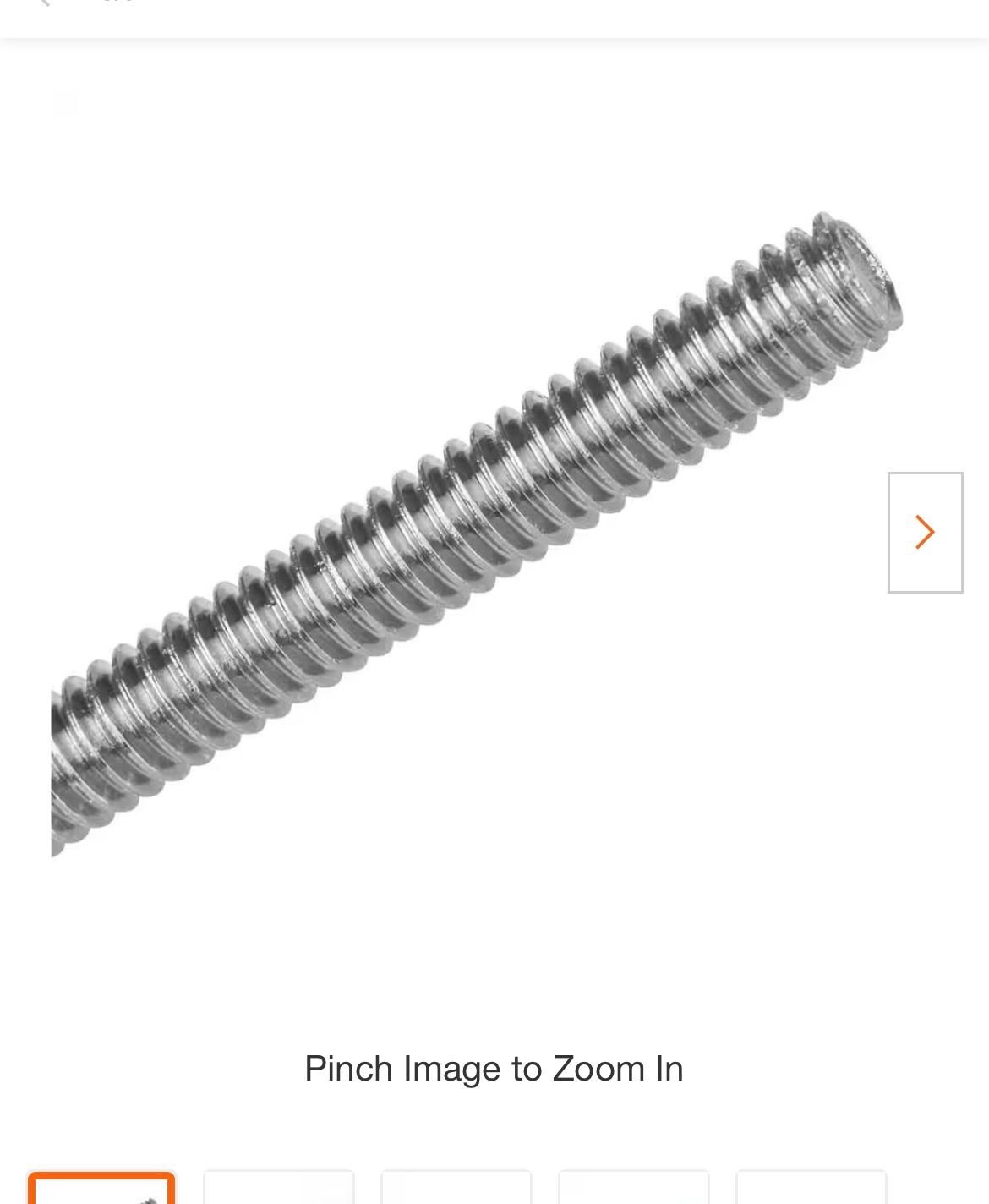

Like I said, no matter what, you’ll need that gasket! Hopefully that’s the only one! Go to a hardware store and buy a foot long section of the picture that’s the same thread pitch of the intake bolts. Cut into 4 pieces and put into the 4 corner holes. You now have an intake alignment tool! Put the rest of the bolts in then remove the 4 pieces to put the remainder bolts. It helps, a lot!
