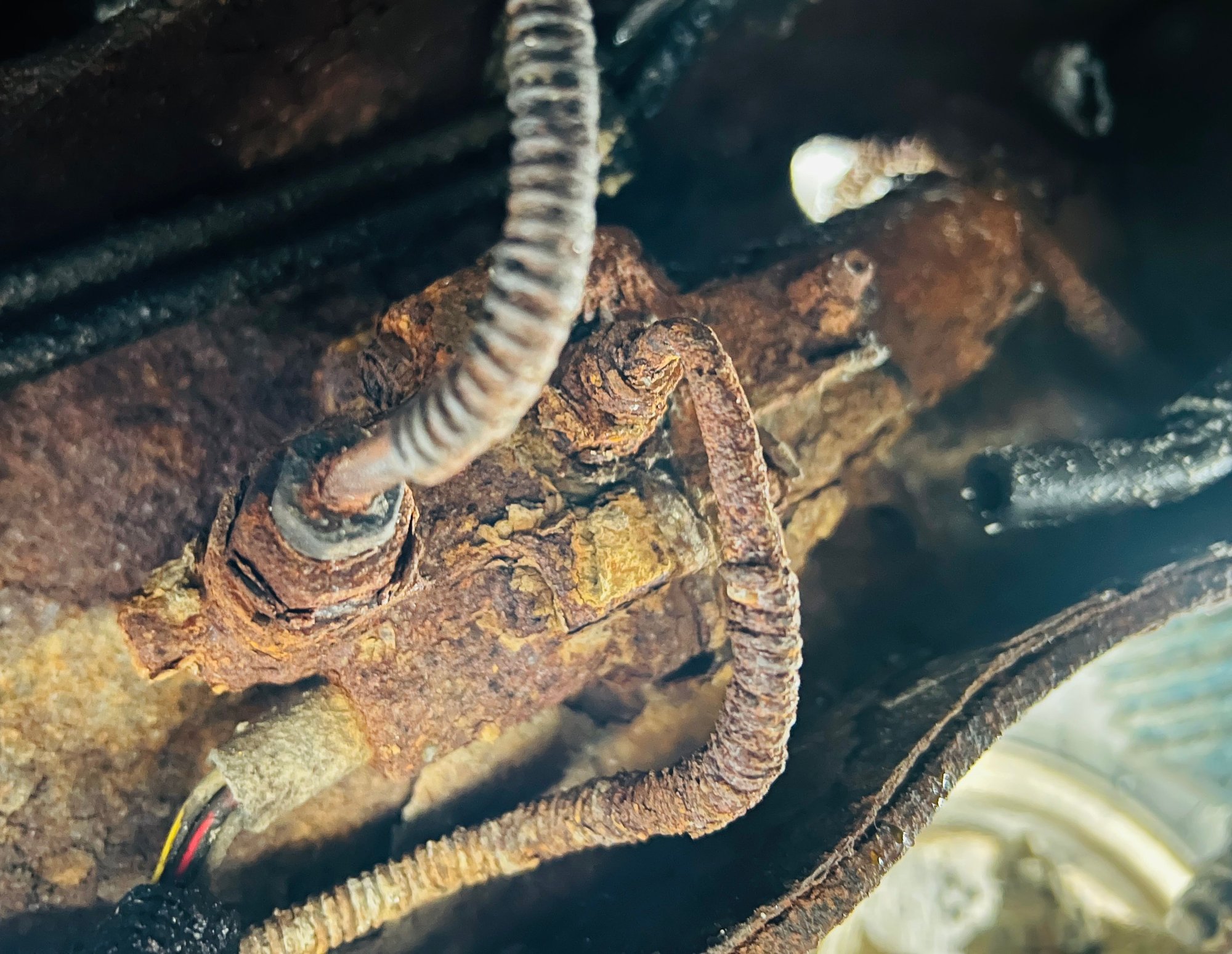

Old Jan 19, 2026 | 03:09 PM
defdes's Avatar
defdes
Joined: Sep 2015
Posts: 393
Likes: 60
From: Vermont
Here’s the mess in question:
Old Jan 20, 2026 | 10:56 AM
knottyrope's Avatar
knottyrope
Joined: Apr 2016
Posts: 7,201
Likes: 1,340
From: Bahstun
that is the RABS valve
Old Jan 20, 2026 | 11:06 AM
defdes's Avatar
defdes
Joined: Sep 2015
Posts: 393
Likes: 60
From: Vermont
Oh I know that, I was just looking for a part number for factory replacement to do when I do the brake lines, most I have seen were generic disc/drum models.
