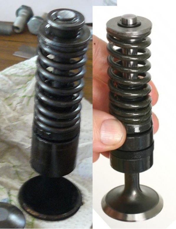

That is a rotator type assembly, which would be correct for an EAB engine (stock).
Rotator on the left, early non-rotator on the right.

I think you nailed it. Looks like my motor is a 1951 EAB motor with non rotating valves. I feel confident now with the springs I need. Thank you, thank you

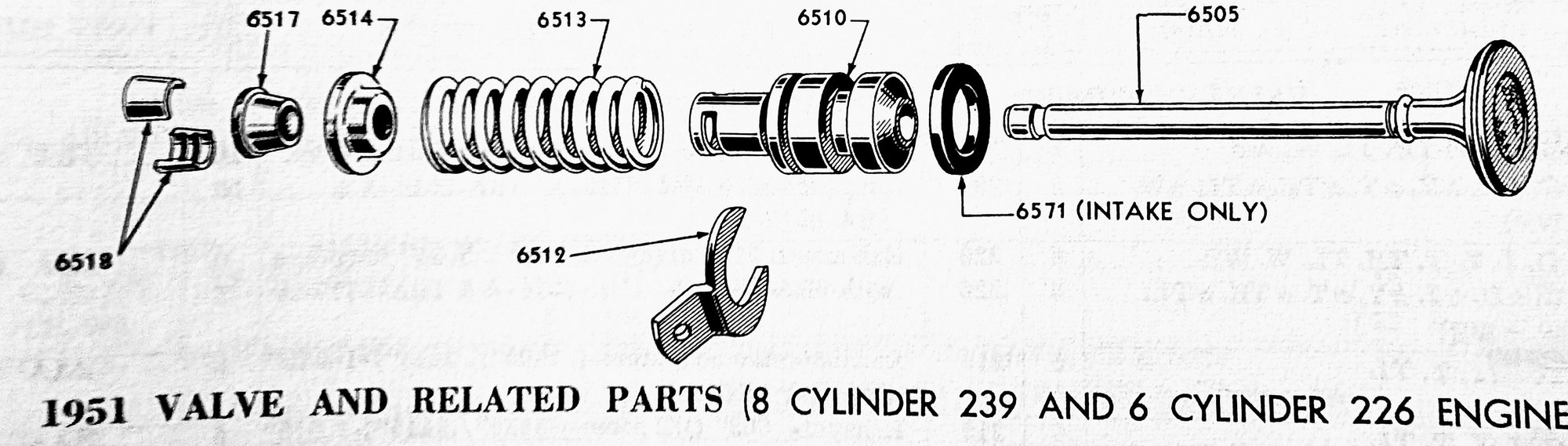

The EAB wasn't introduced until 1952/53.
51 was the introduction of the rotator valve styles which is evident in the keeper mechanism differences.
It is my understanding that your EAB wouldn't have hardened valve seats from the factory. Most elect to have hardened valve seats and related installed at rebuild.

In digging through my stacks of service bulletins, I found more documentation on the valve style changes:
