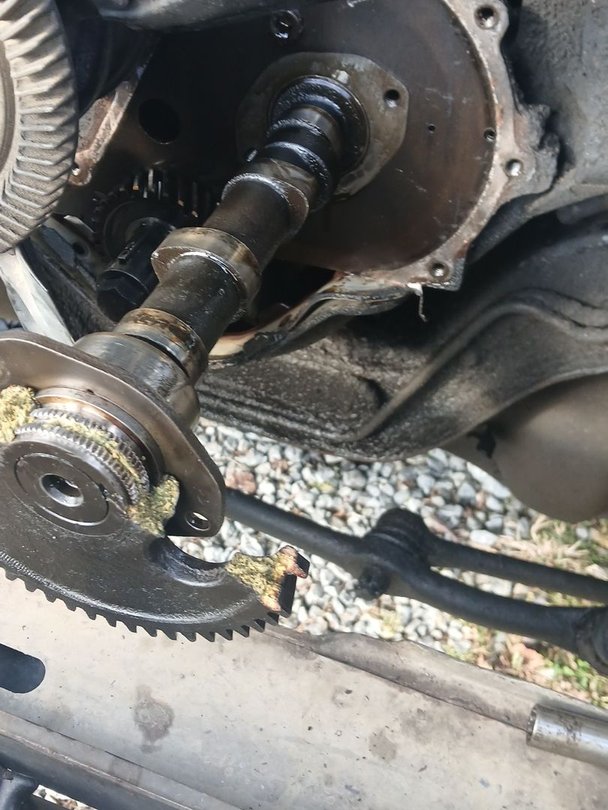

I got the cam out, and in the process the distributor gear nicked the number 1 cam bearing
Old Jan 17, 2026 | 11:42 AM
Grey89F150's Avatar
Grey89F150
Joined: Mar 2025
Posts: 37
I did sort of destroy the cam gear with the puller 😆

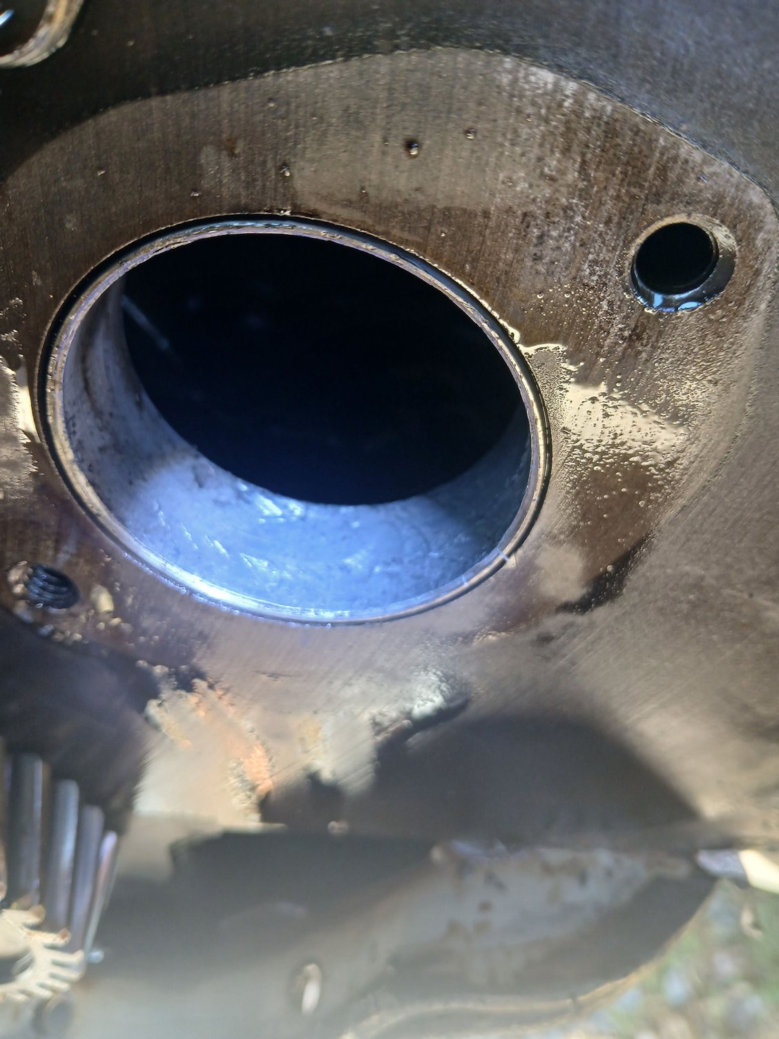

has anyone been crazy enough to replace the cam bearing, very first one with the motor in the truck, all of my other bearings are good.
I did mess up because i didn't support the cam as I pulled it and the distributor gear hit the front cam bearing

Without being there to see feel it but from looks it is not that bad.
I dont see how anyone could R&R a cam and not nick a bearing.
I would take a little Scotch Brite pad and oil and just run it over the nick to knock down any high spots it may have.
DO NOT GO CRAZY! You are ONLY knocking down any high spots not take the nick out of the bearing like you would if doing body work before painting.
Clean the area really good when the high spots are gone and put some oil back on the cam bearing even if the cam will have lube on it.
Now I said you cam gear was pressed off and on and if you try and remove it with a puller it would break as it did
Now how you going to get the new gear back on the new cam? you cant get the cam is with gear on and you cant press it on with the cam in the motor.
DO NOT go hammering on the gear to get it on the cam as you will drive the cam out the back side of the block knocking the cam bearing plug out and then you will be pulling the motor to replace it.
Let us know how you make out and good luck
Dave ----

As a guy who works on industrial machines, this is the right move. I deal with a lot of bronze bushings that act as bearings and they get dinged up a lot when stuff is being changed over. Just grab a small round file to knock the burr down and hit it with a little Emory cloth or scotch brite to smooth it out. A little goes a long way. There's a ton of bearing surface there, so you don't need a perfect surface over the full width over 360°.
