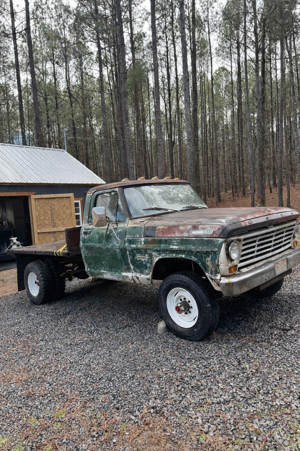

Does anybody think it possible to remove this paint and get closer to the original green? Previous owner used white spray paint over the whole thing and I used aircraft remover and got a lot of it but there is another layer of paint above the green that seems better quality and harder to remove.

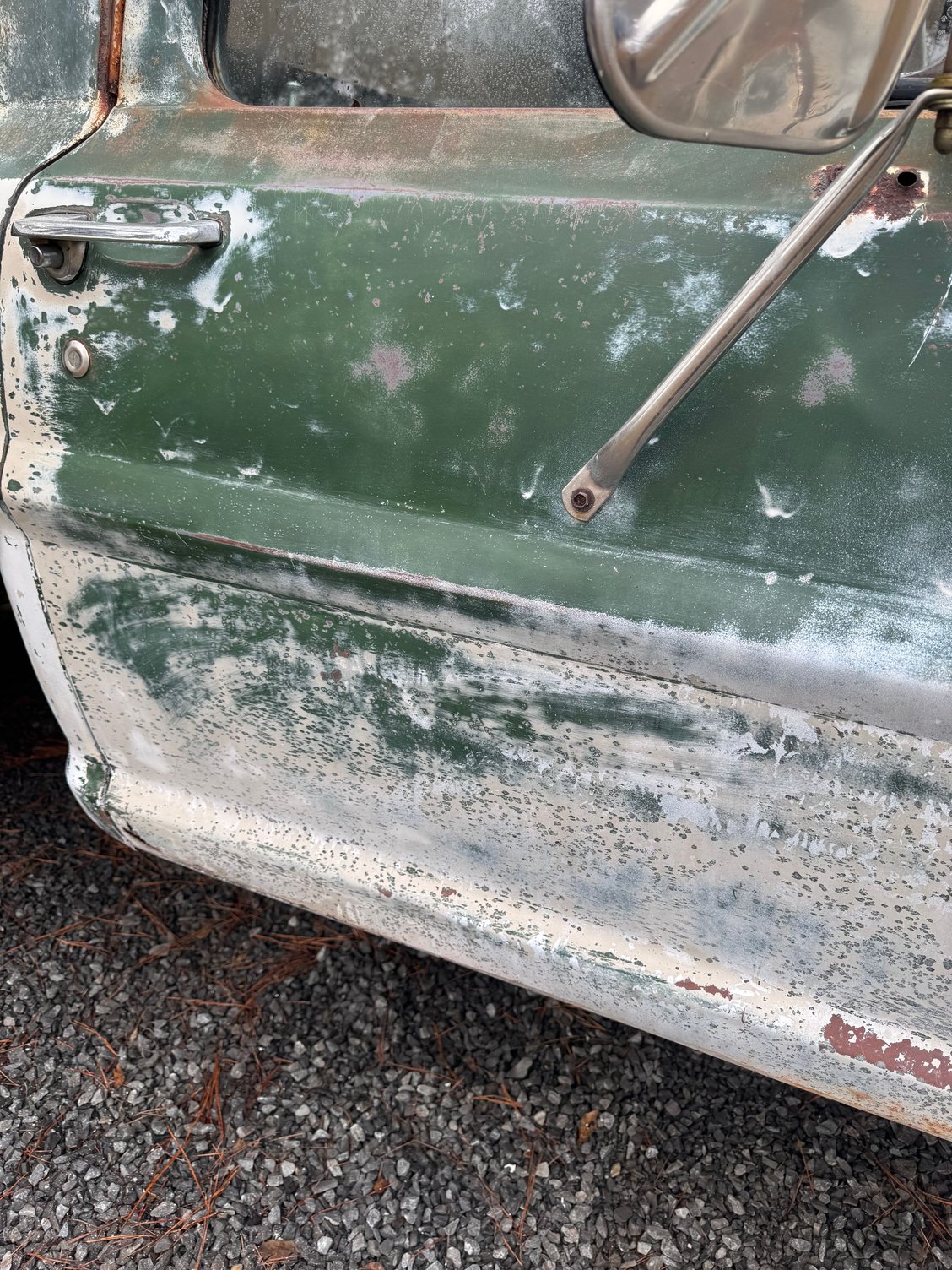

Thank you so much, working very well. I’ll send a picture when I’m done

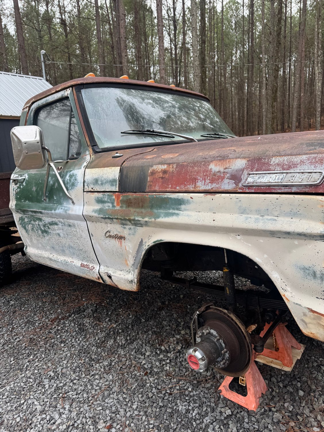

Still got alot of small stuff but there’s the majority
