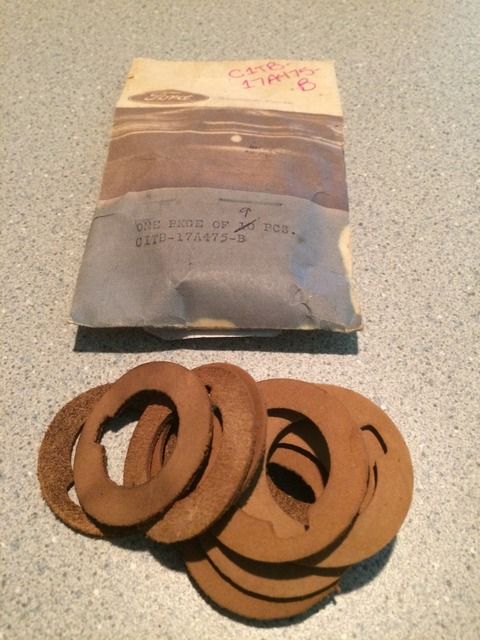

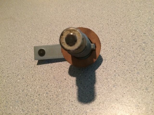

Another place to check is the wiper shafts that stick through the cowl below the windshield. Originally, they put a leather gasket on the shafts before they were installed but that leather piece can disintegrate which can allow water to seep in around one or both shafts.
C1TB-17A475-B - SEAL - WINDSHIELD WIPER PIVOT SHAFT TO COWL TOP

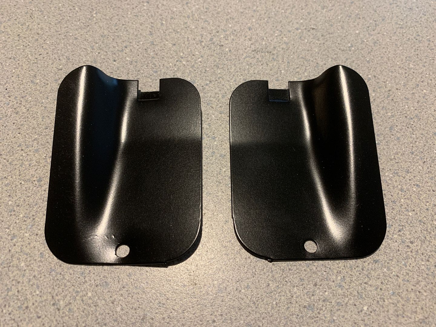

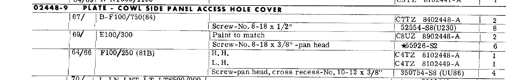

If you do want to pull your fenders sometimes it's easier to pull the front clip as a whole - fenders, inner fenders, grille, core support, etc. - sounds like more work but it is less bolts. Separating the grille from the fenders and lower valance can be tricky in good conditions due to rust, spinning U-nuts and things are pretty cramped in some areas. The four fender bolts that aren't as obvious are the ones under the back lower edge of the fenders on each side and then the special one on each side that you get to from a small opening inside the cab just in front of each door in the kick panel area. See the yellow oval with 02449 - follow the arrow from it and you'll see the area.
The cover plates only apply to 1964-1966 F100/250 2WD Custom Cab (81B) trucks and possibly 1966 F100 4x4 Custom Cab as well. But if there is no cover then you should be able to look into that area and see the bolt head. That one and the one underneath can often spin inside of the clip rather than come out smoothly.
C4TZ-8102448-A - PLATE - COWL SIDE PANEL ACCESS HOLE COVER - R.H.
C4TZ-8102449-A - PLATE - COWL SIDE PANEL ACCESS HOLE COVER - L.H.
