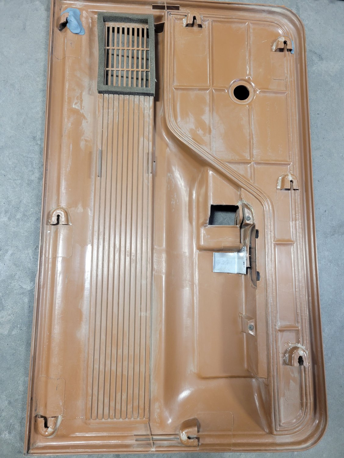

For a while now I've been looking around at diff door panel options. Mine were badly cracked where they always crack, right around the arm rest and where the steel cup sits. I was set on buying a new set from LMC or another supplier, but since it's been raining and I haven't been able to work on the paint/body work, I took another look at my old panels. After some head scratching, I thought I'd give 'fixing' them a go and took some paper for templates and some scrap sheet metal, and jumped in to making some braces/patches. I cut out the templates, traced them onto the s. metal, bent them forever, sanded the patch areas with 36 grit, drilled some holes in the metal patches for epoxy to seep through for strength, wiped the areas down with lacquer thinner, and mixed two tubes of JB weld.
I don't know if this will add any strength to the panels, but having done this made me feel better about using 50+ year old panels on the truck once more.
Cracked here,
Cracked here,
and cracked here as well.
This brace and the other one that has the armrest screw hole in it will be the strongest.
Loads of good ol' JB Weld. Slobber it up!
I used a full tube of JB Weld, along with about 2/3 of a tube of the hardener.

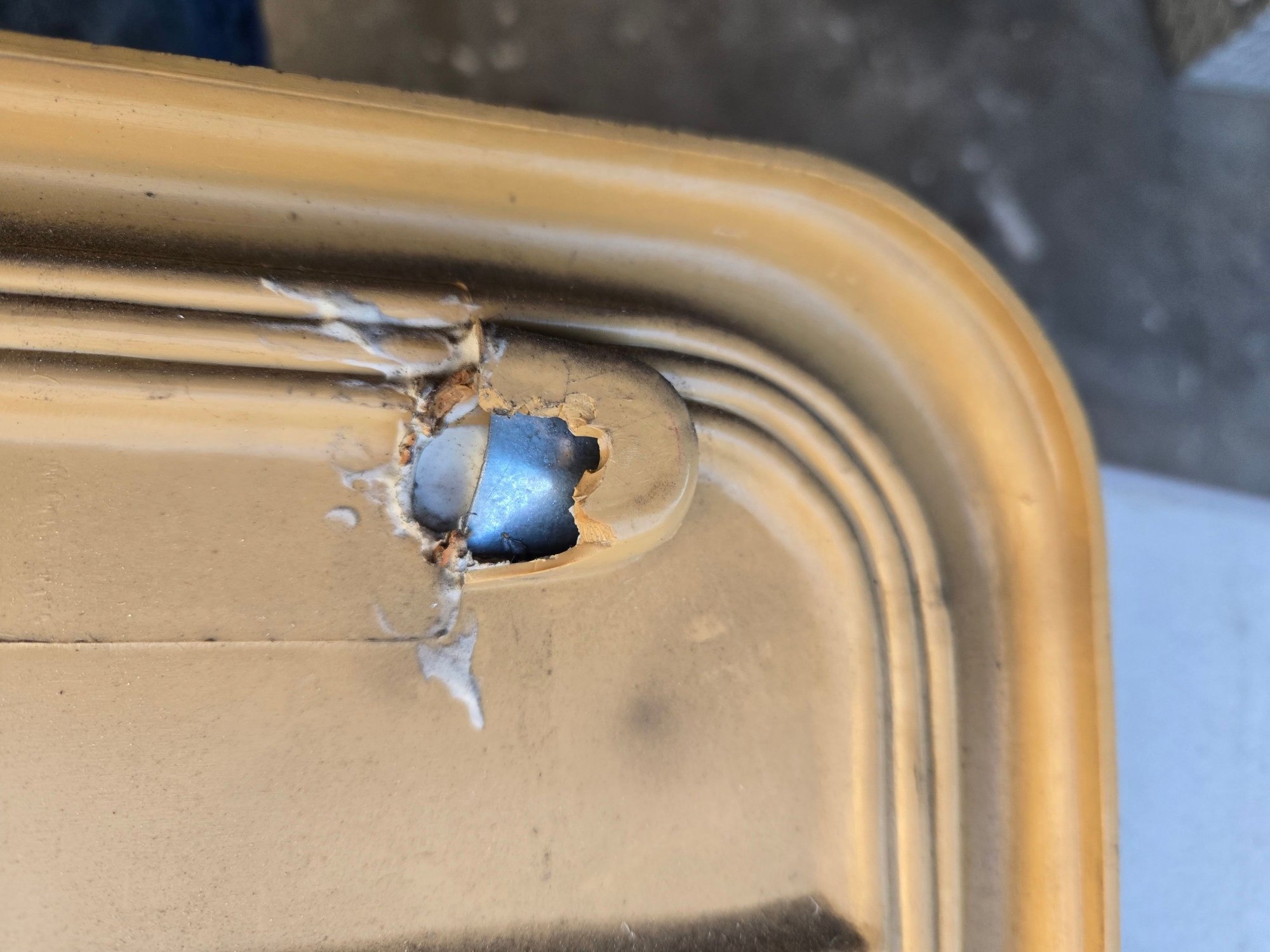

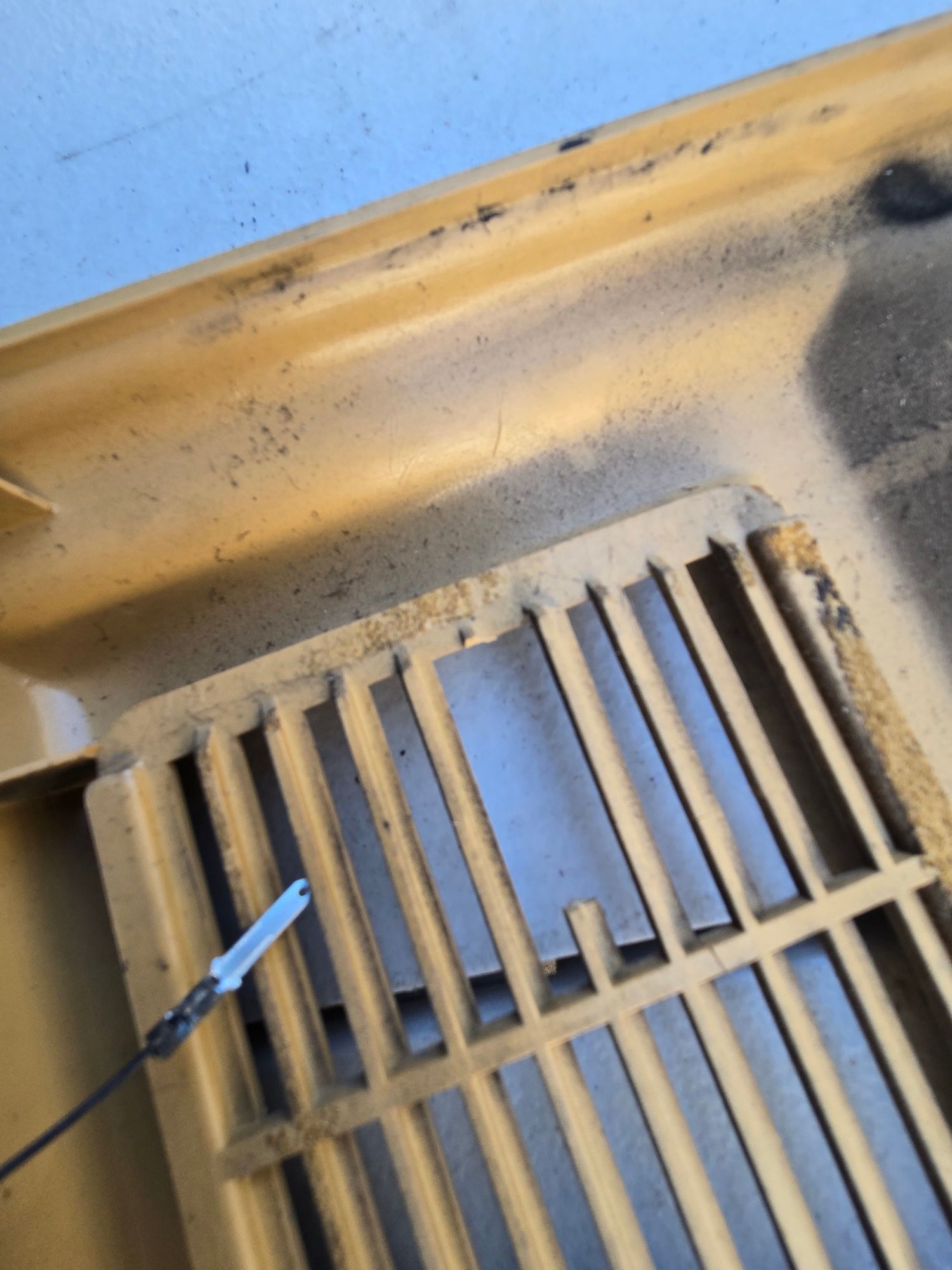

Hey tbear. Well, note to self: Always ck both panels before deciding to repair. Ouch. The second panel is in worse shape than the first. Had I seen and evaluated it before doing the first, I'm not sure I would have repaired the first.
I have the missing pieces.
Looks like my dog got hungry. I have this missing piece too.
I think the guy who installed my stereo and speakers really did a job on this panel. Note the crack through his epoxy.
I have this missing piece as well.
I used super glue to 'tack' the pieces into place. Tomorrow I'll make steel plates to reinforce the breaks, drill some ooze holes in them, and imped them in epoxy. Hopefully it will hold. I too have steel finger cups, but at some time I think the truck may have had plastic cups that cracked/broke and cause extensive damage. You know, during the work I found the FORD stamp on the underside metal of one of the arm rests. It made me happy to be using oem parts.

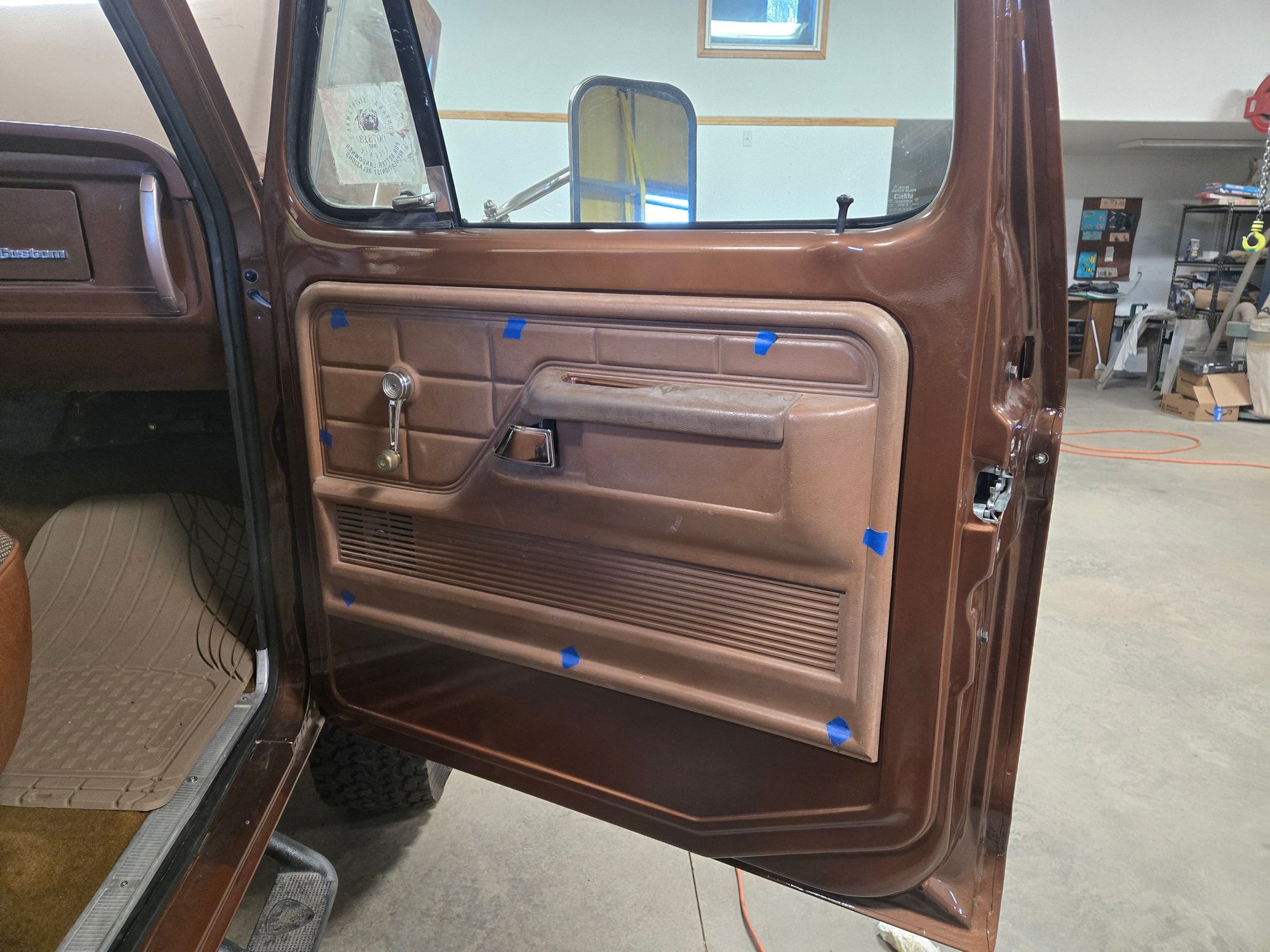

[img alt="I marked my push pins locations with tape, so I didnt push anywhere but directly on the pins.
Rich has some nice posts about which ones worked best. "]https://cimg7.ibsrv.net/gimg/www.ford-trucks.com-vbulletin/2000x1504/20260102_121947_281eee3edc274823083d0b49682944fb5c 83d64c.jpg[/img]
I marked my push pins locations with tape, so I didnt push anywhere but directly on the pins. Rich has some nice posts about which ones worked best.
I found these ones to work well.

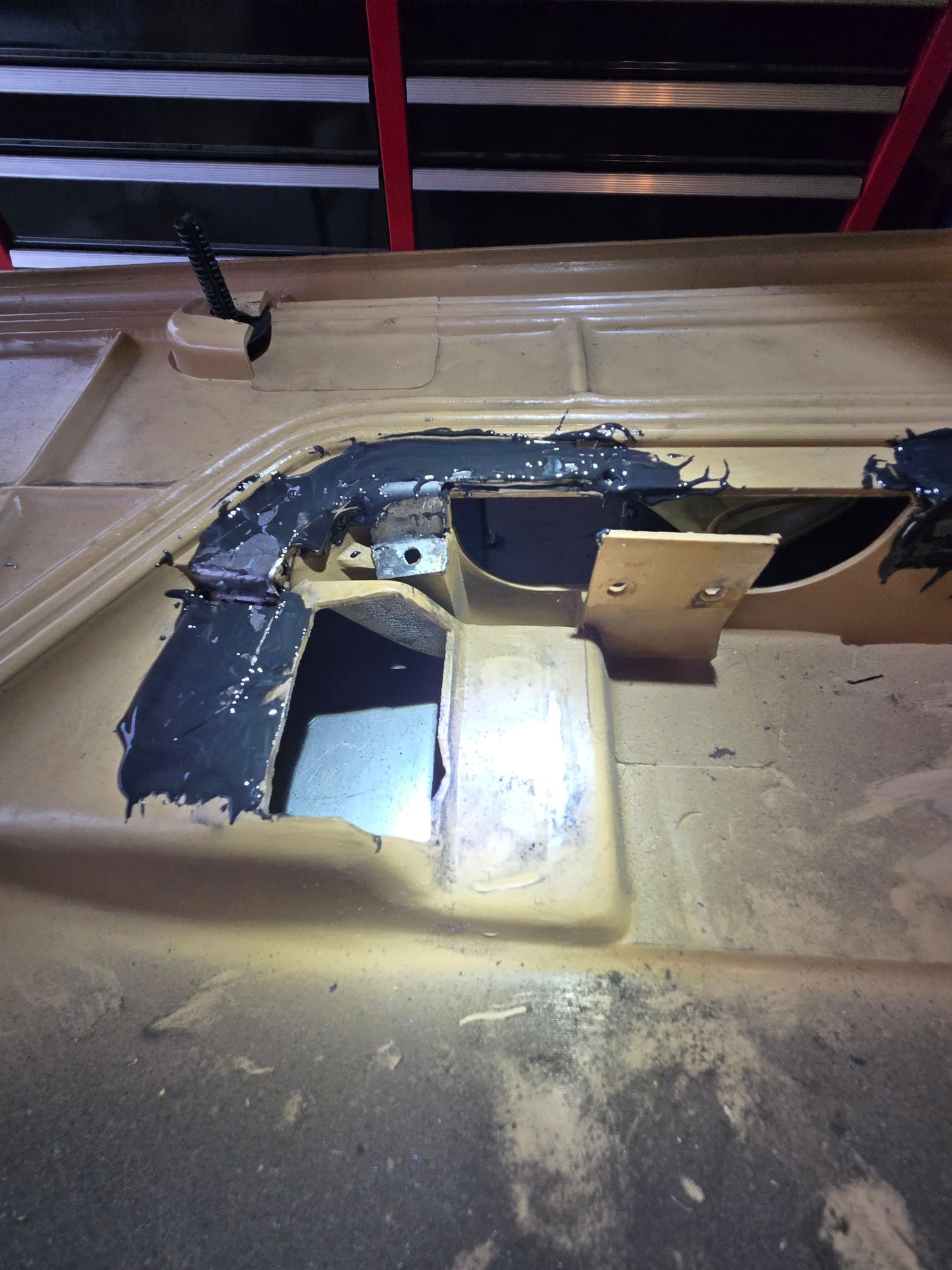

Hey nutter3, thanks for all the info and what looks to be great fasteners. At this point I'm not sure how to proceed. I may patch this panel. Once it is hung, you can't see the cracks, and I think I can get a few more years out of it.
I checked on LMC and Jeff's Bronco graveyard. Both have new sets for about $200, but with tx and shipping the cost climbs to near $300!
Or, I may order a set of $129 cheapo's —no shipping—from amazon. That would mean having to either do without, swap over, or buy new tweeters for the new panels.
Later on: I cut the metal and applied JB weld, after sanding and cleaning with laquer thinner.
Spread with epoxy, stuck in metal, spread over metal with epoxy. Once mounted, itll look brand new, nearly.
Spread with epoxy, stuck in metal, spread over metal with epoxy. Once mounted, it'll look brand new, nearly.
I didn't think I needed to brace the panel where the two screws for the finger cup go through because they screw into a metal brace on the door.
