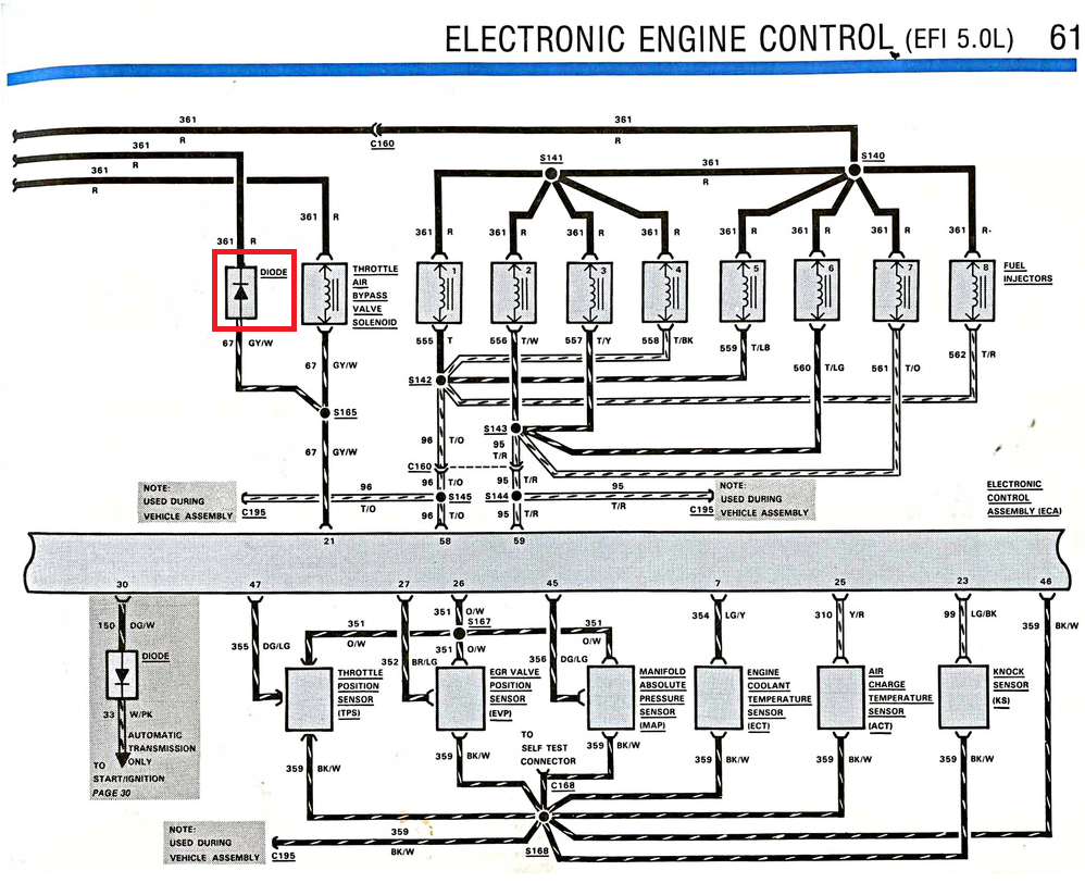

0n my 1986 F150 5.0 anyone know what this “ thing” is near the distributor?

It's the IAC (Idle air control) diode.
The IAC is controlled by the ECM grounding the IAC solenoid in a "duty cycle" The valve in the IAC "floats" toward open and closed many times per second. Each time the cycle ground opens, the diode allows the voltage spike to be reabsorbed into the power circuit.
Edit. The newer IACs have the diode built in. So, I think '85-86 are the only years that have externally mounted diodes. The newer ones have a small triangle embossed on the solenoid. Fun Fact: the triangle is actually a "Delta", or D for diode.

Good call! The diode is shown near the upper left corner at page 61 here:
https://www.garysgaragemahal.com/1986-evtm.html

The spikes from the IAC would eventually ruin the computer. You can check it easily enough. If you put your ohmmeter on it, it should read low ohms one way, high ohms the other. It's just a electrical check valve. You do have to install it correctly or will mess things up.

To test the diode, disconnect battery and unplug the IAC. You can now check the diode by probing the IAC connecter. You will get continuity one way and no continuity the other. Current flow direction is embossed on the diode. I recommend back probing the connector to avoid the possibility of damage.
EDIT: To make back probing easy pull the silicone seal out of your way.
