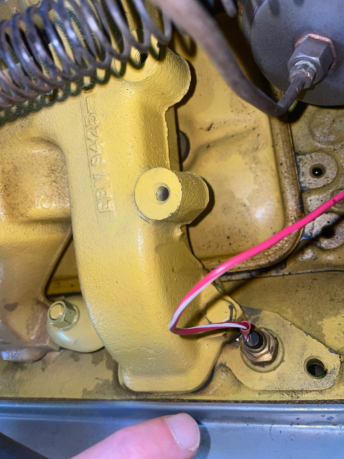

I don’t have a lot of room and the it looks like the pan is a little different. I’ll have to see what they have say.

Before we go any further, the SERVICE REPLACEMENT COVER for 1954/55 was a 1956 SERVICE PART which may make your cover unique. Might want to save it for someone that wants a dedicated restoration.
The 55/57 BIRD cover (B7S 6519-A) was also used on the 1958-59 FYB PASS CAR engines.
With that protrusion on the intake, you most likely will have to use the adapter as it will (should) offset that boss.
Do you want the modification to be somewhat hidden to maintain original appearance or do you mind the alteration as being seen?

Do you see how the adapter gets around the fitting on this ILL or the mounting boss on your present manifold (if needed at all)? You may or may not need the adapter.
Or you can use a valve with an elbow -
Another consideration is how tall of a CARB SPACER to use that will allow you to add a manifold vacuum source fitting (final ACL HGT).
I also understand your wanting to keep the cyl. block ROAD DRAFT for correct appearance. But it has to be remounted using a complete block-off plate (shim stock) and gaskets.

I have found the carb risers on line and the guy I initially talked to at CASCO said they may be able to machine one for me. They make them for the T-Birds but my truck has a 94 Holley 2 barrel which is a different foot print.
I’m currently using the only intake manifold for the brake booster I added so I will need the carb riser to make it work.
I haven’t decided on the draft tube yet because I would have to cut off the tube that drains the oil back to the crank case. So the jury is still out on that.
