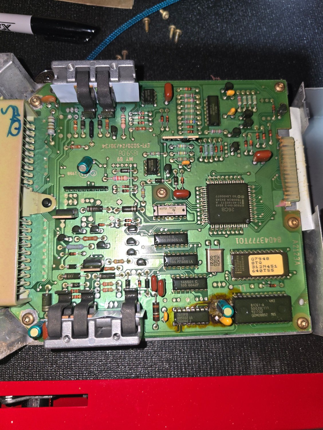

Well all the grounds are good, pulled the computer to find a leaky capacitor. Gonna throw a computer at it now and see what that does for the truck, I'll update this again when I get the replacement computer installed. Keeping my fingers crossed that ends up being my solution..

That’s been leaking for a minute! Hopefully it will solve the problem, can’t hurt!

New computer is installed. Reman unit from Crock-auto. Cracked it open and the "Reman" is just the replacement of the bad caps.. The rest of the computer is identical to my factory unit. Thinking about keeping it and eating the core charge to swap the caps out myself and then maintain the original unit. Dunno yet.

Thats rough. Your making good progress though. Learning more about the rig. The reman could've been fine before you installed it and it could be getting to much voltage over feeding the computer making that capacitor explode or it was an older reman and it was weak. You might need to do a power check at all points on the computer test if anything is getting over fed or under fed leading to wiring or charging system. I've never had issues so far because I haven't driven my 90 enough to get an issue like this.

Board with the black cap is a tested good "Reman" unit before I installed it. Board in my December postings is the "bad" unit with the original blown capacitors. The new computer did fix the issue I had where I wasn't getting any codes back and it wasn't logging any. I'm very hesitant to think it's a bad computer considering how much better the truck feels running and driving before it high idles.

That replacement cap area looks suspect. I would ohm it to make sure it’s good. Inspect the entire board!
