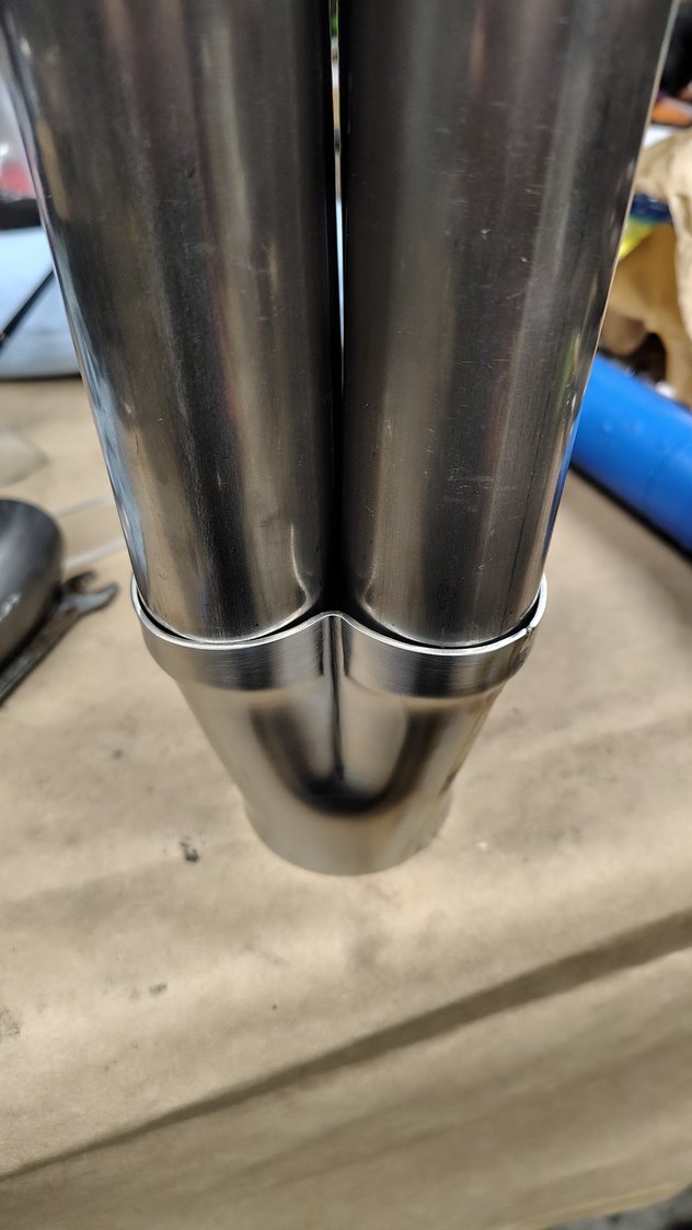

I am building a set of long tube headers for my 408w and I purchased all the stuff from Stainless Headers. Is it normal to have the collectors this large? The 4 tubes go into the collector about .5". Do you just trim the collector to fit?
I do have an email out to Stainless Headers to see what they say.

Well, I did not expect a 5 minute response from them, but they say they are larger to allow wiggle room for the build.
I hope this may help some other fool that goes down this rabbit hole.

I think their response is BS. I've built a few race car headers and the collectors I bought all were a nice tight slip fit. I agree the easiest "fix" would be to trim the collector down to where they match. I've gotten good advice and bought supplies from Headers by ED: Welcome to the Home Page of HEADERS BY "ED", INC. May you learn a lot as you go through our website!

They stated that since some builds the tube lengths are not all the exact length and therefore with the larger opening, it allows you to modify accordingly. I guess making one larger is better than making it smaller. I will probably trim it down a few inches when I get there. I'm not looking forward to cutting that in my band saw.
This is not a slip fit collector, but I'm certain you knew that.

I edited my response. Exactly equal length primary tubes are hard to achieve and only really needed for the last bit of HP in a race motor. I would trim the collector to where it matches the pipes. Also, its hard to explain - but heat and mash (form) the pipe ends into a "cross" and weld 'em up so they flow better into the collector.

Great link. I will spend some time on that site later this evening.
I did find my other collectors and they fit perfectly. Certainly better than the ones I got at Stainless Headers. I guess if you were a pro at this, you probably want something you can modify to fit your build. I am not building a race engine, just something to tow my 5th wheel. I wanted some long tube headers since my Gibson shorties are well over 20 year old and they have done a fairly good job. I could not find a long tube header that would match my desires or wallet. If I am going to spend $1,500, I might as well learn a new skill and design something that I can work around.

Much better fit! I'd send the loose one(s) back. TIG welding? I'm pretty good with MIG but I've only dabbled with TIG once or twice. I'd like to get a cheap(er) one and try to get good for delicate or alum/stainless projects.

I looked at that website and the collector transition is less with the ones that fit better. They indicate that it effects flow. I am certain it does, but for my purpose and skills, it will be fine.

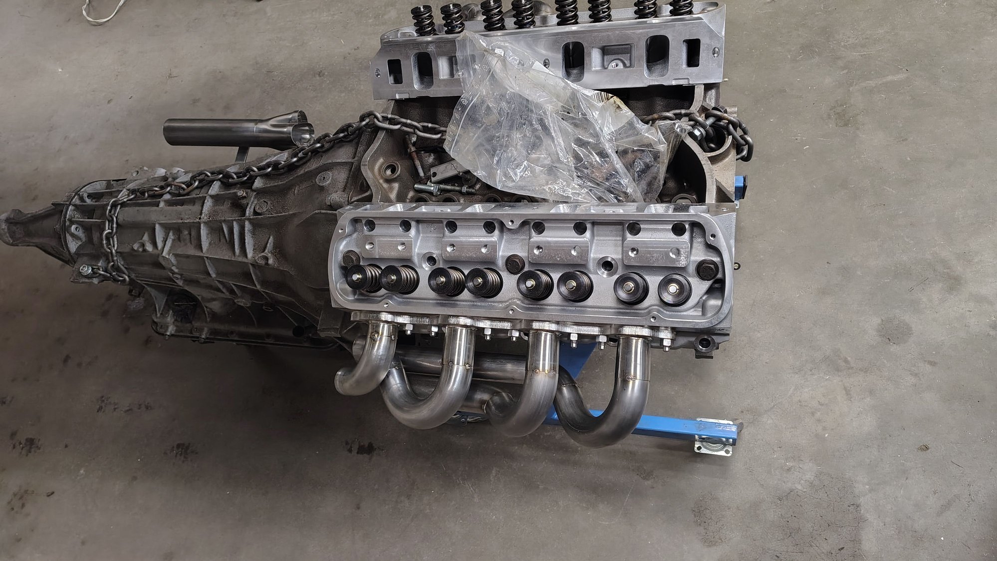

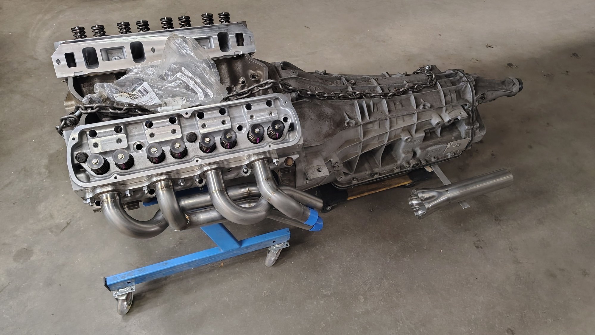

Old Jan 1, 2026 | 10:04 AM
1Butcher's Avatar
1Butcher
Joined: Mar 2007
Posts: 2,840
Likes: 1,033
This is where I ended for the week. I have some 4" CLR bends coming and after looking at what I got, I might just get a couple 3" CLR bends too.
The tubes are tacked and my first tack sucked. Oh well, I should be able to fix it and with a grinder, nobody will know.
