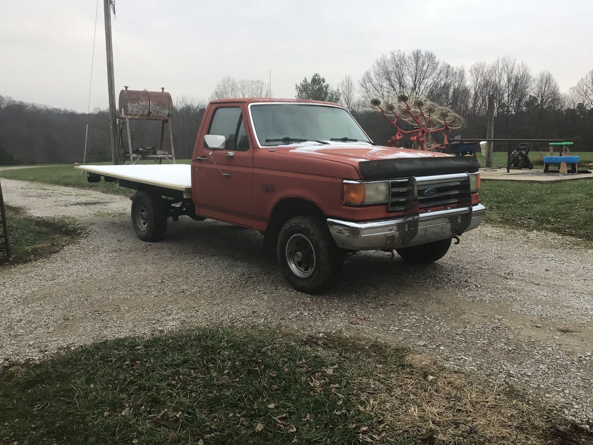

New member here. Looking for some help from those more knowledgeable than I.
Up front, I am very mechanically inclined and work on all of my own stuff. Trucks, tractors, farm equipment etc. But I am more of a diesel guy, and me and gas engines never seem to get along.
I've picked up a 1989 F-150. It has the 302 engine with a 4-Speed.
This truck came from a family member who has used it as a beater to get back and forth to work in for the last 15 years, and was truly treated as a beater. It was parked 5ish years ago and has sat until a year ago. Fired up ok and I got it home. Learned that the frame was shot from the cab back, so I replaced everything. Chopped the frame just behind the cab and put in 7" C channel, replaced the leaf springs, hangers, shackles, shocks and mounts. Feel much better about it structurally now.
Pulled the bed off and will be finishing out a wooden flatbed.
New in-tank fuel pumps while everything was off, and a new rear tank. Front tank was in decent shape, so I cleaned it and am reusing.
Since I've had the truck, I've had a weird issue once it warms up. It starts great if the engine is dead cold. Once it gets warm it really struggles to idle and wants to die. If it dies or if you shut it off, the truck will not start again until everything is dead cold. It has to sit for at least 24 hours.
Now, it seems that issue is creeping to become more present. Truck will only start 20% of the time. Cranks great, and sounds like one cylinder wants to fire. But will never light off.
Fuel pressure seems to hold steady at 35-40 psi.
Everything on the ignition side has been replaced other than the ignition control module. Not sure how much that has to play here, and I also have done some reading about capacitors in the ECU.
My test light on the engine side of the ignition coil shows a weak light, but maybe a test light isn't the right tool to test after the voltage is bumped up. If I put my multimeter on it, what should voltage be?
It also doesn't have a single solid vacuum line. That's on the list, but I feel like the truck should at least start without the lines?
Looking for some guidance and if this issue is more common than I think.
I intend this truck to be a farm truck. Run from field to field, to town and back, get fuel etc. so I'm not worried about everything being prim and proper. I just want something that's reliable, will start every time I hit the key, and cheaper to maintain than my 3/4 ton 24V Cummins.
